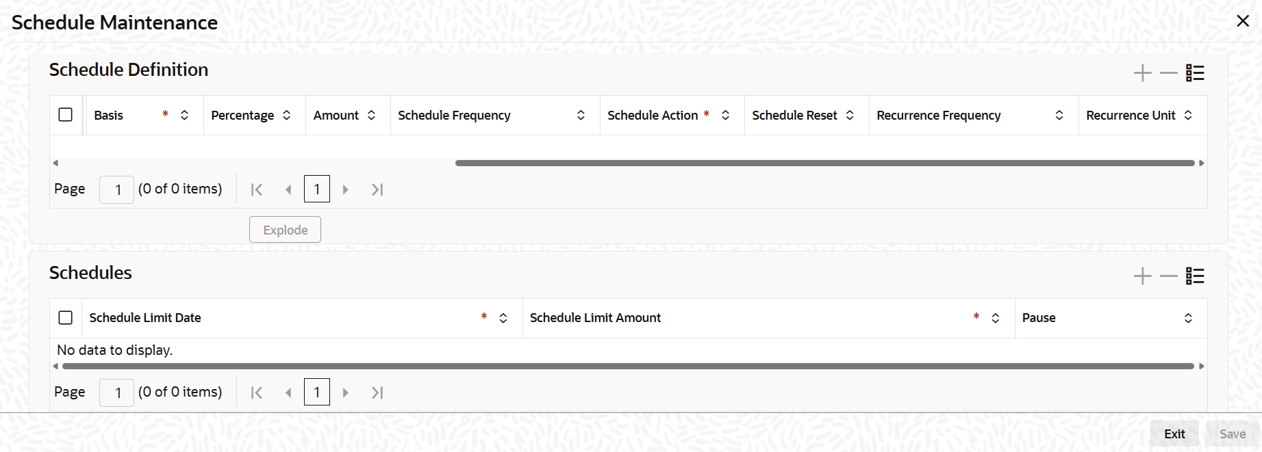

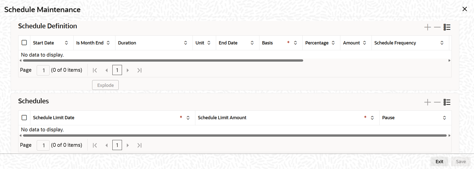

  1. On Facilities Maintenance screen, click the Schedules tab.
    The Schedule Maintenance screen is displayed.
    Figure 2-7 Schedule Maintenance
    Figure 2-8 Schedule Maintenance
