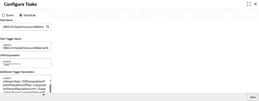

  3. Select the Schedule.
  4. In Task Name, select OBOLTxnSystemAccountBalanceTask.
  5. Enter the Task Trigger Name as unique value per branch, using the format OBOLTxnSystemAccountBalanceTask_<BRANCH_CODE>.
    Example: OBOLTxnSystemAccountBalanceTask_002
  6. Enter the CRON Expression, below are the standard CRON expressions.
    0 0 * * * * = the top of every hour of every day.
    */60 * * * * * = every sixty seconds.
  7. Enter the Additional Trigger Parameters .
    branchCode:::BRANCH_CODE;populationParamStreamSize:::1000;populationParamPopulationOffset:::0;populationParamPopulationLimit:::0;populationParamConsiderDeferredStreams:::true
    In Above format give branch code for which job scheduler needs to setup.
    branchCode:::002;populationParamStreamSize:::1000;populationParamPopulationOffset:::0;populationParamPopulationLimit:::0;populationParamConsiderDeferredStreams:::true

  8. Click Save.
    Figure 2-6 Configure Tasks - System Account Balance Job
    Once configure task is saved successfully, it gets registered to plato-batch-server and job will trigger as per CRON expression mentioned.
