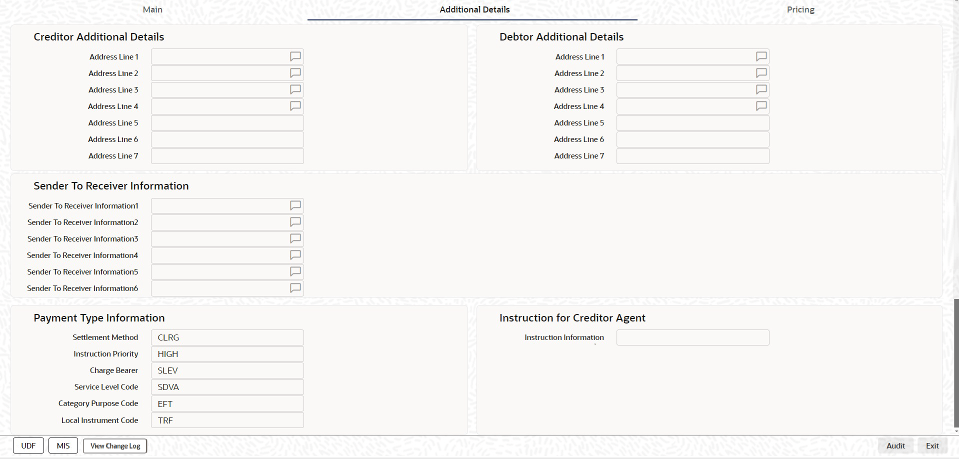

3.1.1.2 Additional Details Tab
This topic explains the Additional Details tab of the NEFT Incoming Payment Transaction Input Detailed screen.
  1. Click the Additional Details tab in the main screen.
    The Additional Details are displayed.
    Figure 3-3 NEFT Inbound Transaction Input - Additional Details Tab
    Description of Figure 3-3 follows
    Description of "Figure 3-3 NEFT Inbound Transaction Input - Additional Details Tab"
  2. On Additional Details tab, specify the fields.
    This tab contains the below fields to capture the address details of debtor/creditor and remittance information from the sender to receiver.
    Table 3-3 NEFT Inbound Transaction Input_Additional Details Tab - Field Description
    Field Description
    Creditor Additional Details This section displays the Creditor Additional Details.
    Address Line 1 to Address Line 7 Specify the Address.
    Debtor Additional Details This section displays the Debtor Additional Details.
    Sender To Receiver Information
    System populates the static text automatically on clicking Enrich button in the Sender to Receiver Information fields, if the Debtor Account Type is NRE.
    Sender to Receiver Information 1- 6 Specify the Sender to Receiver Information.
    Payment Type Information This section displays the Payment Type Information.
    Settlement Method
    System defaults Settlement Method as CLRG.
    Instruction Priority
    System defaults Instruction Priority as HIGH.
    Charge Bearer
    System defaults Charge Bearer as SLEV.
    Service Level Code
    System defaults Service Level Code as SDVA.
    Local Instrument Code
    System defaults Local Instrument Code as TRF.
    FCR Donor Details
    These fields are disabled by default. Only when user selects the category purpose code as FCRA then these fields gets enabled.
    When these fields are enabled then Sender to Receiver Information line 1 to 6 and Indo Nepal Information fields gets disabled.
    Donor Name Specify the Donor Name.
    Donor Address Specify the Donor Address.
    Purpose of Remittance Specify the Purpose.
    Country of Donor, Currency and Amount Specify the Country.
    Instruction for Creditor Agent This section displays the Instruction for Creditor Agent.
    Instruction Information Specify the Instruction Information.
