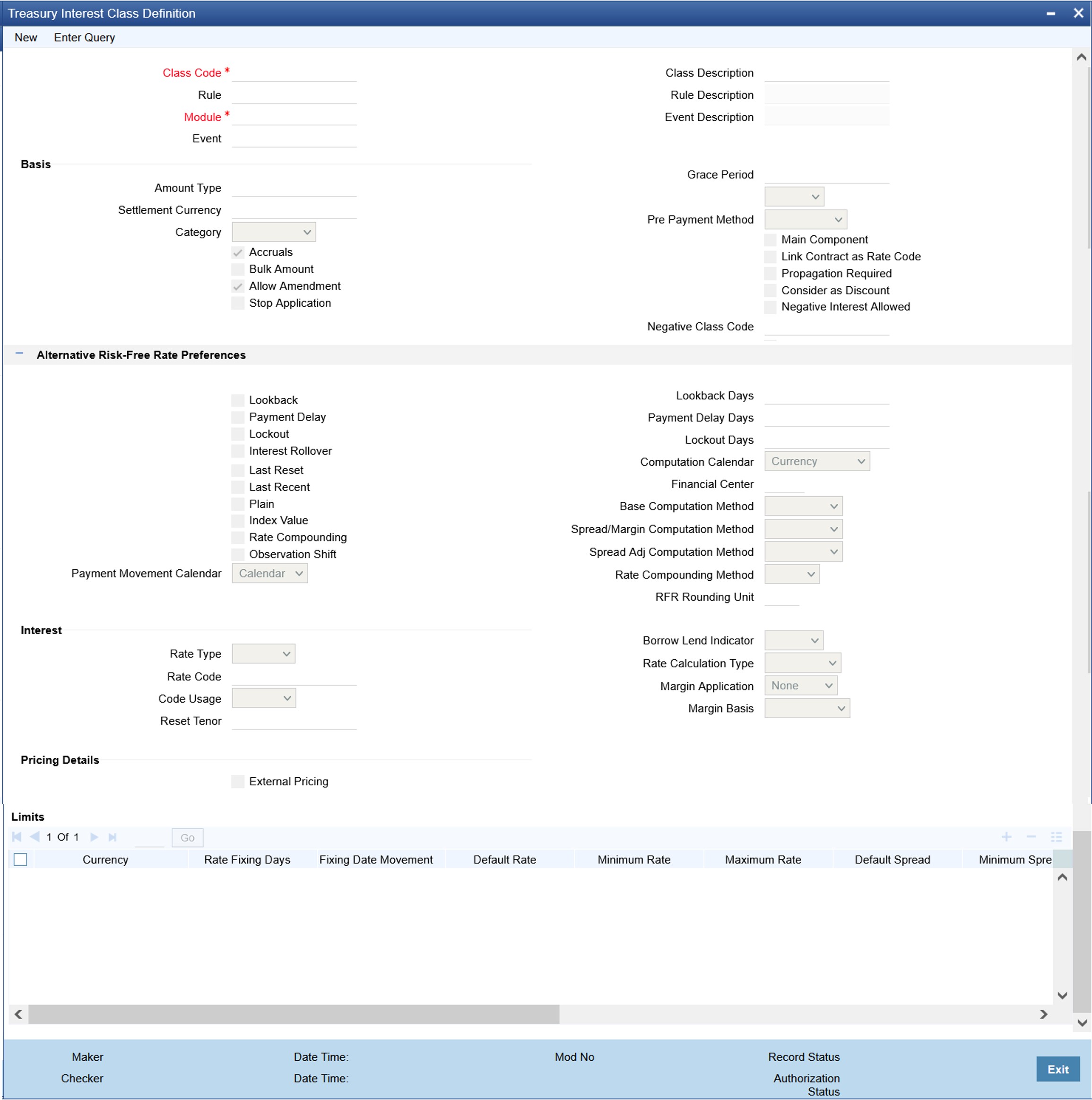

1.1 Define Interest Class
This topic describes the systematic instructions to define interest class.
You need to define the attributes of an interest class, in the Treasury Interest Class Definition screen, invoked from the Application Browser.
  1. On the Homepage, enter CFDTRINC in the text field and then click the next arrow.
    The Treasury Interest Class Definition screen is displayed.
    Figure 1-1 Treasury Interest Class Definition
    Description of Figure 1-1 follows
    Description of "Figure 1-1 Treasury Interest Class Definition"
  2. On the Treasury Interest Class Definition screen, specify the fields.
    For field details and description, refer to the below table.

    Default Rate
    Specify the default rate that should be applied for on contracts under the products linked to this class. Default rate allows negative values if the negative interest is allowed for the class.
    Minimum Rate
    Specify the minimum interest rate that can be applied on contracts under the products linked to this class. Minimum rate allows negative values if the negative interest is allowed for the class.
    Maximum Rate
    Specify the maximum interest rate that can be applied on contracts under the products linked to this class. Maximum rate allows negative values if the negative interest is allowed for the class.
    Default Spread
    You are allowed to specify both positive and negative spread as default for the class you are maintaining. The system validates this spread against the maximum and minimum spread you have specified for the currency. Subsequently, the spread will be defaulted to the contract under the products linked to this class.
    Minimum Spread
    Specify the minimum spread that can be applied on the rate for the currency.
    Maximum Spread
    Specify the maximum spread that can be applied on the rate for the currency.
    Base Computation
    It is either simple or compounded.
    Spread\ Margin Computation
    Spread\ Margin computation method can be maintained as either Simple or compounded.
    Spread Adjustment
    Spread adjustment method is kept as either Simple or compounded
    Weighted Average
    Select this check box to use weighted average calculation (WAC) as the RFR calculation method. The WAC here represent the simple average calculation and not compounded.
    The averaged RFR in this convention is the simple arithmetic mean of the daily RFRs. OBTR supports WAC to calculate base rate (BR), Credit Adjustment Spread (CAS), and Customer Margin. The WAC formula to calculate simple interest is:
    Figure 1-2 Weighted Average Formula
    Formula
    Here,
    db: the number of business days for the interest calculation period
    dc: the number of calendar days for the interest calculation period
    ri: reference rate for the day number i within the interest calculation period
    ni: the number of calendar days for which rate ri applied (on most days, ni will be 1, but on a Friday it will generally be 3, and it will also be larger than 1 on the business day before a holiday
    N: the number of calendar days in one year (360 to 365) For more information on WAC calculation, refer to the RFR WAC sheet.
