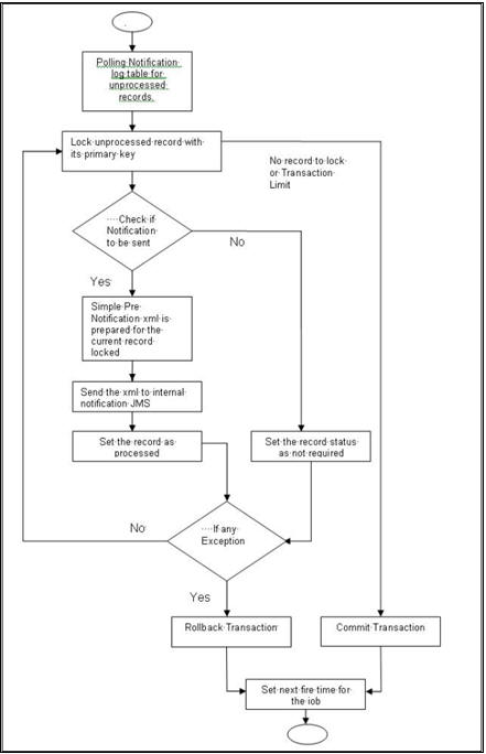

This topic describes the notification process for processing the parameters.
The notification process is in two layers. In the first layer the notification process as part of jobs in FCJ scheduler sends minimal data required for notification to an internal JMS queue. In the second layer the notification process as part of an MDB that listens on internal JMS queue builds final notifications and sends them to their intended destinations. The Notification Process in Treasury using the jobs scheduler is as follows:
  1. The trigger on the base table inserts key details into a static notification log table instead of Oracle AQ.
  2. Once Job is triggered, a request is sent to EJB layer from job execution class and the notification log table is polled for unprocessed records.
  3. Each unprocessed record is locked.
  4. The record is verified against the notification maintenance and checked whether notification is to be sent or not.
  5. If notification is to be sent, pre notification message xml is built and it is sent to internal notify_queue (JMS queue).
  6. The job is then rescheduled to fire next time based on the previous execution.

The flow chart of notification process in scheduler:
Figure 1-31 Notification Process in scheduler

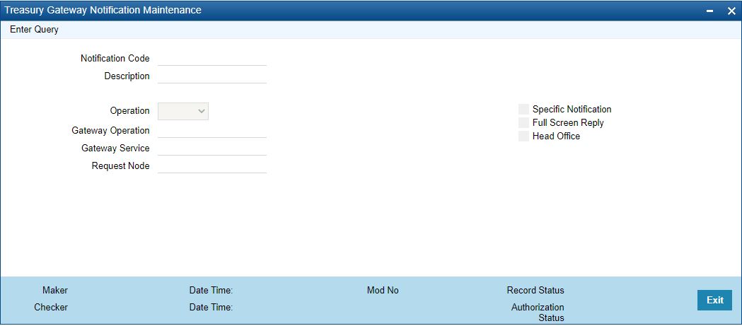

1.28.1 Process Notification Parameters
  1. On the Home page, specify TRDNOTIF in the text box, and click next arrow.
    The Treasury Gateway Notification Maintenance screen is displayed.
    Figure 1-33 Treasury Gateway Notification Maintenance
    Description of Figure 1-33 follows
    Description of "Figure 1-33 Treasury Gateway Notification Maintenance"
  2. On the Treasury Gateway Notification Maintenance screen, specify the fields.
    For more information on fields, refer to the below table.
    Table 1-31 Treasury Gateway Notification Maintenance- Field Description
    Field Description
    Notification Code
    The system displays a unique code to identify a notification.
    Description
    The system displays a brief description of the notification. However, you can modify the description in this screen.
    Operation
    Select the type of operation for the notification from the following.
    • Insert- Indicates a new operation of notification function
    • Update- Indicates a modification operation of notification
    Gateway Operation
    Specify the gateway operation name to execute query for the mentioned service.
    Gateway Service
    Specify the gateway service to be used to get the full screen response.
    Request Node
    Specify the gateway IO request node to be used in querying operation.
    Specific Notification
    Select the Specific Notification check box to indicate the system to send specific notification. The system handles any deviation from generic notification process by creating specific triggers once you check this field.
    Full Screen Reply
    Select the Full Screen Reply check box to indicate that the full screen notification response has to be sent. Otherwise, the primary key response notification is sent.
    Head Office
    Select the Head Office check box to send notification only from head office.
