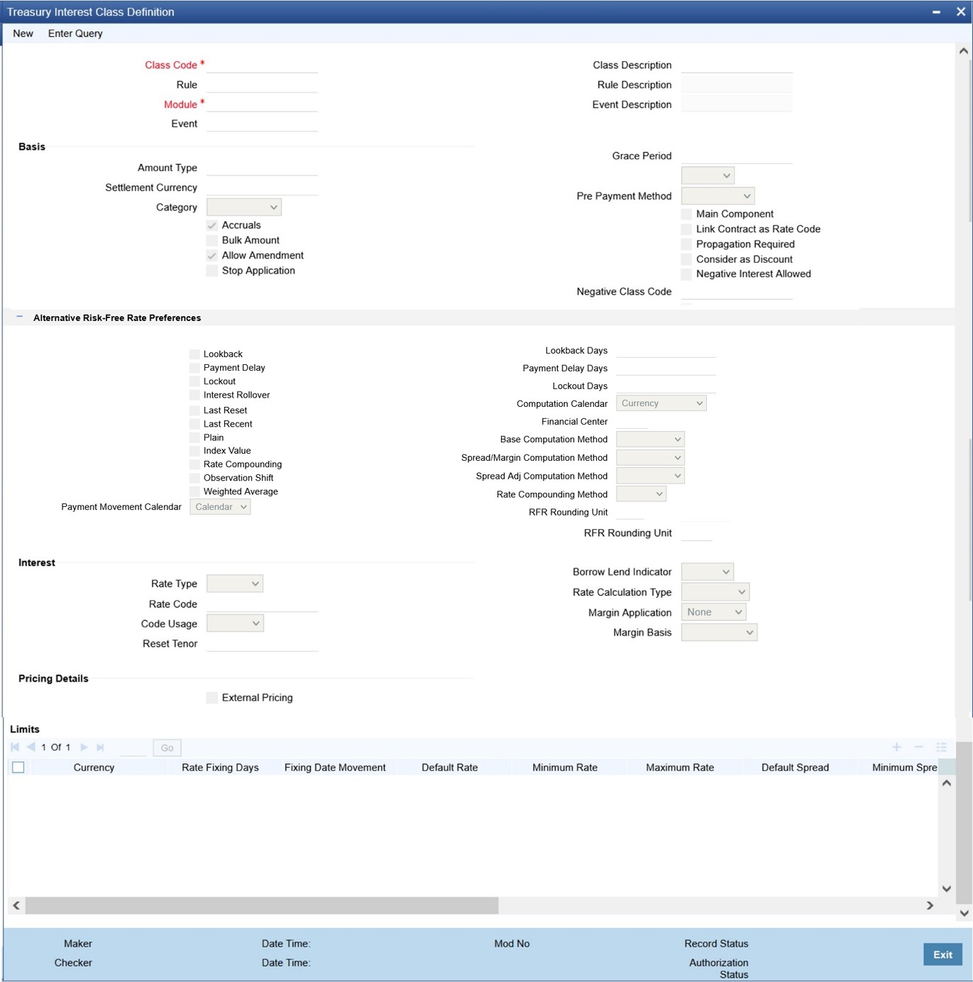

- On the Home page, type CFDTRINC in the text box, and click the next arrow.
Treasury Interest Class Definition screen is displayed.
Figure 3-3 Treasury Interest Class Definition
Description of "Figure 3-3 Treasury Interest Class Definition" - On the Treasury Interest Class Definition screen, specify the details as required.
For information on fields refer to: xref
The following steps are followed:
- Rate code Field will fetch all the rate codes maintained at CFDFLTRI (floating rate code) and CFDRFRRT (RFR codes).
- If the RFR flag is checked, the rate code selected is maintained in CFDRFRRT(RFR codes) screen. Selecting the rate code is mandatory when RFR flag is checked.
- If the RFR flag is unchecked, select a rate code maintained in CFDFLTRI (floating rate code).
- Under limits multi-block, the system allows the saving of record for RFR mapped rate code currency only. Example for RFR code: RFR, only USD currency record is permitted. If in case any other currency is maintained, the system validates accordingly throws an error.
- For an RFR rate code currency, entering min and max rate is allowed.
- There are no restrictions on the interest basis selection for RFR rate codes.
- RFR usage is allowed only for the Main Interest component.
- The system allows multiple Interest class records for same RFR code and currency but with different preferences.
- After the Interest class maintenance is saved and authorized, the system allows the user to unlock the RFR details and modify it based on the requirement.
