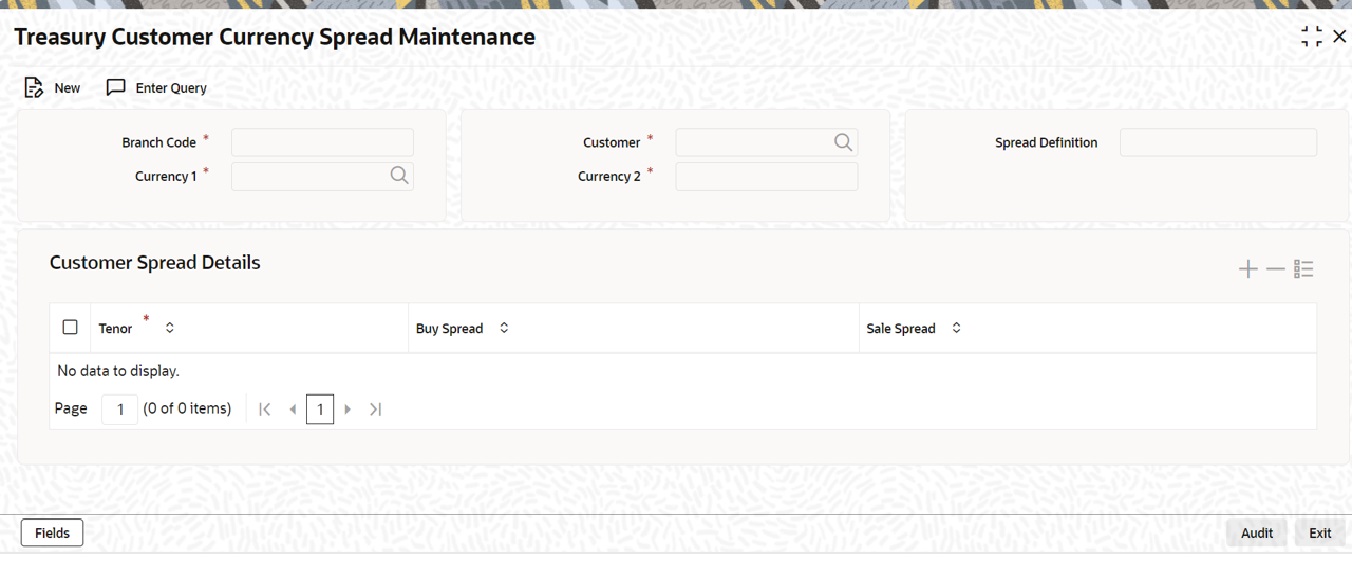

The method of spread definition – percentage or points – that you have maintained for the currency pair is displayed on this screen.
