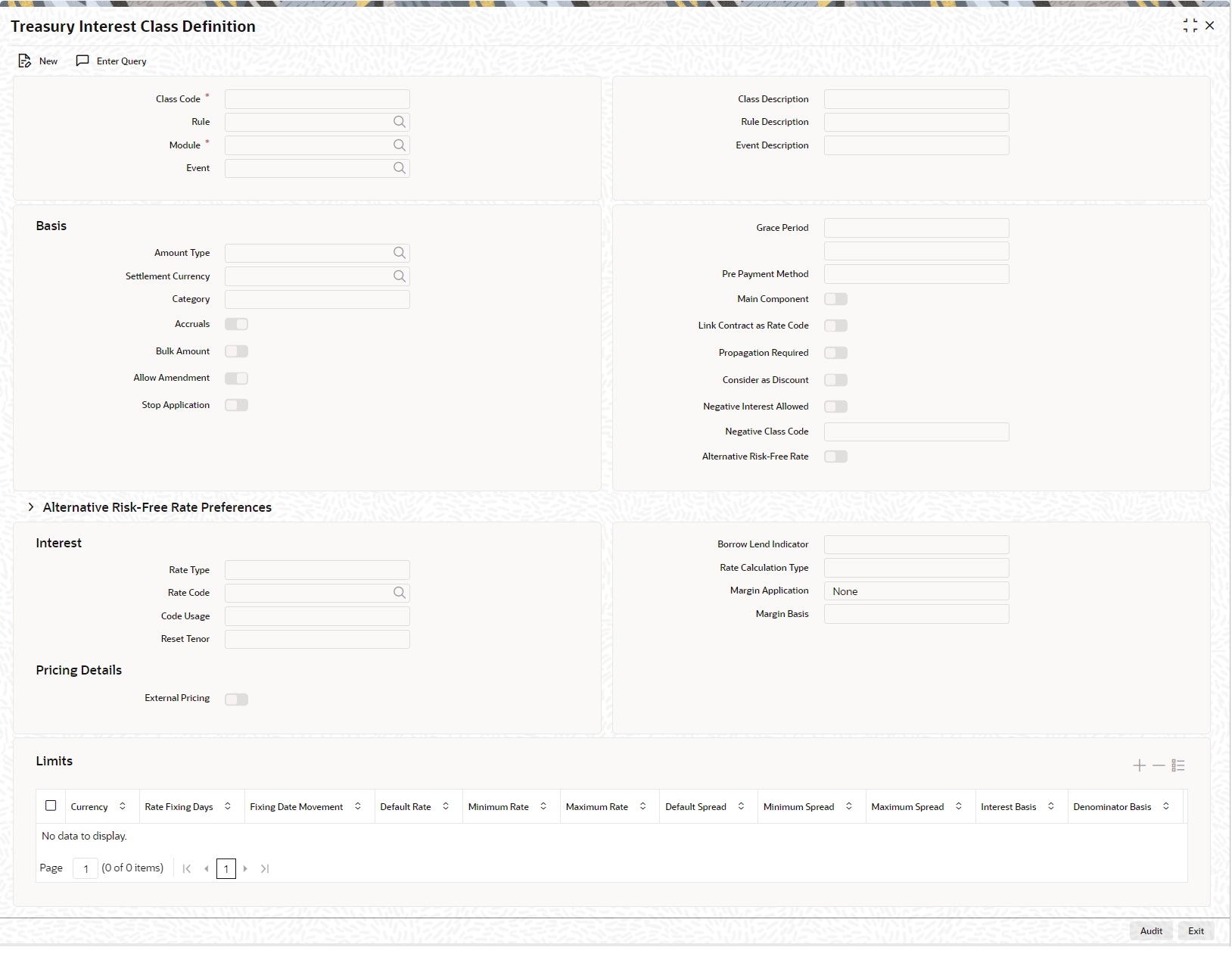

  1. On the Home page, type CFDTRINC in the text box, and click the next arrow.
    Treasury Interest Class Definition screen is displayed.
    Figure 3-3 Treasury Interest Class Definition
    Description of Figure 3-3 follows
    Description of "Figure 3-3 Treasury Interest Class Definition"
  2. On the Treasury Interest Class Definition screen, specify the details as required.
