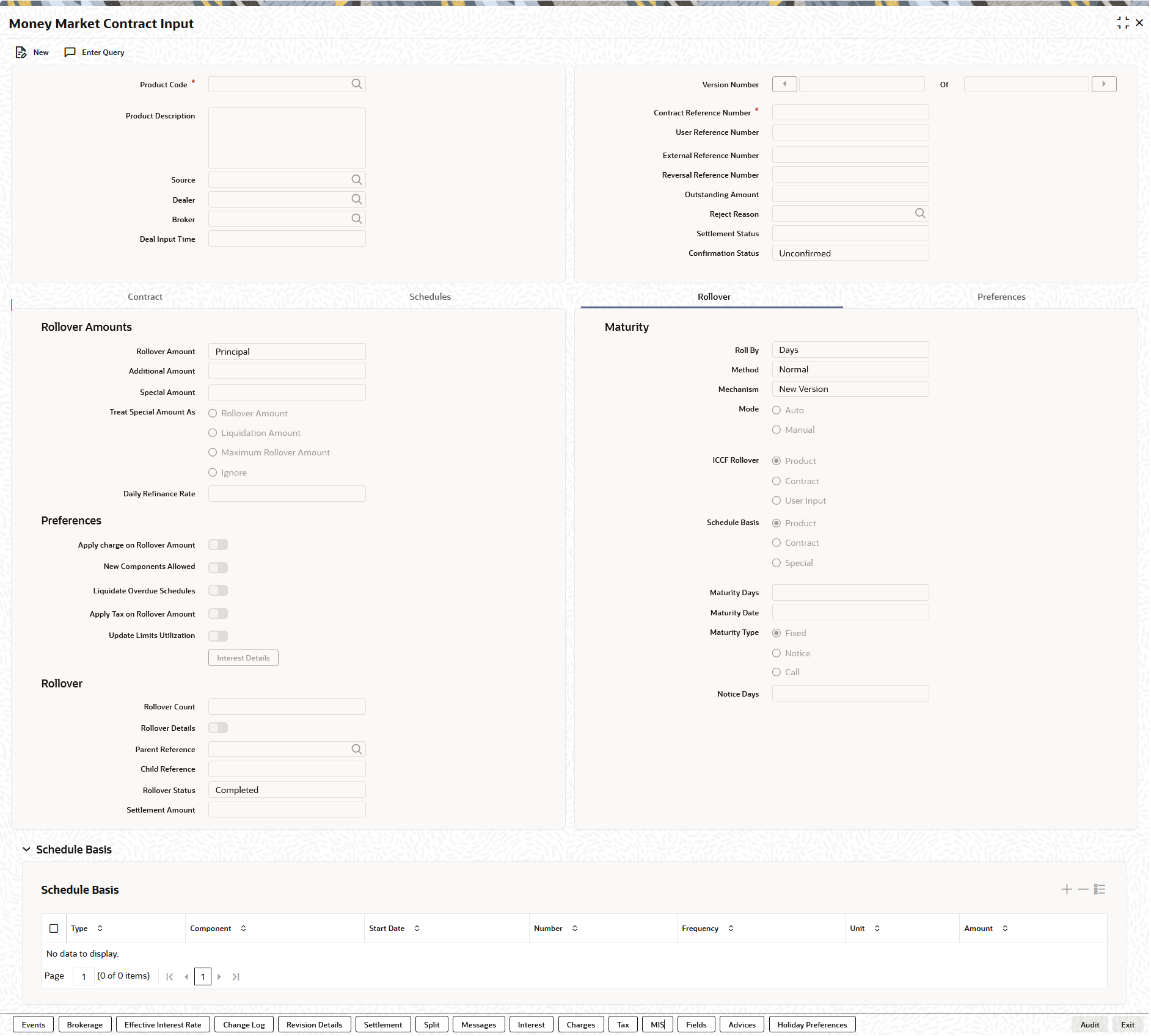

3.1.3 Rollover Tab
  1. On the Money Market Contract Input screen, click Rollover.
    Money Market Contract Input with Rollover tab details are displayed.
    Figure 3-4 Money Market Contract Input - Rollover
    Description of Figure 3-4 follows
    Description of "Figure 3-4 Money Market Contract Input - Rollover"
  2. Specify the details in the Rollover tab as required.
    For information on fields, refer to the below table.
    Table 3-4 Roll over tab - Field details
    Field Description
    Roll over Amount
    Specify the option for the Rollover Amount from the drop down list as required. The options are:
    • Principal
    • Principal + Interest
    • Principal + (Interest - tax)
    • Principal + Additional Amount
    • Principal + Interest + Additional Amount
    Additional Amount
    Specify the additional details as per the requirement.
    Special Amount
    Specify the special amount if applicable
    Treat Special Amount as
    If the Special amount is specified, from the following options specify the what should it be treated as:
    • Rollover Amount
    • Liquidation Amount
    • Maximum Rollover Amount
    • Ignore
    Daily Refinance Rate
    Specify the refinance rate as per the requirement.
    Roll By
    Choose the Maturity Roll by from the drop down list:
    • Days (Default)
    • Months
    • Quarters
    • Semiannual
    • Years
    Method
    Choose the method of Maturity from the drop down list:
    • Normal (Default)
    • Split
    • Consolidated
    Mechanism
    Choose the Rollover Mechanism of the contract from the drop down list
    • New Version (Default)
    • Spawn Contract
    • Linked Contract
    Mode
    Choose the Mode of Rollover as required, The options are:
    • Auto
    • Manual
    ICCF Rollover
    Specify the ICCF Rollover as required. The options are:
    • Product
    • Contract
    • User Input
    Schedule Basis
    Specify the Schedule Basis for Rollover as required. The options are:
    • Product
    • Contract
    • Special
    Apply Charge on Rollover Amount
    Select this option to apply charge on rollover amount.
    New Components Allowed
    Select this option to allow new components.
    Liquidate Overdue Schedules
    Select this option to liquidate the overdue schedules
    Apply Tax on Rollover Amount
    Select this option to apply tax on rollover amount.
    Update Limits Utilization
    Select this option to update the limits utilization.
    Interest Details
    Click this button to launch the interest details screen and user can choose the field preferences which needs to be rolled over as part of Child contract or new version of the contract. The below preferences can be modified during rollover and unlock of the contract:
    • Alternative Risk Free Rate
    • Base, Spread/Margin, and Spread adjustment computation methods
    • Lookback, Lockout and Payment Delay Days
    • Customer Margin
    • Interest Basis
    • Spread Adjustment
    This Interest Details button is only enabled, if the ICCF Rollover is selected as User Input.
    For more information, refer to the below section.

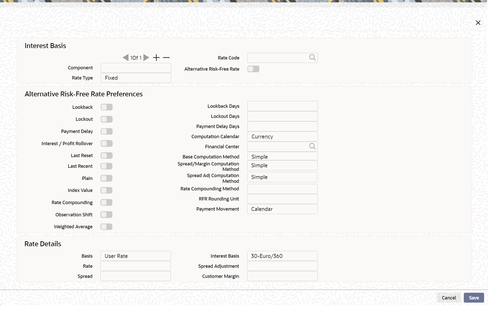

    1. Click the Interest Details button.
      The below screen is displayed.
      Figure 3-5 Money Market Contract Input - Interest Details
      Description of Figure 3-5 follows
      Description of "Figure 3-5 Money Market Contract Input - Interest Details"
    2. Specify the field details in this screen as mentioned below.
      Table 3-5 Field Description
      Field Description
      Component Indicates the interest component.
      Rate Type
      The rate type applicable for the selected product will be displayed. It can be one of the following:
      Fixed: a fixed interest rate
      Floating rate: an interest rate that changes periodically or automatically as per your specifications in the Floating Rate
      Special: an amount instead of a rate.
      Rate Code
      For Floating Rate, the rate code will be displayed.
      Alternate Risk-Free Rate
      Select this option to enable the alternate risk free rate preferences.
      Alternative Risk Free Rate Preferences
      User can select any one of the below RFR calculation methods:
      • Lookback
      • Payment delay
      • Lockout
      • Interest/Profit Rollover
      • Last reset
      • Last recent
      • Plain
      • Index Value
      • Rate Compounding
      • Observation Shift
      • Weighted Average
      The user can also select the combination of the below RFR methods:
      • Lookback and Lockout
      • Lookback and Payment Delay
      • Lockout and Payment Delay
      • Observation shift and Lookback
      • WAC, Lookback and Lockout
      • WAC, Lookback, Lockout and Payment Delay
      • Index, Observation Shift, Lookback and Payment Delay
      • Index, Observation shift, and Lookback
      • Observation shift, Lookback, and Payment Delay
      • WAC, Lookback and Payment Delay
      • WAC, Lockout and Payment Delay
      Lookback
      The user can select Lookback as RFR preference if the Rate Method is In-Arrears.
      The observation period for the interest rate calculation starts and ends a certain number of days prior to the Interest period. As a result, you can choose the interest payment to be calculated prior to the end of the interest period.
      Lookback Days
      This field will only be relevant if Rate Method is In-Arrears or bearing and RFR method is Lookback.
      Lockout
      The user can select Lockout as RFR preference if the Rate Method is In-Arrears.
      Lockout means that the RFR is frozen for a certain number of days prior to the end of an interest period (lockout period).
      During this time, the RFR of lockout period days is applied for the remaining days of the interest period. As a result, the averaged RFR can be calculated a couple of days before the end of the Interest period.
      Lockout Days
      This field will only be relevant if Rate Method is In-Arrears or bearing and RFR method is Lockout.
      Payment Delay
      The user can select Payment Delay as RFR preference if the Rate Method is In-Arrears.
      In this method, Interest payments are delayed by a certain number of days and are thus due a few days after the end of an interest period.
      Payment Delay Days
      This field is relevant if Rate Method is In-Arrears or bearing and RFR method is Payment delay. Number of days by which the interest (or installment) payments are delayed by a certain number of days and are thus due a few days after the end of an interest period.
      Interest Rollover
      Select this check box to enable the interest rollover as RFR preference.
      Payments are set in advance and any missed interest relative to in arrears is rolled over into the next payment period.
      This option combines a first payment (installment payment) known at the beginning of the interest period with an adjustment payment known at the end.
      Plain
      This field is relevant if Rate Method is In-Arrears or bearing and RFR method is Plain. System uses averaged RFR over current interest period, paid on first day of next interest period.
      Last Reset
      This field is relevant if Rate Method is In-Advance and Rate Convention is Last reset. In this option, interest payments are determined on the basis of the averaged RFR of the previous period.
      Last Recent
      This field is relevant if Rate Method is In-Advance and Rate Convention is Last recent.
      In this option, a single RFR or an averaged RFR for a short number of days, are applied for the entire interest period
      Index Value
      Select this check box to use the RFR index rate.
      The RFR Index measures the cumulative impact of compounding RFR on a unit of investment over time. Index Value supports below RFR preferences.
      1. Arrear Method
      2. Advance Method
      1. Arrear Method
        • Lookback
        • Lockout
        • Payment Delay
        • Plain
      2. Advance Method
        • Last Reset
        • Last Recent
      For more information on the RFR Index Value, refer to the attached RFR Index Value calculation worksheet.
      Observation Shift
      Select this check box to apply observation Shift to RFR calculation. The observation shift mechanism provides the rate to be calculated and weighted by reference to the Observation Period rather than the relevant interest period.
      Observation Shift Currently supports below RFR Methods and combination.
      • Lookback
      • Lockout
      • Lookback and Lockout combination
      For more information on the RFR Observation Shift, refer to the attached RFR Observation Shift calculation worksheet.
      Weighted Average
      Select this check box to use weighted average calculation (WAC) as the RFR calculation method.
      The WAC here represent the simple average calculation and not compounded. The averaged RFR in this convention is the simple arithmetic mean of the daily RFRs. OBTR supports WAC to calculate base rate (BR), Credit Adjustment Spread (CAS), and Customer Margin. The WAC formula to calculate simple interest is:
      WAC formula
      Here,
      db: the number of business days for the interest calculation period
      dc: the number of calendar days for the interest calculation period
      ri: reference rate for the day number i within the interest calculation period ni: the number of calendar days for which rate ri applied (on most days, ni will be 1, but on a Friday it will generally be 3, and it will also be larger than 1 on the business day before a holiday
      N: the number of calendar days in one year (360 to 365)
      For more information, refer to the RFR WAC sheet.
      Payment Movement
      Select the payment movement from the drop-down list. The list displays the following values:
      • Calendar
      • Business
      If the option Calendar is selected, then the system skips the Holiday Preferences selected at the contract level.
      If the option Business is selected, it considers holiday treatment specified for schedule as per the Holiday Preferences selected at the contract level.
      Computation Calendar
      Select the Computation Calendar from the drop-down list, when RFR is selected for interest calculation. The available options are:
      • Currency
      • Financial Calendar
      Financial Center
      This field is mandatory if the Financial Center is selected as a computation calendar. Select the code of the financial center from the displayed list of values.
      Base Computation Method
      The Base Computation Method is either simple or compounded.
      Spread\ Margin Computation Method
      Spread\ Margin computation method can be maintained as either Simple or compounded.
      Spread Adjustment Method
      Spread adjustment method is kept as either Simple or compounded.
      Rate Compounding
      This allows enable user to select if rate compounding to be applied for each calculation period. When enabled, system opts for rate compounding instead of amount compounding, amount difference comes into effect only if the pre-payment is done.
      For more information on Rate compounding method, refer to the attached Rate Compounding calculation worksheet.
      RFR Rounding Unit
      Specify the Rounding Units value to round daily index value to the nearest whole number and use it for interest calculation.
      It is applicable only when RFR index value is used.
      Rate Compounding Method
      Select the Rate Compounding Method from the drop-down list. The available options are:
      • CCR
      • NCCR
      This Rate Compounding method produces a rate for a period by applying the RFR compounding formula to the RFR rate and applying the compounded rate to the principal to calculate the interest due. Currently it’s applicable for MM & SR modules.Rate Compounding supports two methods:
      1. Cumulative Compounded Rate (CCR)
      Calculates the compounded rate at the end of the interest period and it is applied to the whole period. It allows calculation of interest for the whole period using a single compounded rate.
      2. Non-Cumulative Compounded Rate (NCCR)
      It is derived from Cumulative Compounded Rate i.e., Cumulative rate as of current day minus Cumulative rate as of prior Banking day. This generates a daily compounded rate which allows the calculation of a daily interest amount. Rate Compounding supports below RFR preferences:
      Arrear Method
      • Lookback
      • Lockout
      • Payment Delay
      • Plain
      Basis
      Indicates the Basis as User by default.
      Rate
      For Fixed Rate type, the rate will be displayed in this screen.
      Spread
      Indicates the spread value.
      Interest Basis
      Indicates the interest basis maintained at the product. User can modify this interest basis during rollover.
      Spread Adjustment
      Indicates the spread adjustment. User can modify this spread adjustment during rollover.
      Customer Margin
      Indicates the customer margin. User can modify this customer margin during rollover.
      User can enter or modify the rollover details in the interest details screen only during Unlock and Rollover Operations.
