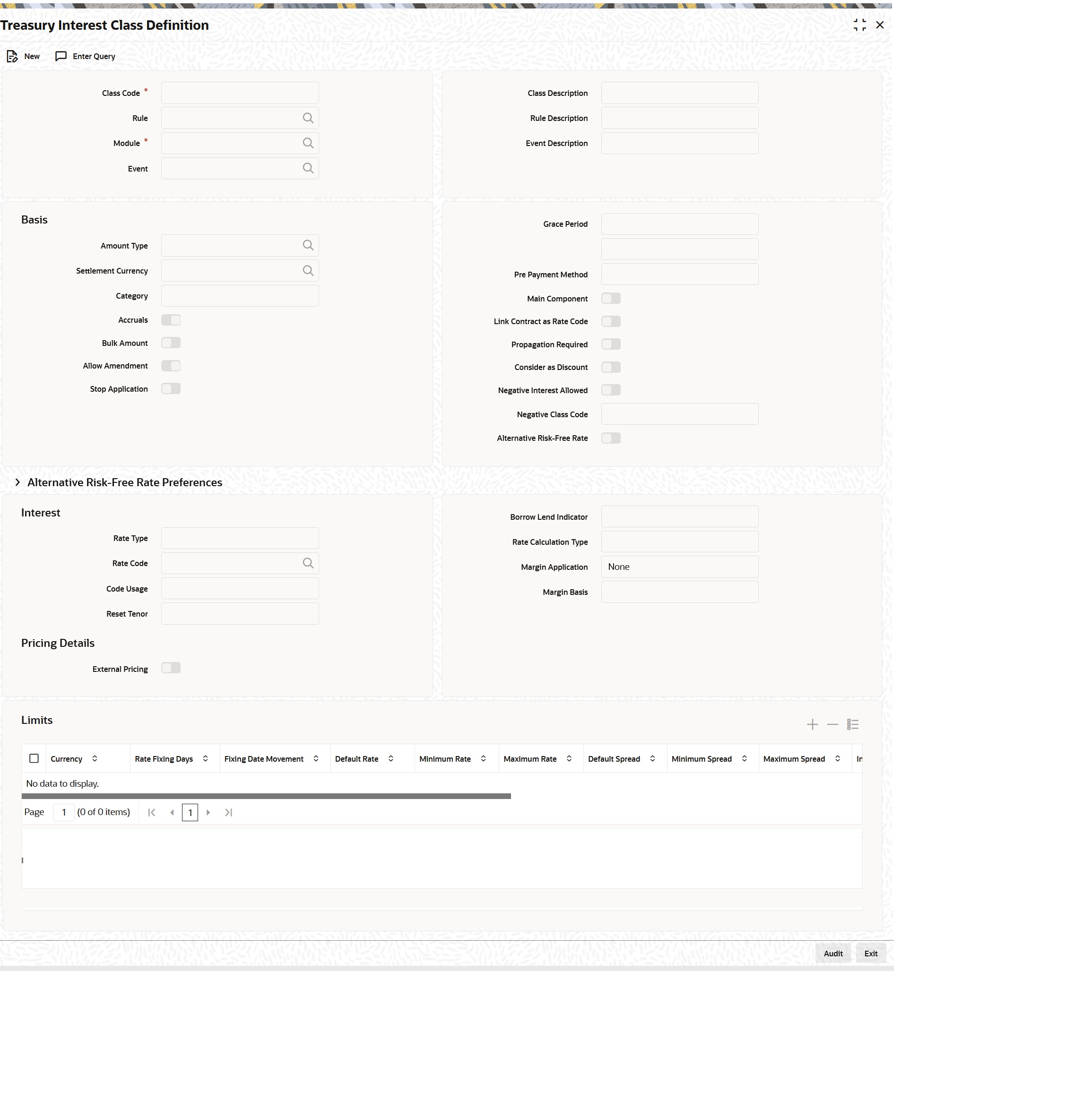

- On the Homepage, enter CFDTRINC in the text field and
then click the next arrow.The Treasury Interest Class Definition screen is displayed.
Figure 1-1 Treasury Interest Class Definition
Description of "Figure 1-1 Treasury Interest Class Definition" - On the Treasury Interest Class Definition screen,
specify the fields.For field details and description, refer to the below table.
