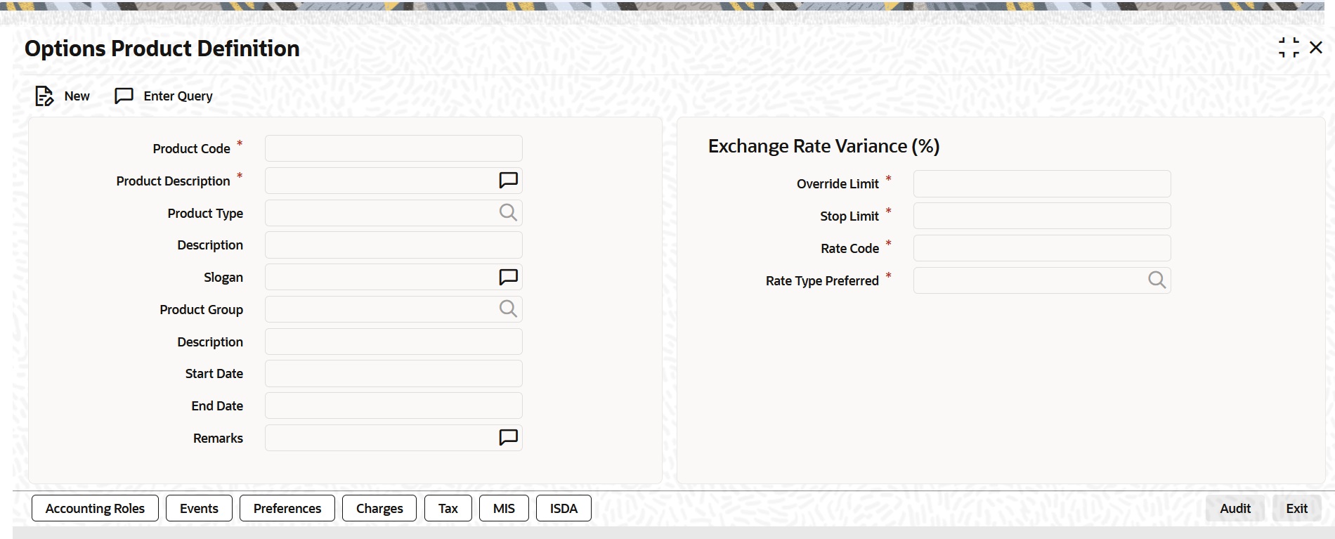

- On Home page, type OTDPRMNT in the text box, and then click next arrow.The Options Product Definition screen is displayed.
- On the Options Product Definition screen, click New.
- On the Options Product Definition screen, specify the fields.
The first attribute you define for a product is its Type. Once you have made this basic classification, then you can tailor the product to suit your requirements. Therefore, before specifying the attributes of a product, you have to indicate whether the product is an Interest Rate option product or whether it is a Currency option product.
Since you define products for convenience, all OT deals involving the product inherit the attributes defined for the product. Yet, you have room for flexibility. You can change the inherited attributes of a specific option to suit your requirements at the time of processing it.
For any product you create in Oracle Banking Treasury Management, you can define generic attributes, such as branch, currency, customer restrictions, interest details, tax details, and so on, by clicking on the appropriate icon in the horizontal array of icons in this screen. For an OT product, in addition to these generic attributes, you can specifically define other attributes. These attributes are discussed in detail in this topic.
You can define the attributes specific to an OT product in the OT Product Definition Main screen and the OT Product Preferences screen. In these screens, you can specify the product type and set the product preferences respectively.
For more information on the fields, refer to the below Field Description table.
Table 3-1 Options Product Definition - Field Description
Field Description Product Type Specify the product type. The product type identifies the basic nature of a product. An options product that you create can either be an Interest Rate option or a Currency option. You have to specify the product preferences depending on the product type.
- On the Options Product Definition screen, under Exchange Rate Variance, specify the fields.
For a special customer, or in special cases, you can use an exchange rate (a special rate) that is greater than the exchange rate maintained for a currency pair. The variance is referred to as the Exchange Rate Variance.
When creating a product, you can express an Exchange Rate Variance Limit in terms of a percentage. This variance limit would apply to all contracts associated with the derivatives product.
Table 3-2 Options Product Definition - Field Description
Field Description The Override Limit Specify the override limit. If the variance between the default rate and the rate input varies by a percentage that is between the Override Limit and the Rate Stop Limit, you can save the deal (involving the product) by providing an override.
The Rate Stop Limit Specify the Rate Stop Limit. If the variance between the default rate and the rate input varies by a percentage greater than or equal to the Rate Stop Limit, you cannot save the deal.
Rate Code While settling charges for cross currency settlements, you can choose to debit the customer by applying the mid rate or by using the buy/sell spread over the mid-rate.
Rate Type Specify the Rate Type which should be picked up for exchange rate conversions involving settlement of charges for cross currency deals. You can maintain any one of the following as the Rate Type:

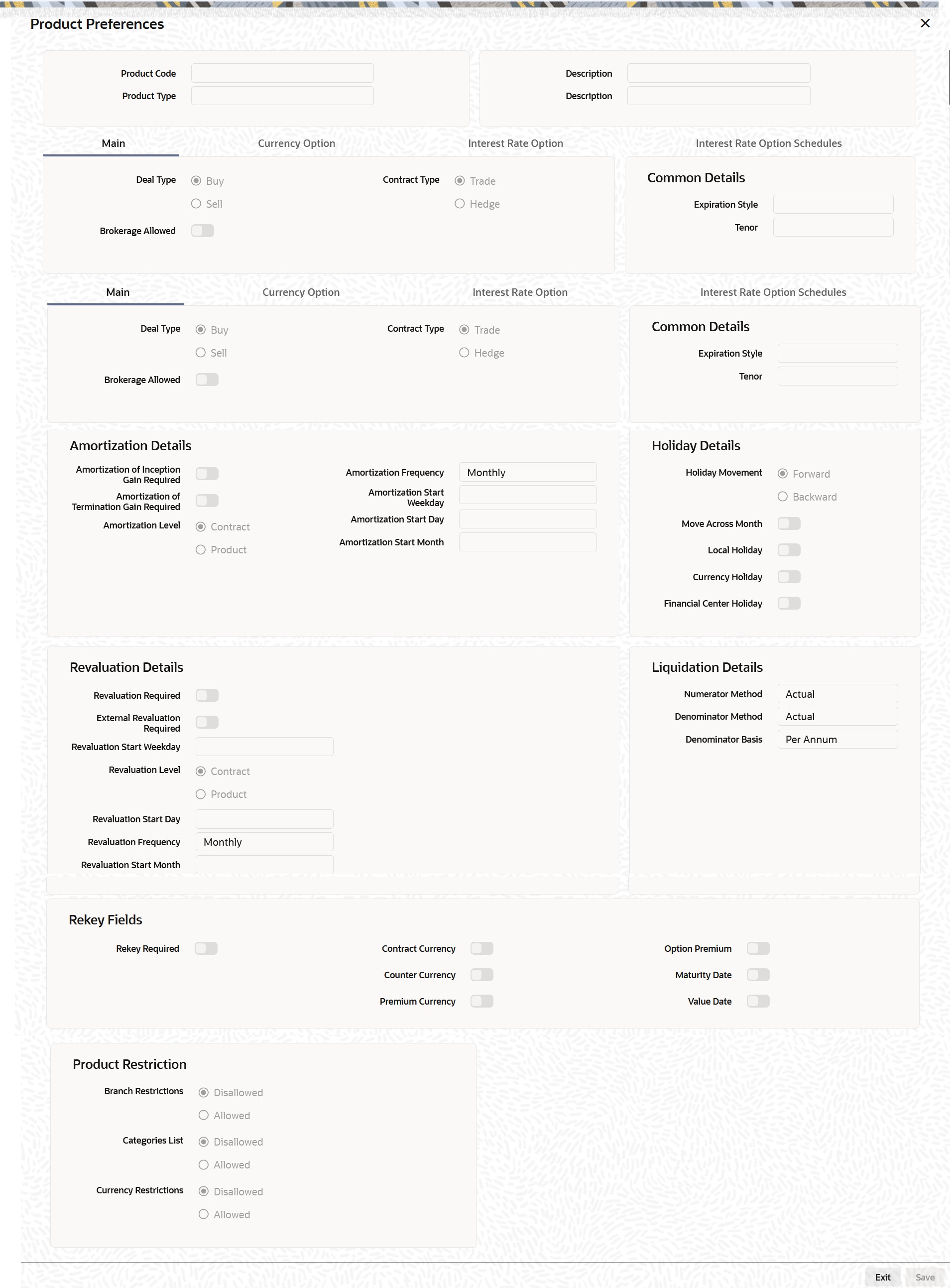

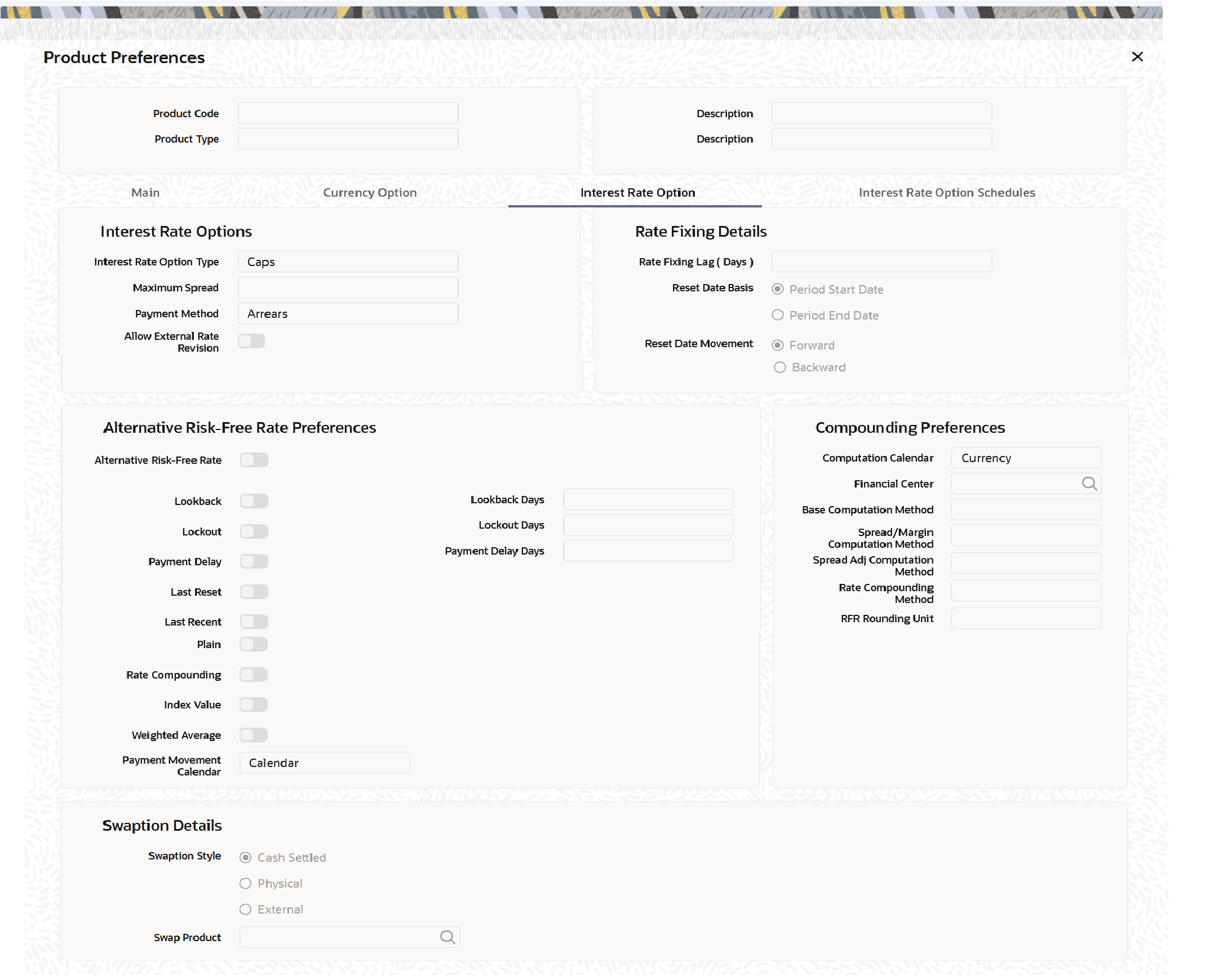

- On Options Product Definition, click Preferences.
The Product Preferences screen is displayed.
Preferences are the options available for defining the attributes of a product. The instruments categorized under a product can inherit the preferences that are defined for it.
Preferences screen gets displayed based on the product type. In case of an Interest rate Option product, the screen is classified into three sections:
- Main – wherein you specify the common preferences applicable to both IRO
- Interest Rate Option – wherein you can specify the attributes specific to an Interest Rate option

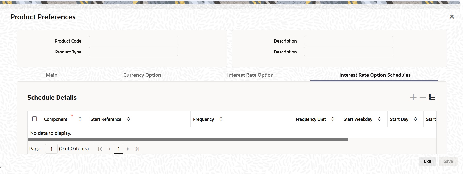

- Interest Rate Option Schedules – wherein you can define schedule for the IRO
In case of a currency option product, the screen has only two tabs:
- Main - wherein you specify the common preferences applicable to Currency options.
Currency Option - wherein you can specify the attributes specific to the currency options.
Each of the preferences is documented in detail in the subsequent topics.
- On the Product Preferences screen, under Main tab, specify the fields.
Table 3-3 Product Preferences - Field Description
Field Description Deal Type Specify whether the product caters to options wherein your bank is buying or selling options. You will be allowed to change this preference for a particular option.
Contract Type Specify whether the product is meant for Trade deals (Speculation on interest rate or spot rate movement) or Hedge deals (Protection against risk due to interest rate or spot rate movement). You will be allowed to change this preference while processing a specific deal.
Brokerage Allowed Select this preference, which indicates that option deals involving this product can involve brokerage.
- On the Product Preferences screen, under Main tab, specify the common details.
Table 3-4 Product Preferences - Common Details - Field Description
Field Description Expiration Style Specify any one of the following methods for contract expiration:
- European - exercise possible only on maturity date
- American - exercise possible between any pre-specified date and the maturity date
- Bermudan - exercise possible only on some pre-specified dates before the maturity date and the maturity date itself
Note: As per swift 2023 standards, expiration style is applicable only for Plain Vanilla.
Tenor (Days) Specify the periodicity of the Options deal involving the product. The periodicity is indicated in terms of days and can be changed while processing a specific contract.
Apart from Swaptions, for all other Interest Rate options, expiration is allowed only on the maturity date (European), since the settlement is always done on the Maturity Date if the option is in the- money.

Table 3-6 Product Preferences - Amortization Details - Field Description
Field Description Amortization Inception Gain Required Check this box if you want the inception gain (if any) to be amortized. At the time of inception, Gain is distributed throughout the contract - from Effective Date to Maturity Date. Amortization of Termination gain Required Specify whether you want to amortize the deferred Termination Gain if an option deal involving the product is terminated prematurely. At the time of termination, Gain is distributed throughout the period of the contract from Termination Date to Maturity Date. This feature is applicable only for hedge deals. In case of termination gain, the amortization will happen from the Date of Termination till the Maturity Date of the contract. Whereas; in case of inception gain, the amortization will happen from the Effective Date till the Maturity Date of the contract. Amortization Level Specify at which level you want the system to perform amortization. It is performed either at the Product or the Contract level. At the product level, accounting entries involving all products are netted, and a single entry is posted for all deals involving the product.
Amortization Frequency Specify the frequency of amortization. The options available are Weekly, Monthly, Quarterly, Half Yearly, and Yearly.
Amortization Start Weekday / Start Day / Start Month In case of a Weekly frequency, Specify the day of the week on which amortization should start. If the frequency is fortnightly or monthly, you have to specify the date on which the amortization starts. Similarly, when the frequency is Half-yearly or Yearly, you have to select the month of the year in which the amortization should start.
Note: If you choose to amortize inception gain, the same is amortized over a period from the value date of the option contract till its maturity/termination irrespective of the date of payment of the premium.
Processing Impact The system processes contracts involving the product based on the preferences you set. Accordingly, the following activities are performed during processing:

- On the Product Preferences screen, under Main tab, specify the Holiday Details.
Table 3-7 Product Preferences - Holiday Details - Field Description
Field Description Holiday Treatment Specify the holiday treatment. In Oracle Banking Treasury Management, a Maturity Date falling due on a holiday is treated in any of the following ways: - Ignore the holiday - In which case the holiday will be ignored and the Maturity Date will be retained as per the frequency
- Choose to follow the Local holiday - The contract Maturity Date is defaulted on the Next Working Day or the Previous Working Day, as per your specifications in the Branch Holiday Maintenance screen
- Choose to follow the Currency holiday - The movement of the Maturity Date is based on the holiday calendars maintained for the currency specified in the Holiday Currency field
- Choose to follow the Financial Center holidays - The movement of the Maturity Date is based on the holiday calender maintained for the financial center specified in the Holiday Financial center field.
Holiday Currency Select the holiday treatment as Currency. If you have chosen the holiday treatment as Currency, indicate the currency code in this field. Resultantly, the movement of the Maturity Date is based on the holidays maintenance for the currency code that you identify in the Holiday Currency field. Financial Center Specify that the holiday treatment needs to be governed by the Financial Center. In such a case, the movement of the Maturity Date is based on the holidays' maintenance for the financial institution (Clearing House) that you identify in the Financial Center field. If you choose either the currency holiday or the holiday calendar maintained for the financial center, you need to specify the currencies or financial institutions for deals involving in the product. When Maturity Date falls due on a holiday, then the system computes the next maturity date. This is based on the combination of holiday calendars maintained for all the currencies or financial institutions that you have specified for the contract. Therefore, the next maturity date for a contract is a working day in all the calendars involved in the contract.
Holiday Movement
Specify the movement of the maturity date.
Occasionally the preferred holiday treatment, the branch holiday, the currency holiday, or the holiday governed by the financial center fall on a holiday.
Whether it is to be moved forward to the next working day or whether it should be moved back to the previous working day.
Local Holiday: Select this check box, to execute the Local Holiday calendar validation of the dates and movement of schedules.
Currency Holiday: Select this check box, to execute the Currency Holiday Calendar validation of the dates and movement of schedules.
Financial Center: Select this check box, to execute the Financial Center Holiday Calendar validation of the dates and movement of schedules.
Moving the Maturity Date across Months If you choose to move the Maturity Date falling due on a holiday either forward or backward, such that it falls due on a working day, and it crosses over into another month, the maturity date is moved into the next month only if you so indicate. If not, the maturity date will be kept in the same month. - On the Product Preferences screen, under Main tab, specify the Revaluation Details.

Table 3-8 Product Preferences - Revaluation Details - Field Description
Field Description Revaluation Required Select Revaluation Required check box for a contract involving the product needs to be revalued. External Revaluation Required Select External Revaluation Required check box for the contract level revaluation level (Revaluation done externally). The External Revaluation Required flag is amendable.
External revaluation is done for trade deals only.
The event and the accounting entries maintained for the product to trigger external revaluation is operational controlled.
Revaluation Frequency and Revaluation methods are not considered for External revaluation.
You can choose either the option Revaluation Required or External Revaluation Required at a time. You cannot choose both at the same time.
Revaluation Level Enable this preference to specify the level at which revaluation is to be performed. At the product level, revaluation entries are netted and passed for all deals involving the product.

- On the Product Preferences screen, under Main tab, specify the Liquidation Details.
Table 3-9 Product Preferences - Liquidation Details - Field Description
Field Description Numerator Method Select the method that is used to calculate the number of days between the schedule start and end dates for calculating the settlement amount from the adjoining drop-down list. The list displays the following values:

- On the Product Preferences screen, under the Main tab, select the Rekey filed.
Select the Rekey check box to specify the values of certain fields should be entered when an Option contract is invoked for authorization - as a cross-checking mechanism.
While defining the product you have to indicate the fields whose values you need to enter before a contract is authorized. Thus it becomes mandatory for you to enter the values of rekey fields for all contracts linked to the product.
You can specify any or all of the following as rekey fields:

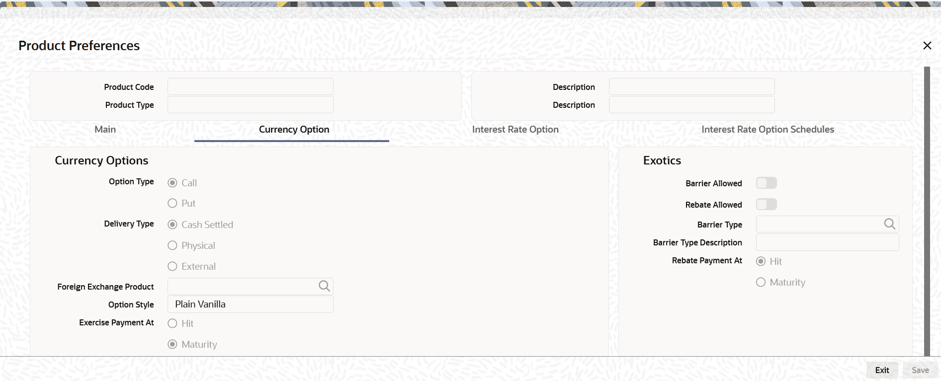

- On the Product Preference screen, click the Currency Option tab.
The Currency Option section is displayed.
Since currency option preferences are specific to currency options, the Currency Option tab displays only if you have indicated that you would like to define products meant for Currency Options.
- On the Product Preferences screen, under Currency Option tab specify the currency options.
Table 3-10 Product Preferences - Currency Option - Field Description

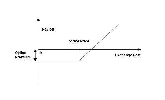

Field Description Option Type Specify whether the currency option that you define is a Call option or a Put option.
- A call option gives the buyer the right to buy a specified quantity of a certain currency (contract currency) against another (counter currency) at a specified exchange rate on or before a pre-specified future date. If on the specified future date, the market exchange rate is lower than the rate specified in the call option, the buyer will not exercise the right and, instead, buy the contract currency at the more favorable market rate.
- A put option gives the buyer the right to sell a specified quantity of a certain currency (contract currency) against another (counter currency) at a specified exchange rate on or before a pre-specified future date. If on the specified future date, the market exchange rate is higher than the rate specified in the put option, the buyer will not exercise the right and, instead, sell the contract currency at the more favorable market rate.
Currency Options, thus, protect the buyer against adverse exchange rate movements, while giving the buyer the benefit of favorable exchange rate movements.
Delivery Type Specify the delivery type. Options involved in a product can either be allowed to get into future FX deals (Physical) or you can opt for a net cash agreement on exercise (Cash Settled) or could be external (through uploads). If you choose Physical as the delivery type, you have to identify the Spot FX product which is to be used to upload an FX contract. If you choose the Cash Settled option, you have to indicate whether the option style is any one of the following:
- Plain Vanilla - This is a contract that provides the buyer the right but not the obligation to buy or sell the underlying currency at a predetermined rate. The expiration style can be American, European, or Bermudan. This is a standard currency option. It becomes a non-standard option if exercised with a barrier.
- Binary - This is an agreement, under which a fixed amount is paid by the option writer to the option holder if a specific condition is met at any time during the exercise period. The payment of the fixed amount can be either at the time when the specific condition is met before or on maturity date for a manual exercise or on the expiration date for auto Exerci se/expiry.

The buyer’s pay-off for a call option is graphed as follows:
Figure 3-5 Call Option
The buyer’s pay-off for a put option is graphed as follows:
Figure 3-6 Put Option
- On the Product Preferences screen, under Currency Option tab specify the details.
Table 3-11 Product Preferences- Currency Options - Exotics -Field Description
Field Description Barrier Allowed Specify whether a barrier can be used for knock-in or knock-out of an option. A barrier is a predetermined underlying asset price at which the deal ceases to exist (gets knocked out) or comes into existence (gets knocked in). If you enable this preference, you will have to identify the barrier type. The options available are:
- Single Knock In - A deal comes into existence if a pre-specified asset price is met between the start and end of the barrier window
- Single knock Out - A deal ceases to exist (Knocked-out) if a pre-specified asset price is met between the start and end of the barrier window. A pre-determined rebate amount is paid in this case
- Double Knock In - A deal comes into existence if any of the two pre-specified underlying asset prices are met between the start and end of the barrier window
- Double Knock Out - A deal ceases to exist if any of the two pre-specified underlying asset prices are met between the start and end of the barrier window. A pre-determined rebate amount is paid in this case
As per SWIFT 2023 standards, new barrier events are introduced in place of Single Knock In and Single Knock Out as mentioned below:- Below are the Single knock In barrier events:
- Up and in Knock in (UIKI) - If spot rate is greater than barrier price, then Knock in will be triggered
- Down and in Knock in (DIKI) - If spot rate is lower than barrier price, then Knock in will be triggered
- Below are the Single Knock Out barrier events:
- Up and Out Knock Out (UOKO) - If spot rate is greater than barrier price, then Knock out will be triggered
- Down and Out Knock Out (DOKO) - If spot rate is lower than barrier price, then Knock out will be triggered
Refer to Annexure B for examples on the various type of exotic currency options.
Rebate Allowed Select the Rebate Allowed check box for a rebate, that is paid if a contract involving the product gets knocked-out. Rebate is usually given for contracts that are knocked-out before maturity due to a single or double knock-out barrier hit. Banks want to give a rebate on the option premium to a certain percentage of the premium, in case of a knock-out. The amount which is given as rebate can credits to the counterparty’s account, either at Hit or at contract maturity which is determined by the field Payment At.
Barrier Type Select the barrier type from the drop-down menu. Oracle Banking Treasury Management allows you to select any one of the following:
- SKOT- Single Knock Out (SKOT)
- DKOT - Double Knock Out (DKOT)
- SKIN - Single Knock In (SKIN)
- DKIN - Double Knock In (DKIN)
As per swift 2023 standard, the below new barrier types are introduced in place of single knock in and knock out:
- DIKI - Down and In Knock-in
- DOKO - Down and Out Knock-out
- UIKI - Up and In Knock-in
- UOKO - Up and Out Knock-out
- DKIN- Double Knock-in
- DKOT- Double Knock-out
Rebate Payment At Select Hit or Maturity to specify when the Rebate amount has to be paid. Rebate payment for a knock-out option can be made either at Hit or at Maturity. When an option gets knocked-out it is considered as Hit.
Rebate payment for an option which has not knocked-in can be made at Maturity only.
Exercise Payment At Select Hit or Maturity to specify when the exercise amount has to be settled
Note: For an vanilla option, with expiry style as European the exercise payment must be at maturity.
Although you have set these as preferences at the product level, for a specific Currency Option you are allowed to change the following details:
- Option Type
- Delivery Type
- Option Style.
- Barrier Type
- Payment At

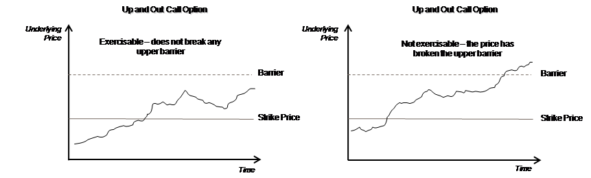

Knock-out Barrier TypesA deal comes into existence, if a pre specified asset price is met between the start and end of the barrier window. A pre-determined rebate amount is paid in this case. The two scenarios are down and out & up and out
- down and out
- up and out
Down and Out (D&O): A type of knock-out barrier Option that ceases to exist when the price of the underlying security hits a specific barrier price level. If the price of the underlying does not reach the barrier level, the investor has the right to exercise their European Call or Put Option at the exercise price specified in the contract.
Example: Consider a one-month down and out Put Option with a strike price of $9.00 with knock-out barrier at $8.00 when the underlying asset is trading at $8.50. The underlying asset diminishes steadily but slowly and closes at $7.50 upon expiration of the Option. Even though the underlying asset is trading lower than the Option's strike price of $9.00, the Barrier Options becomes immediately worthless as the knock-out barrier price of $8.00 is reached.
Up and Out (U&O): A type of Option that ceases to exist when the price of its underlying asset has reached a pre-specified price level.Example: Consider a one-month up and out Call Option with a strike price of $8.00 with knock-out barrier at $9.00 when the underlying asset is trading at $7.00. The underlying asset gains steadily but slowly and closes at $9.50 upon expiration of the Option. Even though the underlying asset is trading higher than the Option's strike price of $8.00, the Barrier Options becomes immediately worthless as the knock-out barrier price of $9.00 is reached.

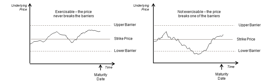

Double Knock In Barrier Type
Double Knock-In means that if the Spot Exchange Rate on a Barrier Event Determination Date is either:- greater than or equal to the Upper Barrier Level or
- less than or equal to the Lower Barrier Level
If the above conditions are applied, the option will knock- in and exercisable.
If the price is not breached, then option will expire.
For example, if the current GBP/USD rate is 1.15, and a trader believes this rate will breach over the next 15 days, the trader could use a double knock in option with barriers at 1.10 and 1.20. If the underlying asset reaches the barrier at any time during the option's life, the knock-in option is brought into active existence and will remain that way until expiration.
Double Knock-Out Barrier Type
Double Knock-Out means that if the Spot Exchange Rate on a Barrier Event Determination Date is either:
- less than or equal to the Lower Barrier Level, then Automatic Termination shall apply to the Transaction upon such occurrence; otherwise, if it is not breached, the option will be exercisable.
For example, if the current GBP/USD rate is 1.15, and a trader believes this rate will stay static over the next 15 days, the trader could use a double knock out option with barriers at 1.10 and 1.20. The investor can profit if the rate does not move beyond either of the two barriers.
- On the Product Preference screen, click the Interest Option tab.
The Interest Option section displays.
Interest Rate preferences are specific to interest rate options. You can access the Interest Rate tab only if you are defining interest rate products.
- On the Product Preferences screen, under Interest Option tab, specify the Interest Rate Option Schedules Preferences.
Table 3-12 Product Preferences - Interest Option - Field Description
Field Description Interest Rate Options Type Indicate whether the Interest Rate option product is meant to cater to any one of the following types: - Caps

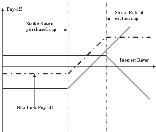

Collar - A collar is a combination of a purchased cap and a written floor. This enables the buyer to lock into an interest rate band.
For example, a floating-rate borrower buys a cap to protect him/herself against a rise in interest rates above the strike rate. The price of this protection is the premium user pays for the cap. The cap, of course, allows the user's to go on enjoying the benefits if the market (reference) interest rates remain below the strike rate – in such events, the user does not exercise the cap and uses market rates to apply to her borrowings. However, if the user has a view that market rates are not likely to fall below a certain rate (which is below the cap strike rate), then the user can choose to forgo part of the benefits of low market rates in return for a reduction in the premium that user pays for the cap.
The user achieves this by simultaneously writing a floor, the strike rate of which is lower than the strike rate of the cap that the user has purchased. The user is of the view that market interest rates are unlikely to go below the strike rate of the floor and, therefore, the floor has little probability of being exercised by the counterparty. The premium that the user receives on the floor partially offsets her premium outgo on the cap.
The above set of deals is bundled in a collar. Suppose Bank A buys a collar from Bank B. This means that Bank A has purchased a cap from Bank B and written a floor favoring Bank B. The following outcomes are possible, depending on various interest rate scenarios:
Table 3-13 Interest Rate Scenario - Outcome
Interest rate scenario Outcome Market interest rate is more than the cap strike rate Bank B pays to Bank A for the difference between market rate and cap strike rate. Market interest rate lies between the floor strike rate and the cap strike rate or is equal to either of them No payment is exchanged. Market interest rate is less than the floor strike rate Bank A pays to Bank B for the difference between the floor strike rate and the market rate. The pay-off for the buyer of a collar is shown in the diagram below:
Figure 3-14 Pay-off

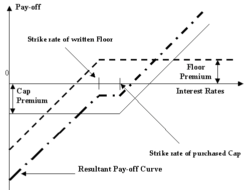

Corridor - A corridor ((also called Bull Spreads)) or a bull spread is a combination of a cap purchased at a certain strike rate and another (otherwise equivalent) cap written at a higher strike rate. Like a collar, a corridor is also a premium mitigation strategy.
An entity with floating-rate borrowings buys a cap to protect itself against interest rates rising above the strike rate of the cap. However, it also feels that there is a limit to the possible rise in interest rates. Therefore, it is willing to sacrifice part of its gains arising from high market interest rates, that is opportunity gains arising from having purchased the cap, in return for a reduction in the premium that it pays for the cap. It achieves this by selling a cap with a strike rate higher than that of the original cap, the premium income on the sold (written) cap partially offsetting the premium outgo on the purchased cap.
The above sets of deals are bundled in a corridor. Suppose Bank A buys a corridor from Bank B. This means that Bank A has purchased a cap 1 from Bank B and written a cup 2 favoring Bank B. The strike rate of cap 1 is lower than cap 2.
Table 3-14 Interest Rate Scenario - Outcome
Interest rate scenario Outcome Market interest rate is equal to or more than the strike rate of cap 2.
Bank B pays Bank A for the difference between the strike rates of cap 1 and cap 2.
Market interest rate lies between the strike rates of cap 1 and cap 2.
Bank B pays Bank A for the difference between market interest rate and cap 1 strike rate.
Market interest rate is equal to or less than the strike rate of cap 1.
The pay-off for the buyer of a corridor is shown in the following figure:
Figure 3-15 Pay-off

- On the Product Preferences screen, under Interest Option tab, specify the Rate Fixing Details.
Table 3-15 Product Preferences - Rate Fixing - Field Description
Field Description Rate Fixing Lag (Days) Specify the number of days before or after the schedule maturity or schedule start date for the reference rate reset to be done. Reset Date Basis Specify whether the reference reset lag is with reference to the Period Start Date (schedule begin date) or the Period End Date (schedule maturity date). Reset Date Movement Fix the reset date lag for the reference rate before (Backward) or after the period start or begin date (Forward).
- On the Product Preferences screen, under Interest Option tab, specify the Swaption Details.
Table 3-16 Product Preferences - Swaption Details - Field Description
Field Description Swaption Style Indicate whether the product is meant for actual interest rate swaps (Physical) or for cash settled swaps or for external swaps (if this product is to be used for uploaded contracts).
For physically settled Swaptions, there will be an underlying derivatives swap deal which will get initiated once the Swaption contract is exercised.
For cash settled Swaptions, the swap value of the contract needs to be calculated outside the system and the same needs to be entered during manual exercise of the Swaption deal.
Swap Product Specify the swap product. This is applicable in case of actual interest rate swaps. You can identify the swap product which is used to default the details of the Derivatives contract. Processing Impact The processing impacts are given below. - While specifying the common preferences if you have selected Hedge as the Contract Type, you will not be allowed to specify Collar as the IRO Type.
- If you have chosen Advance as the Payment Method, then you have to necessarily specify Backward as the Reset Date Movement and Period Start Date as the Reset Date Basis.
- You will not be allowed to upload Derivative contracts for physically settled swaptions. To save an interest rate swap, you will have to invoke the Derivatives Online screen from the Contract Online screen.
- On the Product Preference screen, click the Interests and Rate Option Schedules tab.
The Interests and Rate Option Schedules section displays.
Figure 3-16 Interests and Rate Option Schedules Tab
Description of "Figure 3-16 Interests and Rate Option Schedules Tab"The Settlement Amount (SETTLE_AMT), which is the component for which the schedule is to be defined, is displayed in this screen. You are not allowed to change it.
- On the Product Preferences screen, under Interests and Rate Option Schedules tab, specify the details.
Table 3-17 Product Preferences - Interests and Rate Option Schedules - Field Description
Field Description Start Reference Specify the start reference date. This can either be the Value Date or the Calendar Date. If you specify Value Date as the Start Reference, the settlement schedule is calculated using the frequency and frequency units with respect to the contract value date. If the start reference is Calendar date, the settlement schedule is calculated based on the frequency, frequency units, Start Day, start weekday, and start month (whichever is applicable).
Frequency Specify the frequency. The Frequency of the schedule can either be Daily, Weekly, Monthly, Quarterly, Half Yearly or Yearly. Frequency Units Specify the frequency units. The number of frequency units after which a schedule should repeat. For example, a monthly frequency with a frequency unit of 2 is effectively a bi-monthly schedule. Start Weekday Specify the Start Weekday only if the Frequency is Weekly. Select any day from Sunday to Saturday. This is the day of the Week on which a schedule should start. Start Day Select any day of the month from the 1st to the 31st. Indicate the Start Day if the Frequency selected is Daily or Weekly. This is the day on which a schedule should start.
Start Month Specify the Start Month only in case of Quarterly, Half-yearly and Yearly frequencies. This is the month from which a schedule should start. Adhere to Month End This indicates whether a schedule should adhere to month ends if the maturity date is a day less than the month-end date. For example, a quarterly schedule starting on 31st January will have schedule maturity on 30th April, 30th July, and 30th October if you have failed to enable this option. But if you enable this option, the scheduled maturity will be performed on the 30th of April, 31st of July and 31st of October. It is mandatory to visit the Schedules screen and add an empty row. The system defaults SETTLE_AMT as a component in that

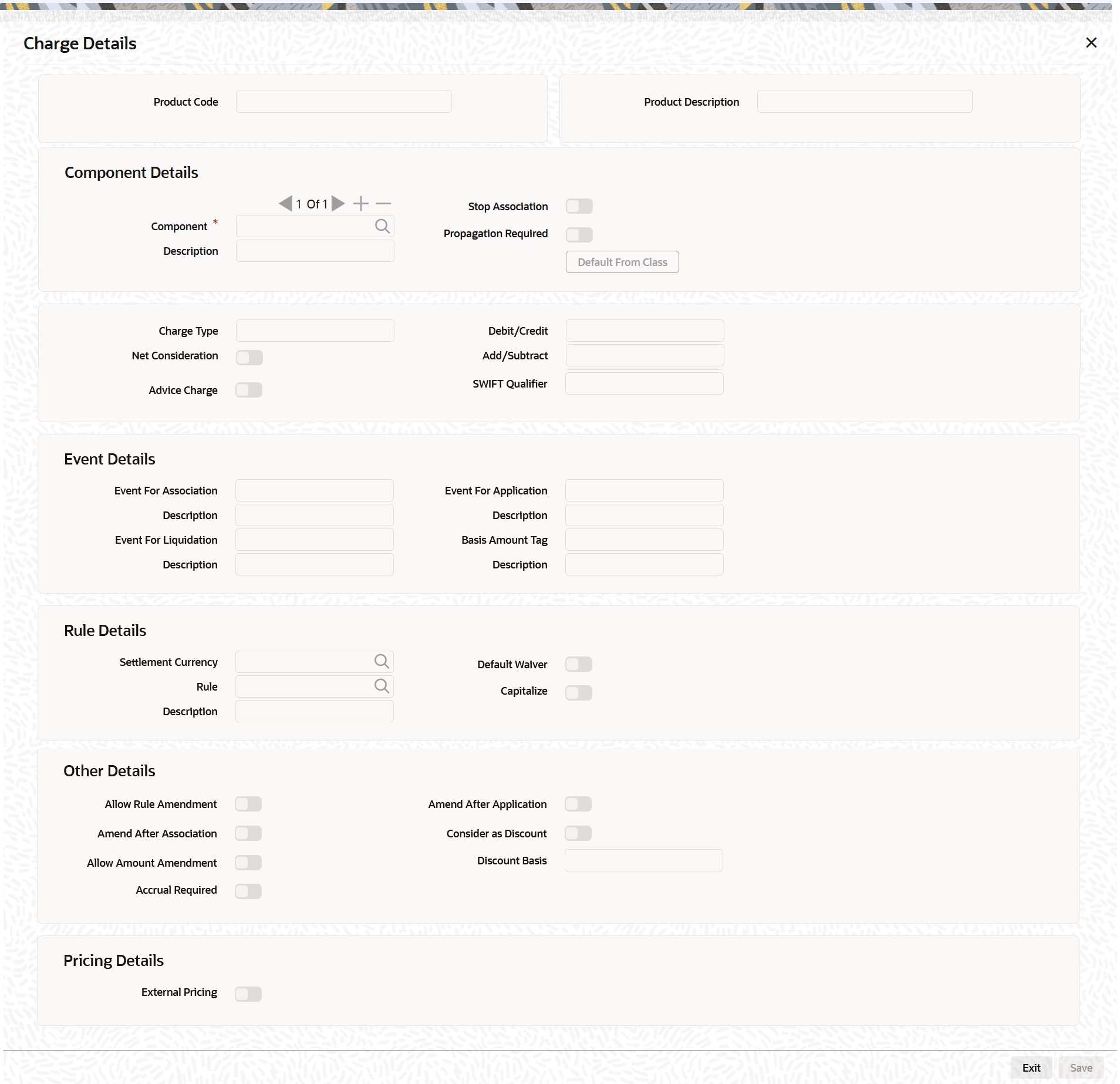

. - On Options Product Definition, click Charges Details.
The Charges Details screen is displayed.
A charge class is a specific type of component that you can build with certain attributes. You can build a charge class, for instance, with the attributes of a specific type of charge component, such as Charge for Manual Exercise. You can specify the different charge components for a product, in the Product Charge Definition screen, by associating the product with the different charge classes you have built.
In Charge Detail screen, you can define the charges for the product that you are creating.
To associate a charge class to a product that you are defining, choose the Default From Class button. A list of the classes that you have defined specifically for the OT Interest Rate/ Currency options module is displayed. Choose the class (or classes) that you like to associate with the product.
Charges for the portfolios maintained under the product is calculated on the basis of the associated charge classes.

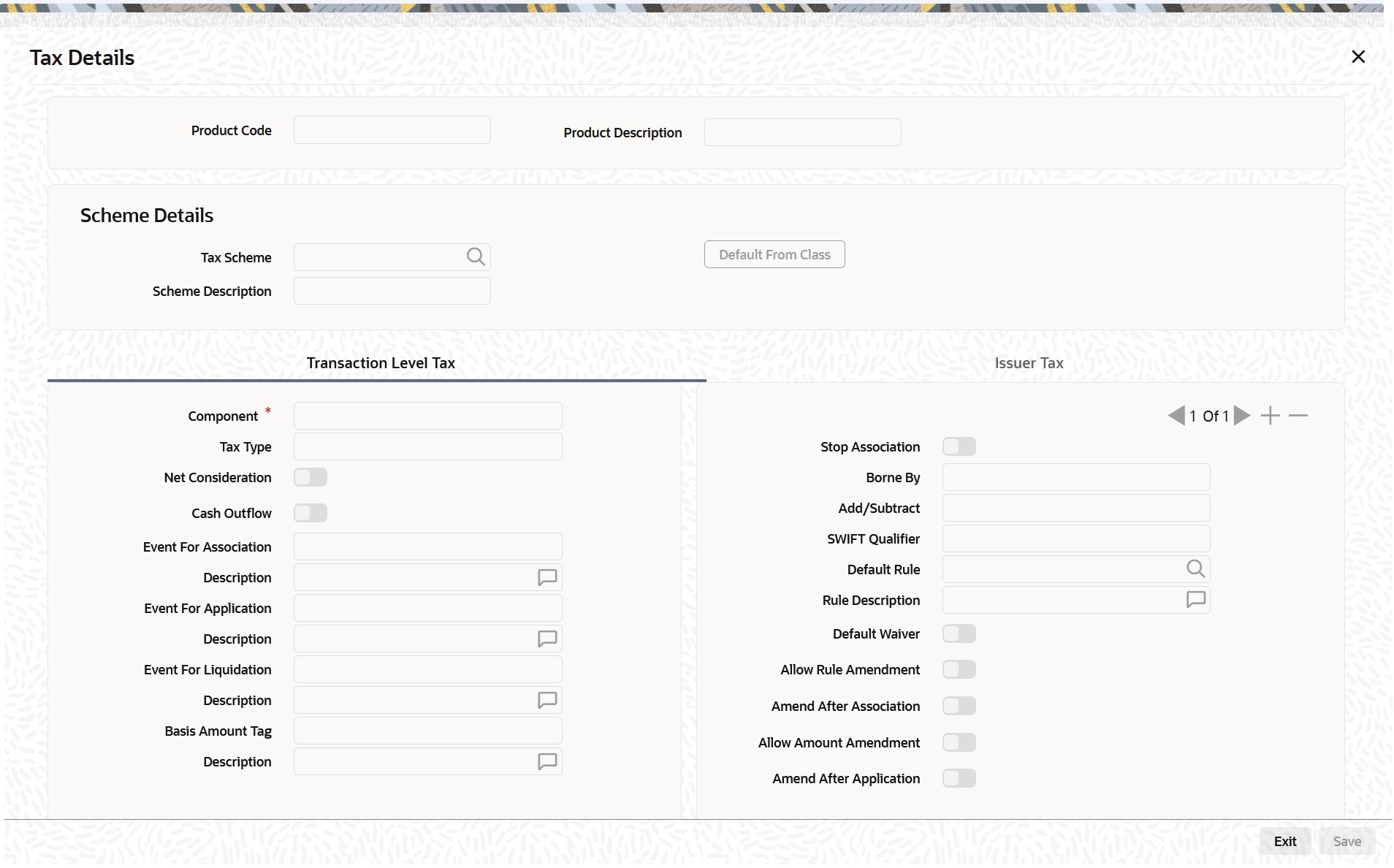

- On Options Product Definition, click Tax.
The Tax Details screen is displayed.
A tax Class is a specific type of component that you can build with certain attributes. You can build a tax class, for instance, with the attributes of a specific type of tax, such as Options tax. You can group several tax classes into a Tax Scheme Class. You can specify the taxes for a product, in the Product Tax Definition screen, by associating the product with a tax scheme class you have built. Note that you cannot define a tax component specific to a product.
To associate a tax scheme class with a product that you are defining, choose the Default From Class button. A list of the tax scheme classes that you have defined specifically for the OT Interest Rate/Currency options module will be displayed. Choose the class that you like to associate with the product.
Taxes for the portfolios maintained under the product is calculated on the basis of the associated tax scheme classes.

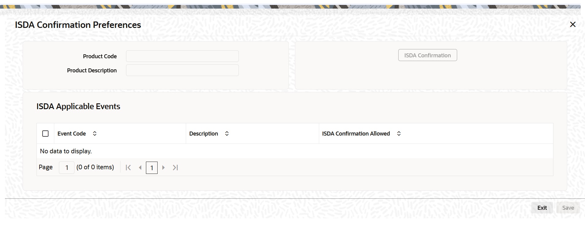

- On the Product Definition screen, click ISDA.
ISDA Confirmation Preferences is displayed.
Figure 3-19 ISDA Confirmation Preferences
Description of the illustration otdprmnt_cvs_isda.jpg - On the ISDA confirmation preferences screen, Click Default ISDA Events, to populate the list of ISDA events applicable for the module.
- Select the check box next to the Description based on the requirement.
- Click Ok to save the details or Exit to close the screen.
