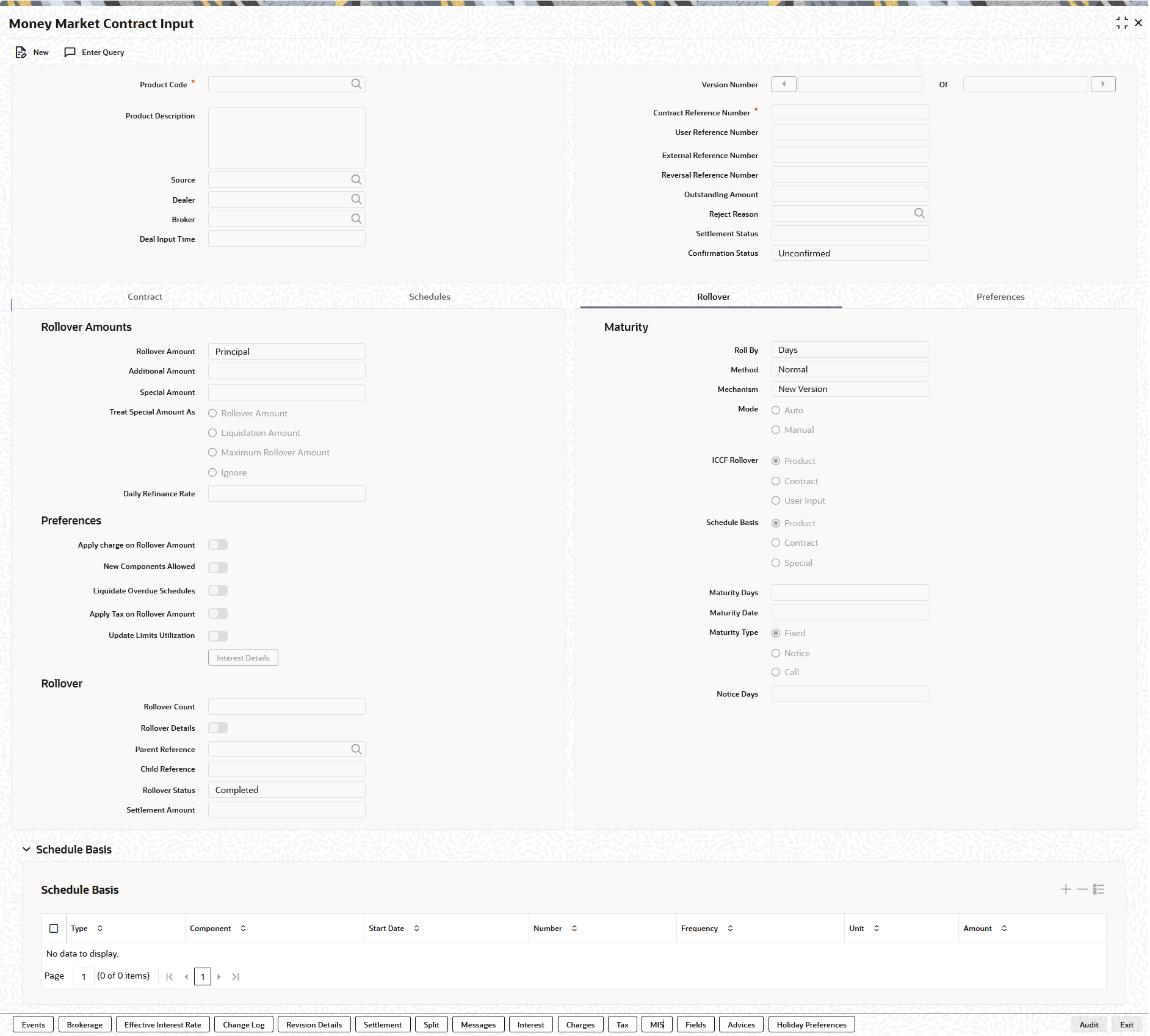

- On the Money Market Contract Input screen, click Rollover. Money Market Contract Input with Rollover tab details are displayed. Figure 3-4 Money Market Contract Input - Rollover
 Description of "Figure 3-4 Money Market Contract Input - Rollover"
- Specify the details in the Rollover tab as required.For information on fields, refer to the below table. Table 3-4 Roll over tab - Field details Field Description Roll over Amount Specify the option for the Rollover Amount from the drop down list as required. The options are: - Principal

 Apply Charge on Rollover Amount Select this option to apply charge on rollover amount. New Components Allowed Select this option to allow new components. Liquidate Overdue Schedules Select this option to liquidate the overdue schedules Apply Tax on Rollover Amount Select this option to apply tax on rollover amount. Update Limits Utilization Select this option to update the limits utilization. Interest Details Click this button to launch the interest details screen and user can choose the field preferences which needs to be rolled over as part of Child contract or new version of the contract. The below preferences can be modified during rollover and unlock of the contract:- Alternative Risk Free Rate

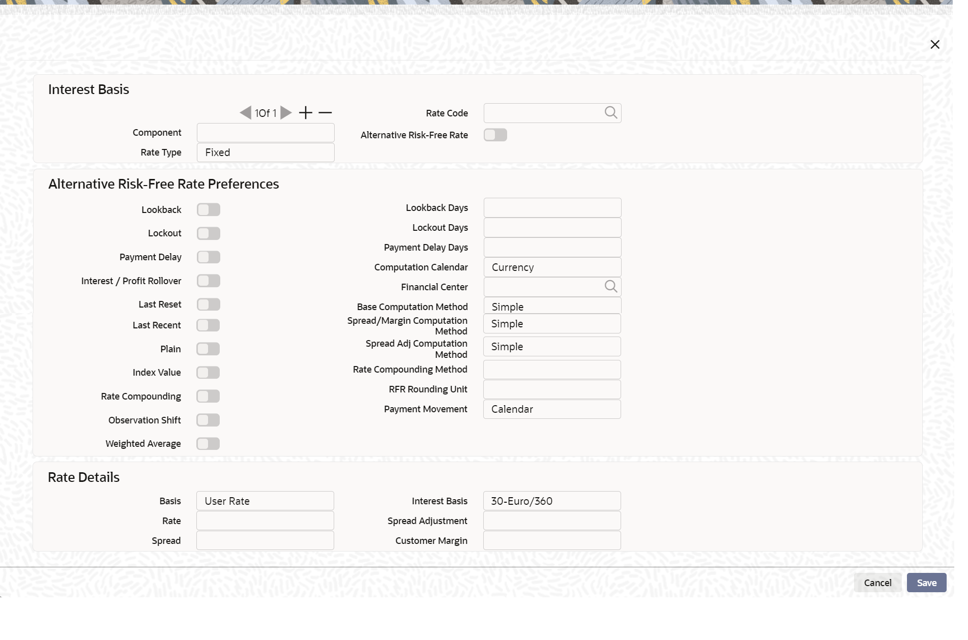

 Note: This Interest Details button is only enabled, if the ICCF Rollover is selected as User Input.For more information, refer to the below section. - Click the Interest Details button.The below screen is displayed.Figure 3-5 Money Market Contract Input - Interest Details
 Description of "Figure 3-5 Money Market Contract Input - Interest Details"
- Specify the field details in this screen as mentioned below.Table 3-5 Field Description Field Description Component Indicates the interest component. Rate Type The rate type applicable for the selected product will be displayed. It can be one of the following: Fixed: a fixed interest rate Floating rate: an interest rate that changes periodically or automatically as per your specifications in the Floating Rate Special: an amount instead of a rate. Rate Code For Floating Rate, the rate code will be displayed. Alternate Risk-Free Rate Select this option to enable the alternate risk free rate preferences. Alternative Risk Free Rate Preferences User can select any one of the below RFR calculation methods: - Lookback

 Lookback The user can select Lookback as RFR preference if the Rate Method is In-Arrears. The observation period for the interest rate calculation starts and ends a certain number of days prior to the Interest period. As a result, you can choose the interest payment to be calculated prior to the end of the interest period. Lookback Days This field will only be relevant if Rate Method is In-Arrears or bearing and RFR method is Lookback. Lockout The user can select Lockout as RFR preference if the Rate Method is In-Arrears. Lockout means that the RFR is frozen for a certain number of days prior to the end of an interest period (lockout period). During this time, the RFR of lockout period days is applied for the remaining days of the interest period. As a result, the averaged RFR can be calculated a couple of days before the end of the Interest period. Lockout Days This field will only be relevant if Rate Method is In-Arrears or bearing and RFR method is Lockout. Payment Delay The user can select Payment Delay as RFR preference if the Rate Method is In-Arrears. In this method, Interest payments are delayed by a certain number of days and are thus due a few days after the end of an interest period. Payment Delay Days This field is relevant if Rate Method is In-Arrears or bearing and RFR method is Payment delay. Number of days by which the interest (or installment) payments are delayed by a certain number of days and are thus due a few days after the end of an interest period. Interest Rollover Select this check box to enable the interest rollover as RFR preference. Payments are set in advance and any missed interest relative to in arrears is rolled over into the next payment period. This option combines a first payment (installment payment) known at the beginning of the interest period with an adjustment payment known at the end. Plain This field is relevant if Rate Method is In-Arrears or bearing and RFR method is Plain. System uses averaged RFR over current interest period, paid on first day of next interest period. Last Reset This field is relevant if Rate Method is In-Advance and Rate Convention is Last reset. In this option, interest payments are determined on the basis of the averaged RFR of the previous period. Last Recent This field is relevant if Rate Method is In-Advance and Rate Convention is Last recent. In this option, a single RFR or an averaged RFR for a short number of days, are applied for the entire interest period Index Value Select this check box to use the RFR index rate. The RFR Index measures the cumulative impact of compounding RFR on a unit of investment over time. Index Value supports below RFR preferences. - Arrear Method
