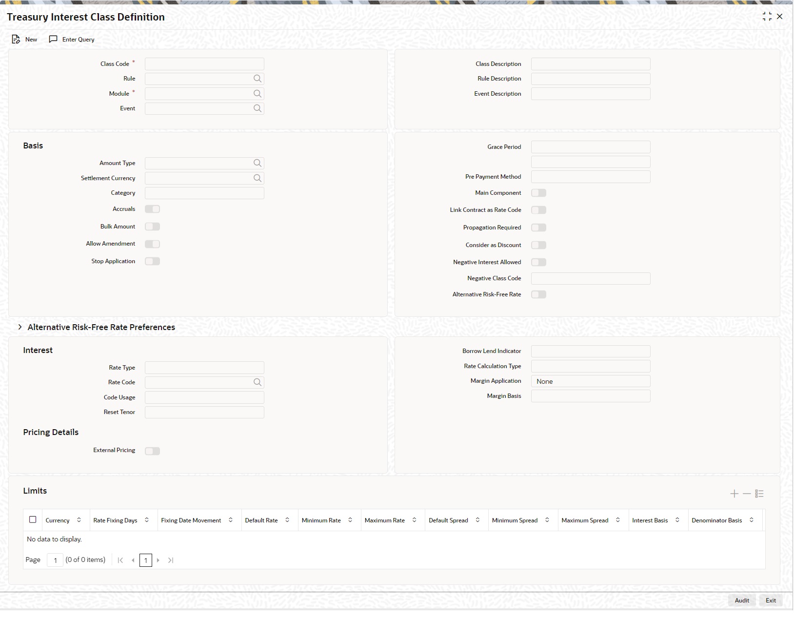

- On the Home page, type CFDTRINC in the text box, and click the next arrow.
Treasury Interest Class Definition screen is displayed.
Figure 3-3 Treasury Interest Class Definition
Description of "Figure 3-3 Treasury Interest Class Definition" - On the Treasury Interest Class Definition screen, specify the details as required.
For information on fields refer to: xref
