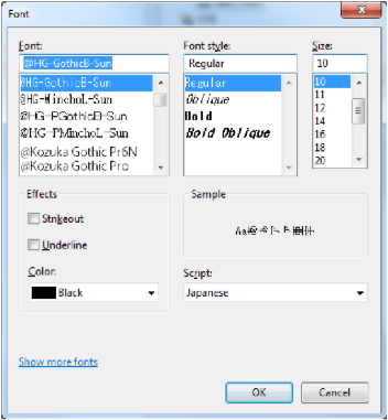

- Open IBM Data Studio and set font in editor for properly displaying Japanese (HG-GothicB-Sun)
- Open the dmkr_admin_xx.sql in a text editor that displays text correctly (in the example below, Notepad properly displayed Japanese text).
- Copy and paste the content of the script into IBM Data Studio tool editor for SQL and validate the characters are correct.

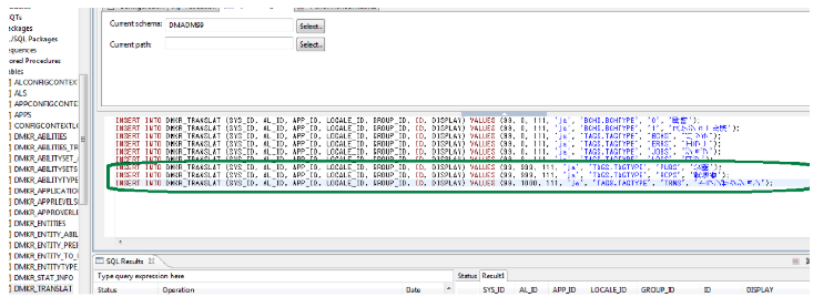

Example from Notepad, dmkr_admin_ja.sql:
INSERT INTO DMKR_TRANSLAT (SYS_ID, AL_ID, APP_ID, LOCALE_ID, GROUP_ID, ID, DISPLAY) VALUES (99, 999, 111, 'ja', 'TAGS.TAGTYPE', 'PUBS', 'ÂÖ¨Èñã');INSERT INTO DMKR_TRANSLAT (SYS_ID, AL_ID, APP_ID, LOCALE_ID, GROUP_ID, ID, DISPLAY) VALUES (99, 999, 111, 'ja', 'TAGS.TAGTYPE', 'RCPS', 'Âèó‰ø°ËÄÖ');INSERT INTO DMKR_TRANSLAT (SYS_ID, AL_ID, APP_ID, LOCALE_ID, GROUP_ID, ID, DISPLAY) VALUES (99, 1000, 111, 'ja', 'TAGS.TAGTYPE', 'TRNS', '„Éà„É©„ÉŠ„ǹ„ÇØ„Dz„É߄Ɋ');From IBM Data Studio:
- Process the DML statements, inserts, to the correct dmkr_admin schema.
- Validate that the content appear correctly in table by selecting the rows for review.
- Repeat with the dmkr_asline_xx.sql targeting the dmrk_asline schema for inserts.
