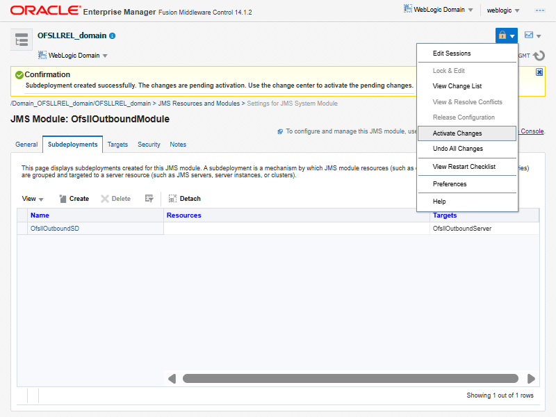

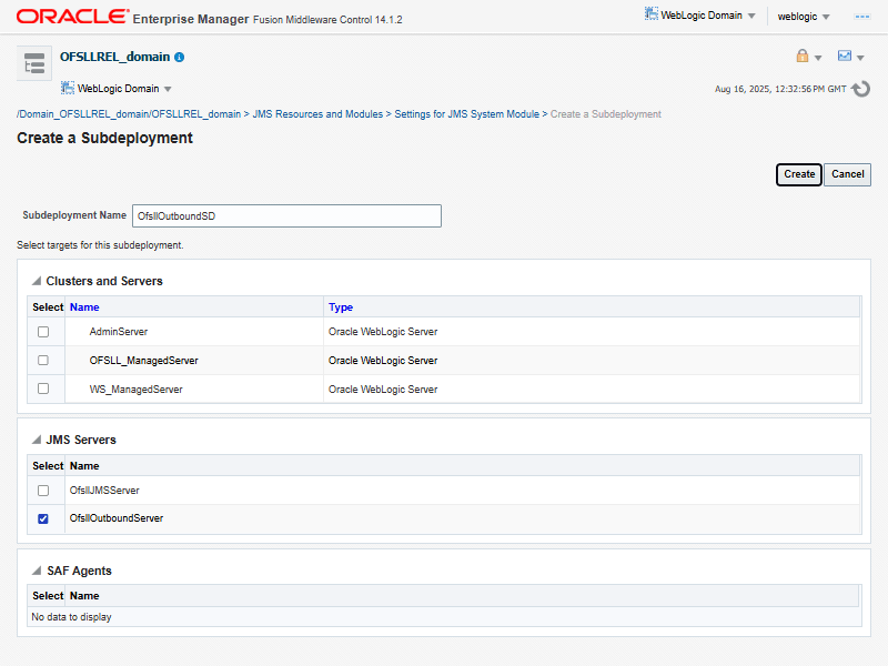

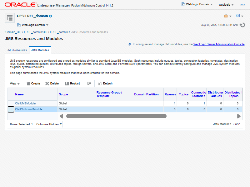

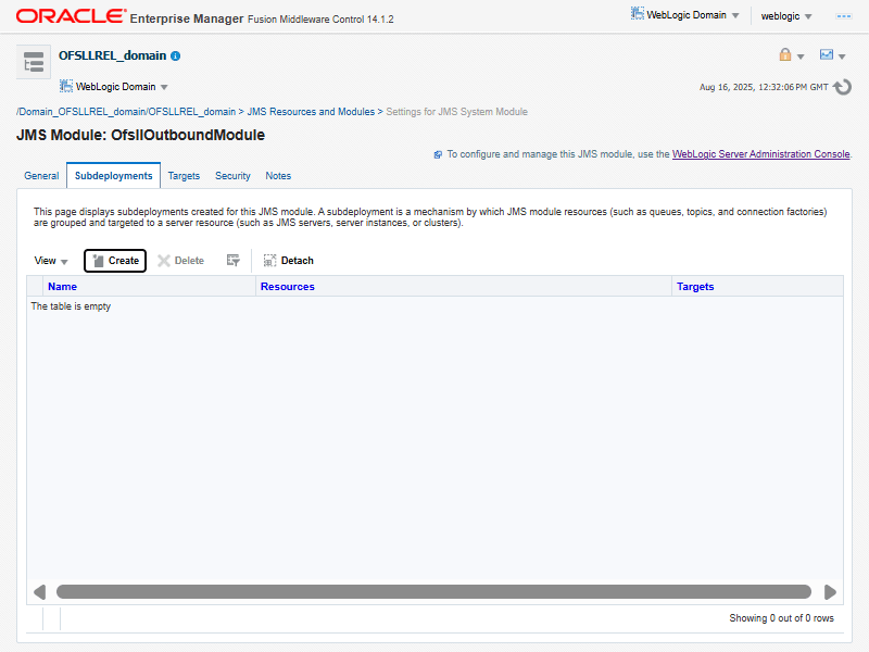

8.3.4 SubDeployment for Outbound Queue Follow the below steps to do subdeployment for outbound queue. Click JMS Modules. The main window displays the list of JMS modules available. Select the created JMS module OfsllOutboundModule. The following window is displayed. Figure 8-43 JMS ModulesDescription of "Figure 8-43 JMS Modules" Click Subdeployments and Click Create.The following window is displayed. Figure 8-44 SubdeploymentsDescription of "Figure 8-44 Subdeployments" Specify the Subdeployment Name as OfsllOutboundSD.The following window is displayed. Figure 8-45 Create a SubdeploymentDescription of "Figure 8-45 Create a Subdeployment" Select the check box against the newly created OfsllOutboundServer and click Create. Navigate to Activate Changes.The following window is displayed. Figure 8-46 Activate ChangesDescription of "Figure 8-46 Activate Changes" Parent topic: Outbound Queue Configuration
