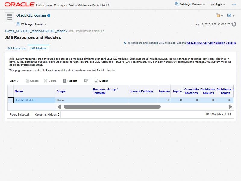

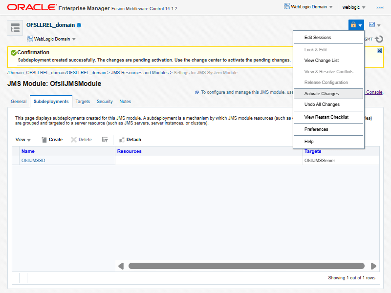

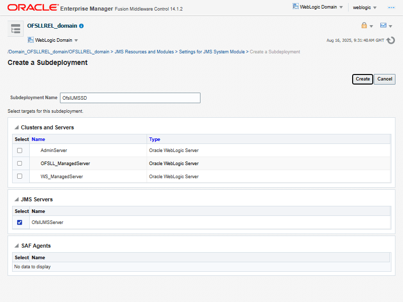

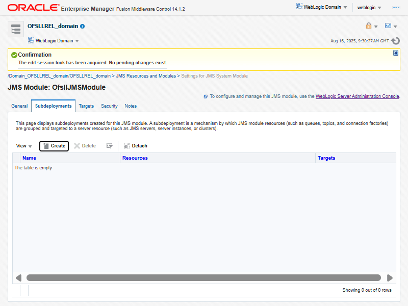

8.2.3 Subdeployment Follow the below steps to do subdeployment. Select the created JMS module OfsllJMSModule. The following window is displayed. Figure 8-4 JMS ModulesDescription of "Figure 8-4 JMS Modules" Navigate Subdeployments. Click Create. The following screen is displayed. Figure 8-5 CreateDescription of "Figure 8-5 Create" Specify the Subdeployment Name as OfsllJMSSD. Select the check box. Click Create. The following window is displayed. Figure 8-6 Create a SubdeploymentDescription of "Figure 8-6 Create a Subdeployment" Click Activate Changes.The following window is displayed. Figure 8-7 Activate ChangesDescription of "Figure 8-7 Activate Changes" Parent topic: AQ-JMS Queue Configuration
