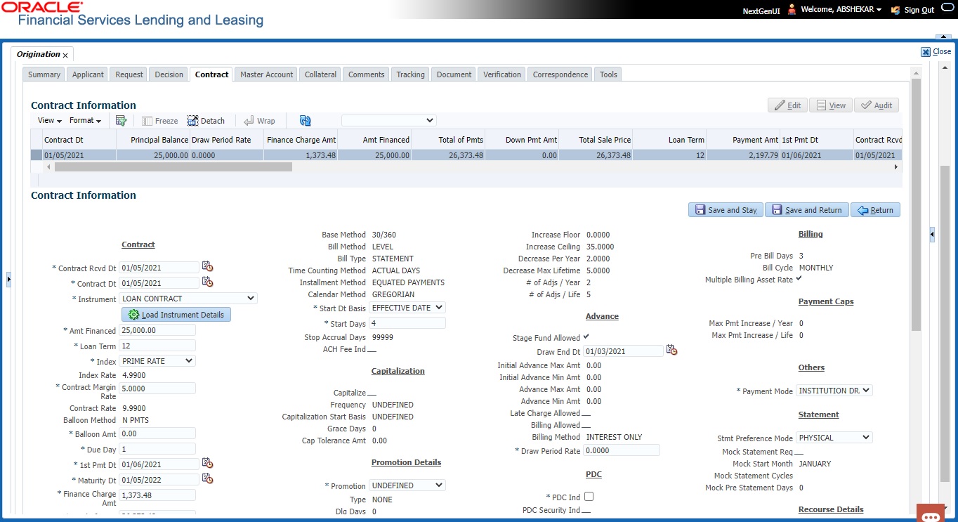

User can use the quick calculator provided with the drop-down list adjacent to the ‘Calculate’ button to calculate the required Loan parameters. User can also use the calculator available in Tools section for completing this step. For detailed information on using the Calculator tools, refer Tools chapter in the document.
While working with the Contract tab for Loan applications, user can either enter the contract details manually or make use of the Suggest option which auto populates the contract and payment details.
- System loads the details of 1st instrument available in Instrument drop-down list.
- Updates the contract date as current GL post date using which all the payment calculations are done.
- Populates decision level contract parameters and Verified By field with User Code.
- Calculates the payment amount.
Since in one click all the required contract information is populated to fund the application, this option helps to improve operational efficiency. But however, this option is not available if the contact instrument is already loaded.

A brief description of the fields is given below:
Table 8-1 Contract Information
Field Description Contract Displays the contract section. Contract Rcvd Dt Specify the contract received date. Contract Dt Specify the contract date. Instrument Select the required instrument from the drop down list and click on Load Instrument Details. Amt Financed Specify the amount financed: the Loan amount applied minus the prepaid finance charges. Prepaid finance charges can be found on the Good Faith Estimate/Settlement (HUD-1 or 1A). For example, if the borrower’s note is for $100,000 and the prepaid finance charge total is $5,000, the amount financed would be $95,000. The amount financed is the figure on which the annual percentage rate (APR) is based. Loan Term Specify the term/number of payments. Index Select the index. Index Rate Displays the index rate. Contract Margin Rate Specify the margin rate. Contract Rate Displays the interest rate. The following 3 fields - Regulatory Name, Regulatory Rate, and Contract Imputed Rate are displayed only if the Imputed Interest check box is selected in Contract Setup (i.e. On the Setup, click Administration under Administration, click Products under Products, click Contract screen).
The value in these fields are automatically populated from setup on selecting a Instrument with imputed interest and clicking on Load Details.
Regulatory Name The regulatory name is populated with the value defined in Setup, click Administration under Administration, click Products under Products, click Regulatory Rates screen. Regulatory Rate The regulatory rate is populated on loading an instrument with the Interest Rate defined for that definition in Setup, click Administration under Administration, click Products under Products, click Regulatory Rates screen.
Note: If there are no matching records with regulatory rate, the Edits (underlying rules) validation fails (if Edits are enabled) and system does not allow to save the contract information.
Contract Imputed Rate Displays the contract imputed rate which is derived based on Contract Rate and Regulatory rate as indicated below:- If Contract Rate - Regulatory Rate = 0, Imputed Rate = 0
- If Contract Rate - Regulatory Rate > 0, Imputed Rate = 0
- If Contract Rate - Regulatory Rate < 0, Imputed rate = Regulatory Rate (minus) Contract Rate.
While funding if the contract Imputed Rate is greater than 0, system automatically calculates Imputed Interest Amortization schedule. For more information, refer to Imputed Interest section below.
Balloon Method Displays the balloon payment method. Balloon Amt Specify the balloon amount. Due Day Specify the due day. 1st Pmt Dt Specify the first payment date. Maturity Dt Specify the maturity date. Finance Charge Amt Specify the finance charge: the amount of interest, prepaid finance charge, and certain insurance premiums (if any) that the borrower will be expected to pay over the life of the Loan. Total of Pmts Specify the total of payments. Down Pmt Amt Specify the down payment amount. Total Sale Price Specify the total sales price. Payment Amt Specify the payment amount. Final Pmt Amt Specify the final payment amount.This amount will be same as that in the Payment Amt field when the installment method is EQUAL PAYMENTS. (required). Repmt Currency Specify the currency to be used for repaying the Loan. Principal Balance Displays the principal balance on the Loan. APR Specify the annual percentage rate: the cost of the Loan in percentage terms taking into account various Loan charges of which interest is only one such charge. Other charges which are used in calculating the APR are private mortgage insurance of FHA mortgage insurance premium (when applicable) and prepaid finance charges (Loan discount, origination fees, prepaid interest and other credit costs). The APR is calculated by spreading these charges over the life of the Loan, which results in a rate higher than the interest rate shown on the mortgage/deed-of-trust note. If interest was the only finance charge, then the interest rate and the annual percentage rate would be the same. Verified Dt Specify the contract verification date. Verified By Displays the user id who verified the contract. Signing Dt Select the signing date on when the documents is signed. Probable Delivery Dt Select the probably delivery date. Note: For Islamic products the following additional fields will be displayed. Residual Income Displays the residual income for the residual days. Residual Days Displays the number of residual days. IRR Displays the interest rate of return. Profit Rate Displays the profit rate (display only). Instrument Details An instrument is a contract with specific rules tied to it. An instrument associated with the application indicates OFSLL of the type of contract being used for the approved loan. Items defined in the contract are locked in when user select the instrument from drop down list and click on Load Instrument Details. These values cannot be changed on the funding screen. Any changes to the instrument in account will be handled by monetary/non-monetary transactions.

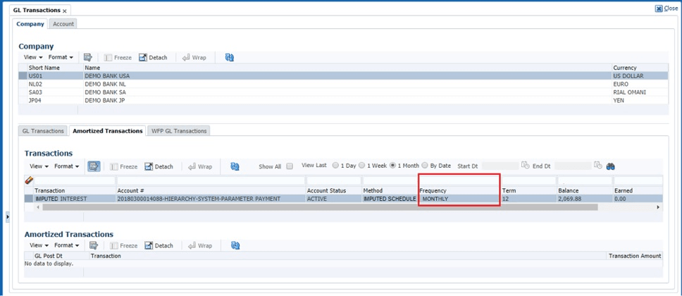

To record the imputed interest amount during loan creation stage, system automatically posts FND IMPUTED INTEREST monetary transaction with total imputed interest amount. In case of loan reversal/cancellation, REVERSE FND IMPUTED INTEREST transaction is posted to post reversal entry on account for imputed interest.
Once the application is funded, the Contract Imputed Rate is propagated to Servicing, click Account Details. Under Account Details, click Contract Information tab.
Figure 8-11 Interfaces-GL Transactions-Imputed Amortization
- Opening balance is updated with total imputed interest amount which is calculated as part of Imputed Interest amortization schedule.
- Transaction = IMPUTED INTEREST, Method = IMPUTED SCHEDULE, and Frequency same as account billing frequency.
If case there is a change in repayment schedule due to change in interest rate, then respective imputed interest rate also changes since the principal changes. Along with this, if there is an early Payoff or account Charge-off, the remaining unearned imputed interest is written-off. On posting monetary transactions which changes the repayment schedule such as Due Date Change, Due Date Change Override, Change Term and so on, system recalculates imputed interest amortization schedule along with repayment schedule and posts an Imputed Interest amortization adjustment transaction.
