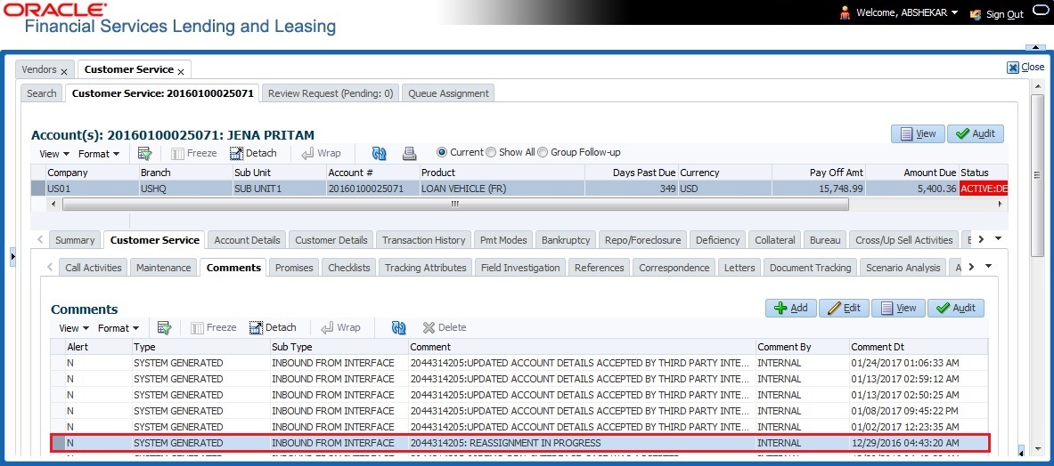

A comment is posted on the corresponding account in Customer Service, click Comments tab, with the following details:
  • Type = SYSTEM GENERATED
  • Sub Type = INBOUND FROM INTERFACE
  • Comment = NEW CASE NO: “<<CASE REASSIGNMENT REQUEST ACCEPTED BY THIRD PARTY INTERFACE >>”
  • Comment By = “INTERNAL”
In case of an error in the web service response received from third party system, following details are posted as a comment against the account and the work status is not updated nor a new work order is created with new assigned vendor.
  • Comment = CASE NO: “<<CASE REASSIGNMENT REQUEST NOT UPDATED IN THIRD PARTY INTERFACE >>”
  • Comment Dt = Comment Posted date
