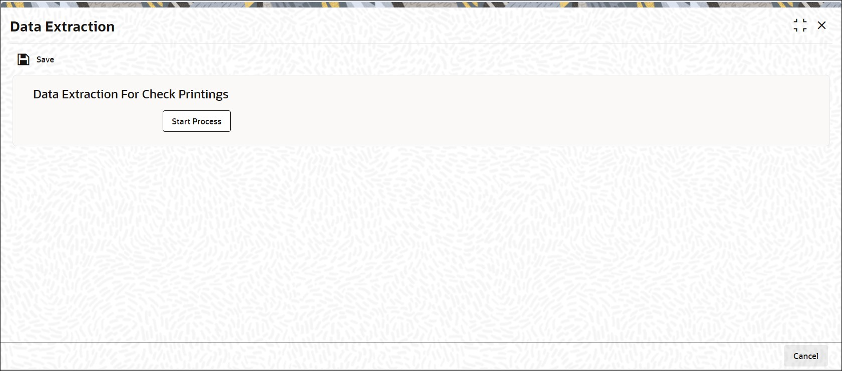

  1. On Home screen, type UTDDTEXT in the text box, and click Next.
    The Data Extraction screen is displayed.
  2. On Data Extraction screen, click New to enter the details.

    Data Extraction for Check Printings Optional
    The extraction of data for the generation of pay-in slips on a given date retrieves all transactions in a fund, (subscriptions or IPO) for which a payment has been received from the unit holder, as on the given date.
  3. Click Start Process to start the data extraction process.
