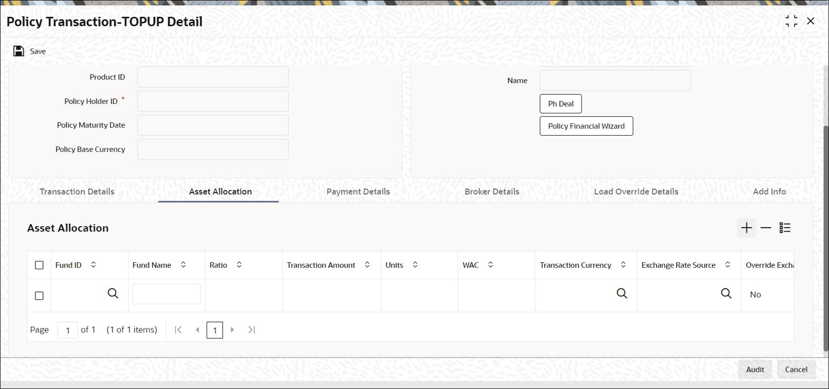

  1. On Policy Transaction-TOPUP Detail screen, click Asset Allocation tab.
    The Asset Allocation details are displayed.
    Figure 3-5 Policy Transaction-TOPUP Detail_Asset Allocation Tab
  2. Capture the fund-wise pattern of distribution of the investment amount in the Asset Allocation Details section of this tab. If the initial contribution that you enter is in different currencies, you need to mention the currency-wise details here.
  3. On Asset Allocation tab, specify the fields.
