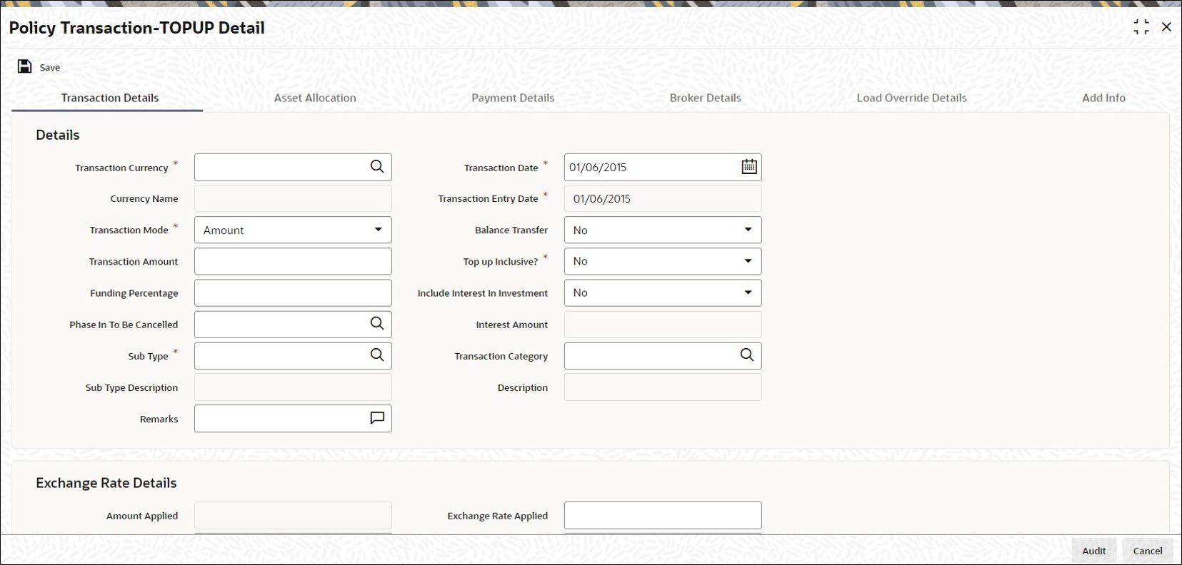

  1. On Policy Transaction-TOPUP Detail screen, click Transaction Details tab.
    The Transaction Details are displayed.
    Figure 3-4 Policy Transaction-TOPUP Detail_Transaction Details Tab
  2. On Transaction Details Tab, specify the fields.
