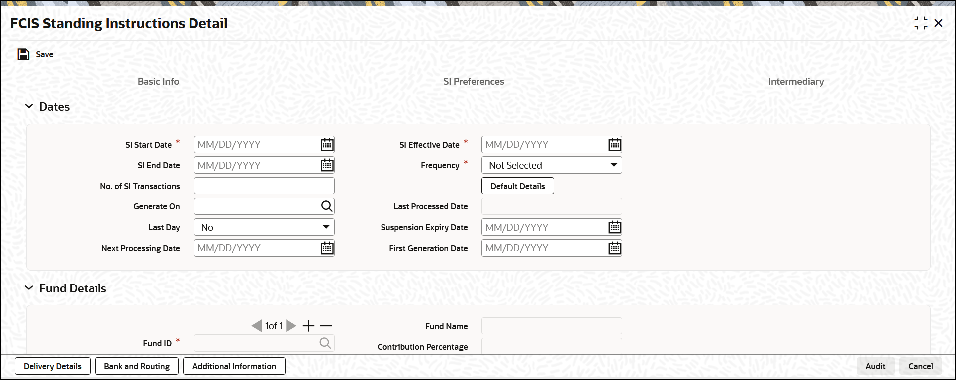

1.1.1 Basic Info
This topic explains the basic information tab of FCIS Standing Instructions Detail.
- On the FCIS Standing Instructions Detail screen, click on Basic Information tab to enter the details.The Basic Information details are displayed.
Figure 1-2 FCIS Standing Instruction Detail - Basic Information
- On Basic Information tab, specify the fields. For more information on fields, refer to the field description below,
Table 1-6 Basic Information - Field Description
