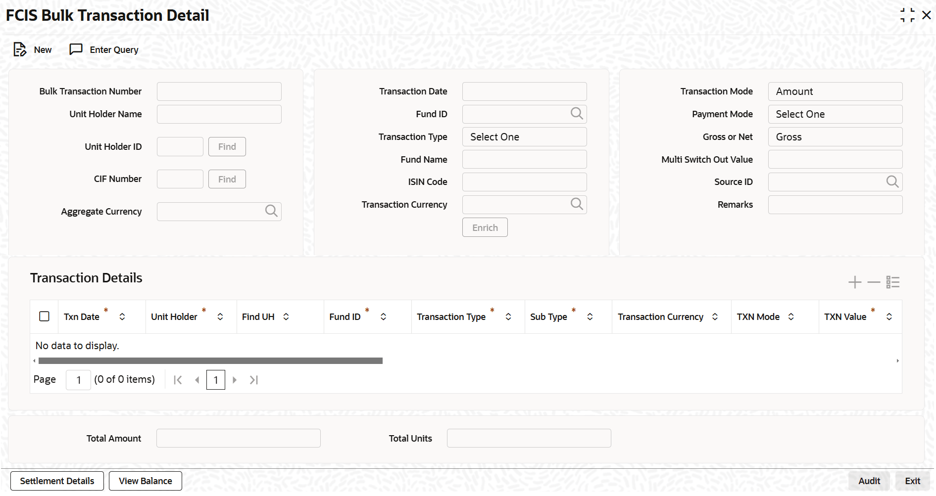

3.6.1 Process FCIS Bulk Transaction Detail
This topic provides the instructions to process FCIS Bulk Transaction Detail Screen.
You may need to enter multiple transactions in multiple funds for a unit holder.
- On Home screen, type UTDTXNB in the text box and click Next.The FCIS Bulk Transaction Detail screen is displayed.
- On FCIS Bulk Transaction Detail screen, specify the fields.For more information on fields, refer to the field description table.

Field Description Bulk Transaction Number Display When you save the multiple transactions that you have entered in this screen, a bulk transaction number is generated by the system for each set of multiple transactions entered. You can use the bulk transaction number to retrieve the transactions, in the FCIS Bulk Transactions Summary screen.
Unit Holder Name Display The name of the unit holder is displayed.
Unit Holder ID Alphanumeric; 12 Characters; Optional Specify the unit holder ID. You can also click the Find button to list the unit holder IDs maintained in the system. Select the required ID.
CIF Number Alphanumeric; 20 Characters; Optional Specify the CIF number of the unit holder for whom you wish to enter multiple transactions.
You can also click the Find button to list the CIF number maintained in the system. Select the required ID.
