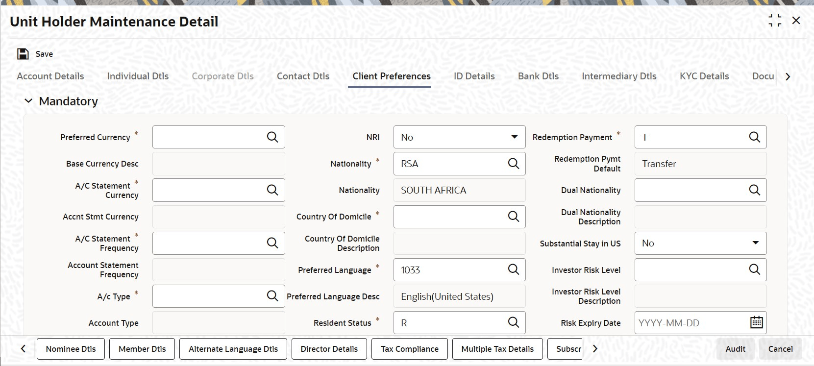

2.2.5 Client Preferences Tab
This topic provides the systematic instructions to specify the client preferences for corporate investors in the Unit Holder Maintenance Detail screen.
  1. On Unit Holder Maintenance Detail screen, click Client Preferences tab.
    The Client Preferences details are displayed.
    Figure 2-6 Unit Holder Maintenance Detail_Client Preferences Tab
  2. On the Client Preferences tab, specify the fields.
