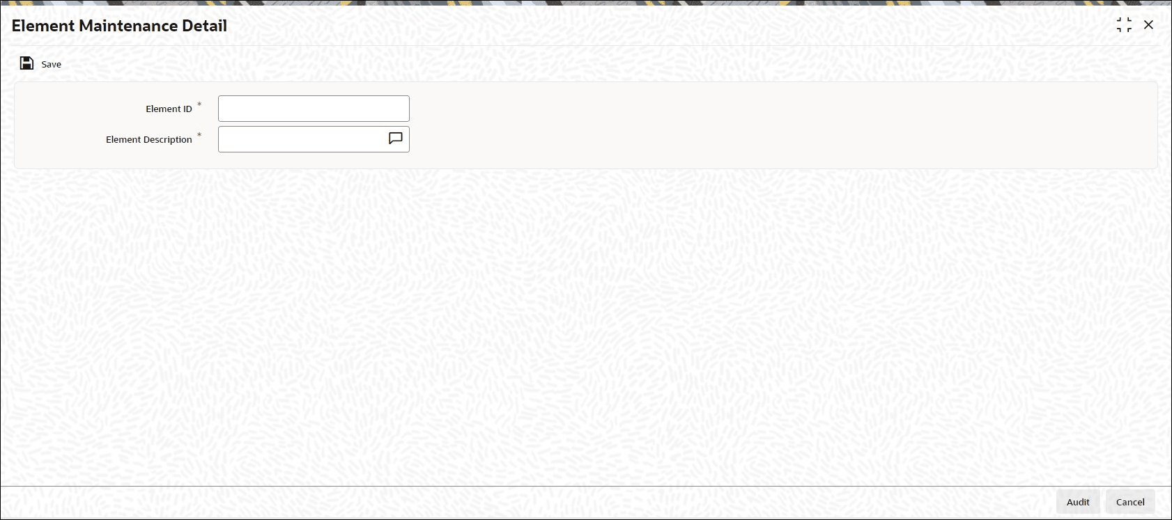

You can capture the details related to derived data elements in Element Maintenance Detail screen.
- On Home screen, type UTDENMNT in the text box, and click Next.The Element Maintenance Detail screen is displayed.
- On Element Maintenance Detail screen, click New to enter the details.For more information on fields, refer to the field description table.
Table 2-64 Element Maintenance Detail - Field Description
Field Description Element ID Alphanumeric; 20 Characters; Mandatory
Specify a unique code to identify the data element.
Element Description Alphanumeric; 255 Characters; Mandatory Specify a suitable description for the element.
