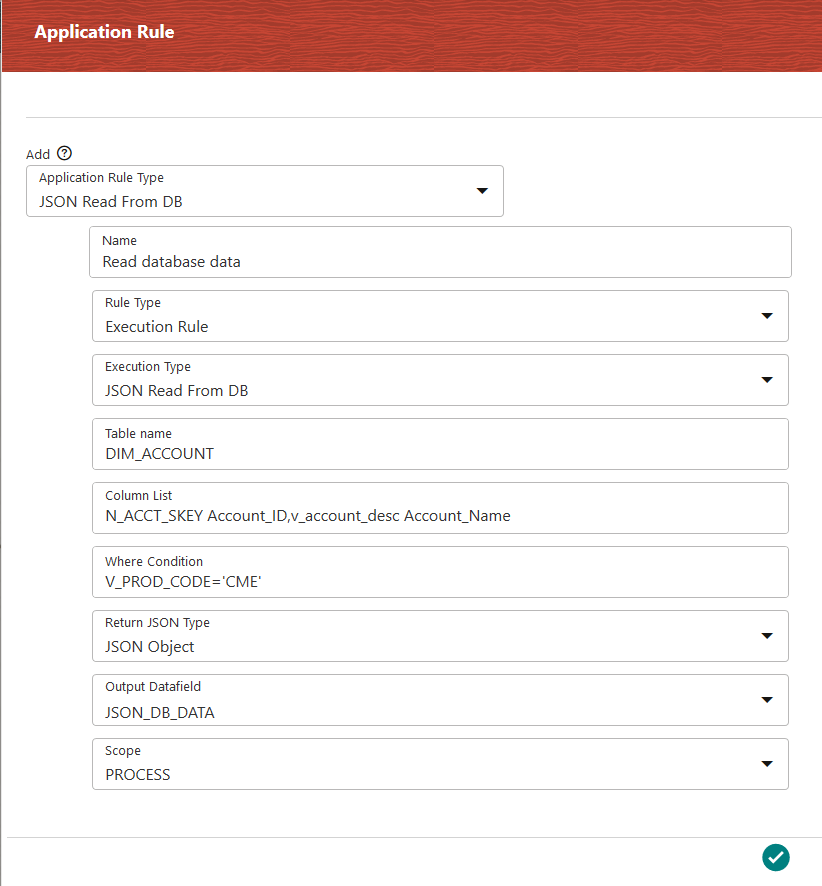

Before invoking Web Service, we need to prepare data to be passed across to the Web Service. This can be done by configuring the Application Rule.
In the above example, data preparation is done through JSON Read From DB Application Rule as shown below, which reads data from a table, converts it into JSON, and stores output to JSON_DB_DATA Data Field.
Figure 9-2 Add API Details
This image displays the Add API Details.
For more information, see JSON Read From DB Application Rule section.
