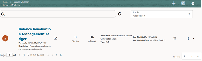

- From OFSAA Home, select the Financial
Services Balance Computation Engine, select the
Administration. In the Information Domain list,
select the information domain required for OFSBCE. Then click the
Process Modelling Framework tile. A submenu is
displayed. To access the Process Modeller, click Process
Modeller. The Process Modeller page opens. In the following
illustration, the out of the box Balance Revaluation Management Ledger Process
is shown.

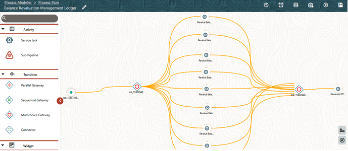

- The corresponding process flow is displayed. This process flow is designed
using the drawing canvas with the Transition, Activity, and Widgets components
available in the floating toolbar and with Service Task as the base. Each
Service Task represents GL type for Assets, Liabilities, Expenses, Revenue,
Gains, Losses, Contra Asset, Contra Liability, and Owner’s Equity. The tasks are
repeated in the Run for each General Ledger Type and are executed in parallel.
You can set up which of these tasks must be executed in the Revaluation Settings section.
Figure 9-20 Balance Revaluation Management Ledger process flow

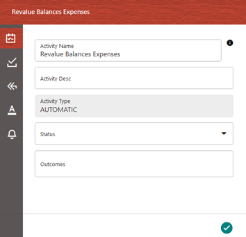

- Double-click a Service task to see the details related to its Activity,
Implementation, Transitions, Actions, and Notifications. To save the details,
click Save icon.
Figure 9-21 Balance Revaluation Management Ledger process with Service Task details

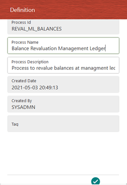

- Click Edit icon to open the Definition details.
To save the details, click.
Figure 9-22 Balance Revaluation Management Ledger process with Definition details

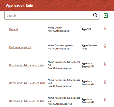

- Click the Appilcation Rule icon to open the
Application Rule details. You can add or modify or delete the Rule
details.
Figure 9-23 Balance Revaluation Management Ledger process with Application Rule tab details

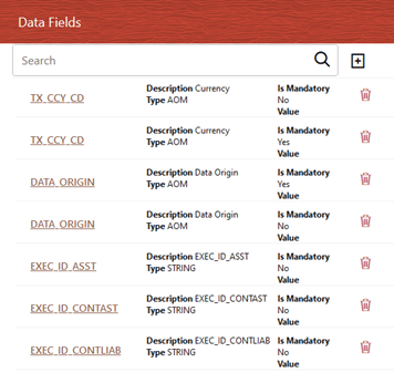

- Click the Data Fields icon to open the Data
Fields details. Add, modify, delete, or view the Data Fields
details.
Figure 9-24 Balance Revaluation Management Ledger process with Data Fields details

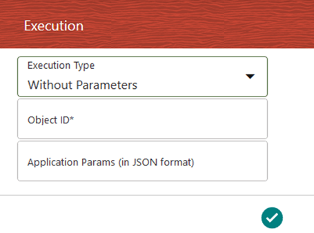

Figure 9-25 Balance Revaluation Management Ledger process without Execution Parameters
- Enter and select the required details to execute the Run without

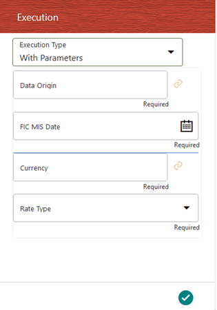

parameters. To execute with parameters, select With
Parameters in the Execution Type
list. To save the details, click Save icon.
Figure 9-26 Balance Revaluation Management Ledger Process with Execution Parameters
The values are fetched from the FSI_EXCG_RATES and SETUP_MASTER tables. - Select or enter the required values for each field as follows.
Table 9-3 Balance Revaluation Management Ledger Process - Execution Page With Parameters and description
Field Name Description or Instruction FIC MIS Date Use the calendar icon to select the extraction date. Currency Use the Selection icon to select the Currency Code used to calculate the amount during the data population in the target table. Data Origin Use the Selection icon to select the required Data Origin from the Available Values list and click OK. Rate Type Select the Rate Type from the drop-down list. The options are as follows: - Average
- Daily
- End of Period
To save the details and execute the run, click Save icon.

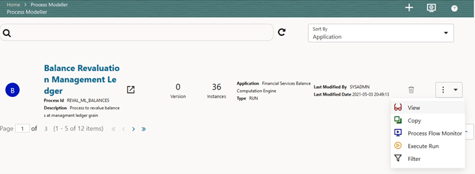

- In the Process Modeller page, click corresponding to the
Balance Revaluation Management Ledger Run process that must be executed. Click
Execute Run.
Figure 9-27 Balance Revaluation Management Ledger process - Select Execute Run

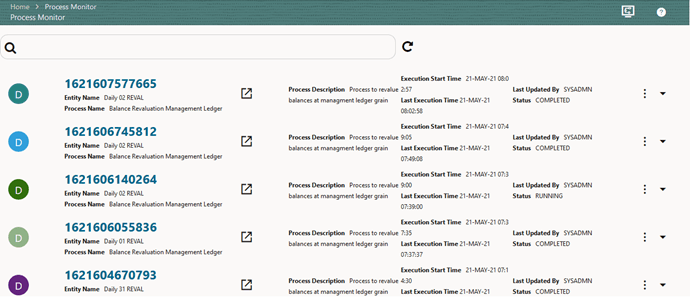

- To open the Process Monitor page, in the Process Modeller page, click Process Flow Monitor icon or select Process Flow Monitor from the Process Modeller menu.
- The Process Monitor page opens displaying all
the Run instances corresponding to the Balance Revaluation Management
Ledger process. In the Process Monitor page, for the required Run
pipeline (process) that was executed, search the Run instance by Process
ID, or by the Process Name Balance Revaluation Management
Ledger, and select the process instance for the required
Run pipeline (process) that was executed. .
Figure 9-30 Balance Revaluation Management Ledger Process – Process Monitor Page – Select Job ID
