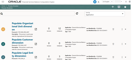

- 1. From OFSAA Home, select the Financial
Services Balance Computation Engine, then select
Orchestration, select Process
Modeller. The Process Modeller page is displayed.

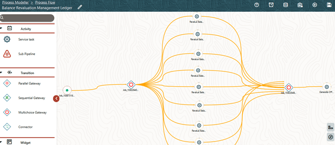

- In the Process Flow canvas page, design a Revaluation Process flow Run
pipeline. By default, START from the toolbar appears. This Start activity
indicates the beginning of the process. The Process Flow tab contains a floating
toolbar and a drawing canvas. Use the drawing canvas to design the process flow
with the Activity, Transition, and Widget components available in the toolbar.
In the illustration, each Service Task represents GL type for Assets,
Liabilities, Expenses, Revenue, Gains, Losses, Contra Asset, Contra Liability,
and Owner’s Equity set in the Revaluation Settings section.
For more information, see the Service Tasks section in the Oracle Financial Services Analytical Applications Infrastructure Process Modelling Framework Orchestration Guide Release 8.1.1.0.0
Figure 7-4 Creation of Balance Revaluation Management Ledger process flow
Revaluation Management Ledger pipeline must be executed only once for an As of Date for a given set of input. - Click the Save icon to save the Revaluation Process Flow.

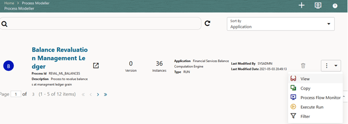

- The Revaluation Process is listed in the Process Modeller page. To select the
Run parameters and execute the Run, follow these steps:
- In the Process Modeller page, click the More
icon corresponding to the Revaluation Process Run Pipeline that needs to
be executed.
Figure 7-5 Balance Revaluation Management Ledger process - Select Execute Run
be executed.

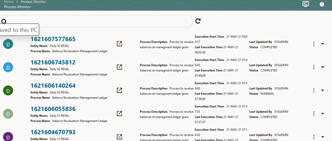

- To open the Process Monitor page, in the Process
Modeller page, click or select Process Flow Monitor
from the Process Modeller menu.
Figure 7-8 Process Monitor Menu
- The Process Monitor page is displayed listing all the Run instances
corresponding to the Balance Revaluation Management Ledger process. In
the Process Monitor page, search by Process ID, or by the
Process Name Balance Revaluation Management
Ledger, and select the process instance for the required
Run pipeline (process) that was executed.
Figure 7-9 Balance Revaluation Management Ledger Process – Process Monitor Page – Select Job ID
- A status is displayed, which shows the execution status of the executed Run for
the Balance Revaluation Management Ledger process. In this illustration, the Run
for the Revaluation is successfully executed.
Figure 7-10 Balance Revaluation Management Ledger process – Run Execution status
