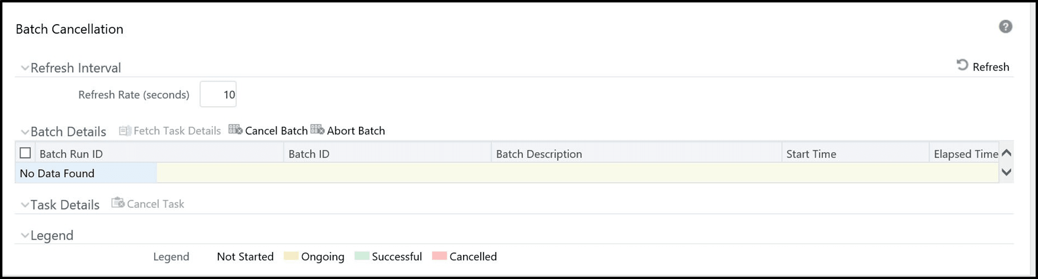

    The Batch Cancellation page is displayed.
    Figure 10-6 Batch Cancellation Page
  4. Under the Batch Details section, select the batch whose execution you want to cancel.
  5. Click Cancel Batch.
