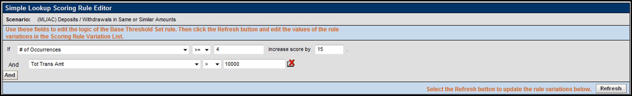

Simple Lookup Scoring Rule Editor
When you click Add or Update in the Simple Lookup Scoring Rule List and filter by Scenario, or click Update when filtering by Scenario Class, the Simple Lookup Scoring Rule Editor with Scoring Rule Variation List displays.
The Simple Lookup Scoring Rule Editor allows you to add and update rules (depending on filtering by Scenario Class or Scenario) that, when in a match’s information, result in incrementing a match’s score by a standard value.

- Match Attribute drop-down list: Contains a value for each
binding description associated within each pattern and a matched record within
the selected Scenario Class (if you are updating a rule for a Scenario Class),
or a value for each binding description and matched record (displays in
table.column format) associated with patterns within the selected Scenario (if
you are adding or updating a rule for a single Scenario). The values display in
ascending alphabetic order.
If you select Add, the first option in the Match Attribute drop-down list displays as the sample value.
If you select Update, the current match attribute for the selected rule displays in the Match Attribute drop-down list field.
- Match Record Strategy drop-down list: Displays Min, Max and Sum. This is enabled only if you choose a matched record from the Match Attribute drop-down list. The value of the match record strategy is displayed in Parenthesis beside the matched record after selection of the value. This is mandatory to be selected for any matched record being selected in the Match Attribute drop-down list.
- Operatordrop-down list: Contains the values <, <=, >, >=, =, and
If you select Add, the Operator drop-down list displays = as the default.
If you select Update, the Operator drop-down list displays the current Operator for the selected rule
. - Value text box: Displays a value as an enumerated figure
or range to associate to the selected value in the Match Attribute drop-down
list.
If you select Add, the Value text box displays the text Value.
If you select Update, the Value text box displays the current value entry for the selected rule.
- Scoretext box: Displays a value assigned to matches that meet all rule
criteria.
If you select Add, the Score text box displays the text Score.
If you select Update, the Score text box displays the current score entry for the selected rule.
The score can be any numeric value, less than, greater than, or equal to zero (0) and less than or equal to the application’s Maximum Match Score.
For example, you can create range-based scoring rules using negative values in the Score field: To get 10 points for a value between 100 and 500, use:
Rule 1: If the value is greater than or equal to 100, then add 10 points to the Score field. Rule 2: If the value is greater than 500, then add negative 10 (-10) points to the Score field. To reduce the score when high amounts are involved, use:
Rule1: If the value is greater than 10,000,000, then add negative 50 (-50) to the Scorefield.
You can also combine this with the Graduated Lookups to get a below minimum that adds nothing to the alert, but you do not have to start the range at zero (0).
- And button: Allows you to add multiple filters for a rule using. This is optional for a rule definition. You can add xnumber of filters for a rule, where x is a configurable parameter in config.xml.

You can enter negative values by changing the scoring increment to a negative value. For example you would have two simple lookup rules as follows:- If <binding name 1> = 50, increase score by 10 If <binding name 2> = 100 increase score by -5
- If for a particular match, "binding name 1" had a value of 50 and "binding name 2" had a value of 100, the final score would be 5.
