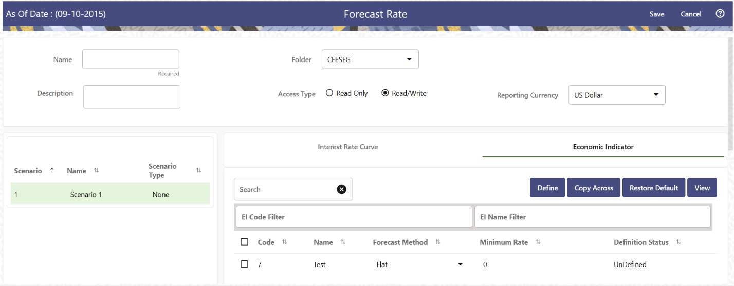

Figure 2-3 Economic Indicator Forecast Rates
Following options are available for Economic Indicator Forecast Rule:
Define
- Flat Method
- Select Economic Indicator Code using corresponding checkbox, select Forecast Method as Flat and enter minimum rate.
- Click Define. The status of Economic Indicator Code is changed to Defined.
- Direct Input
- Select Economic Indicator Code using corresponding checkbox, select Forecast Method as Direct Input and enter minimum rate.
- Click Define.
The Direct Input window is displayed:
- Enter data and click Apply.
- The status of Economic Indicator Code is changed to Defined.
