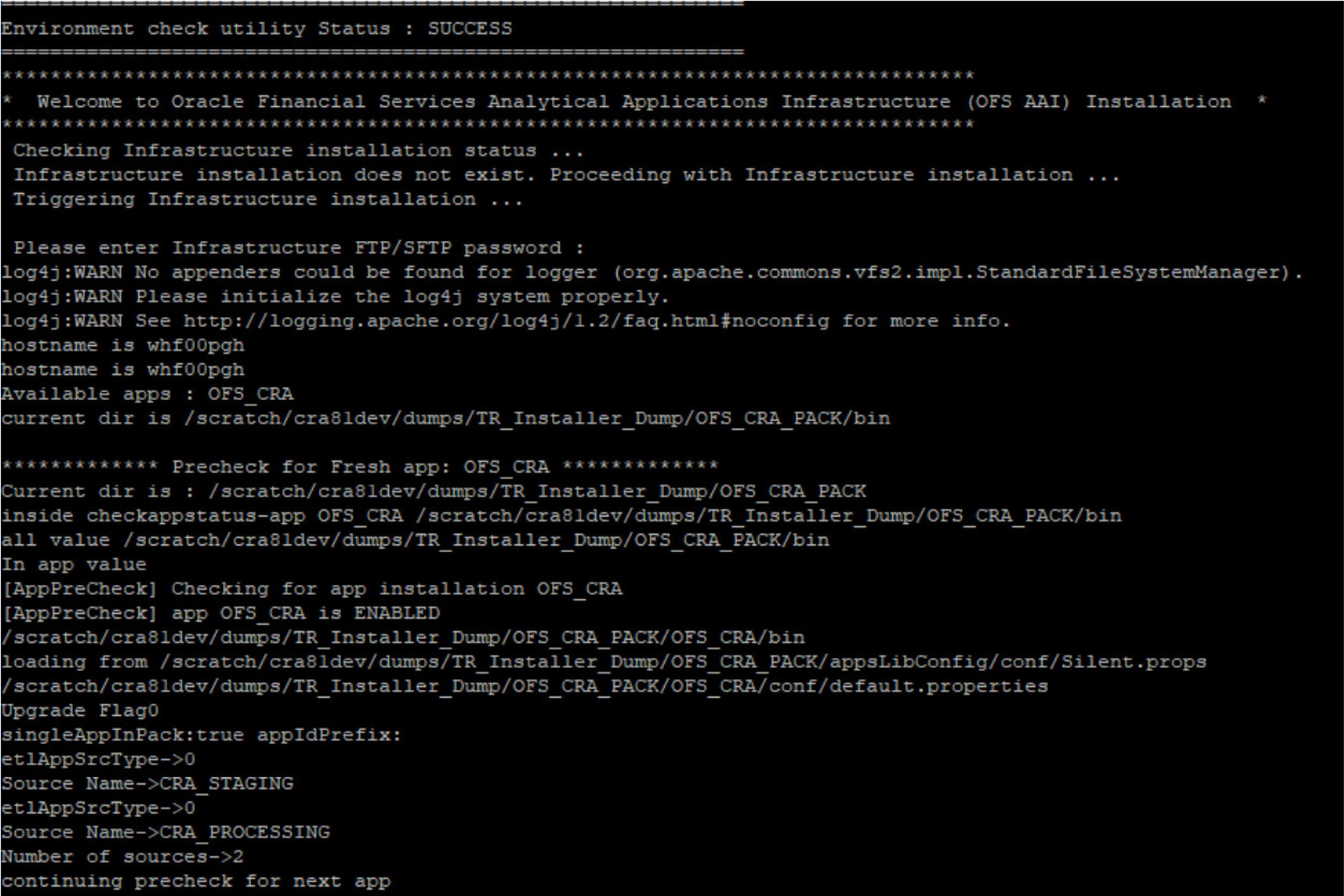

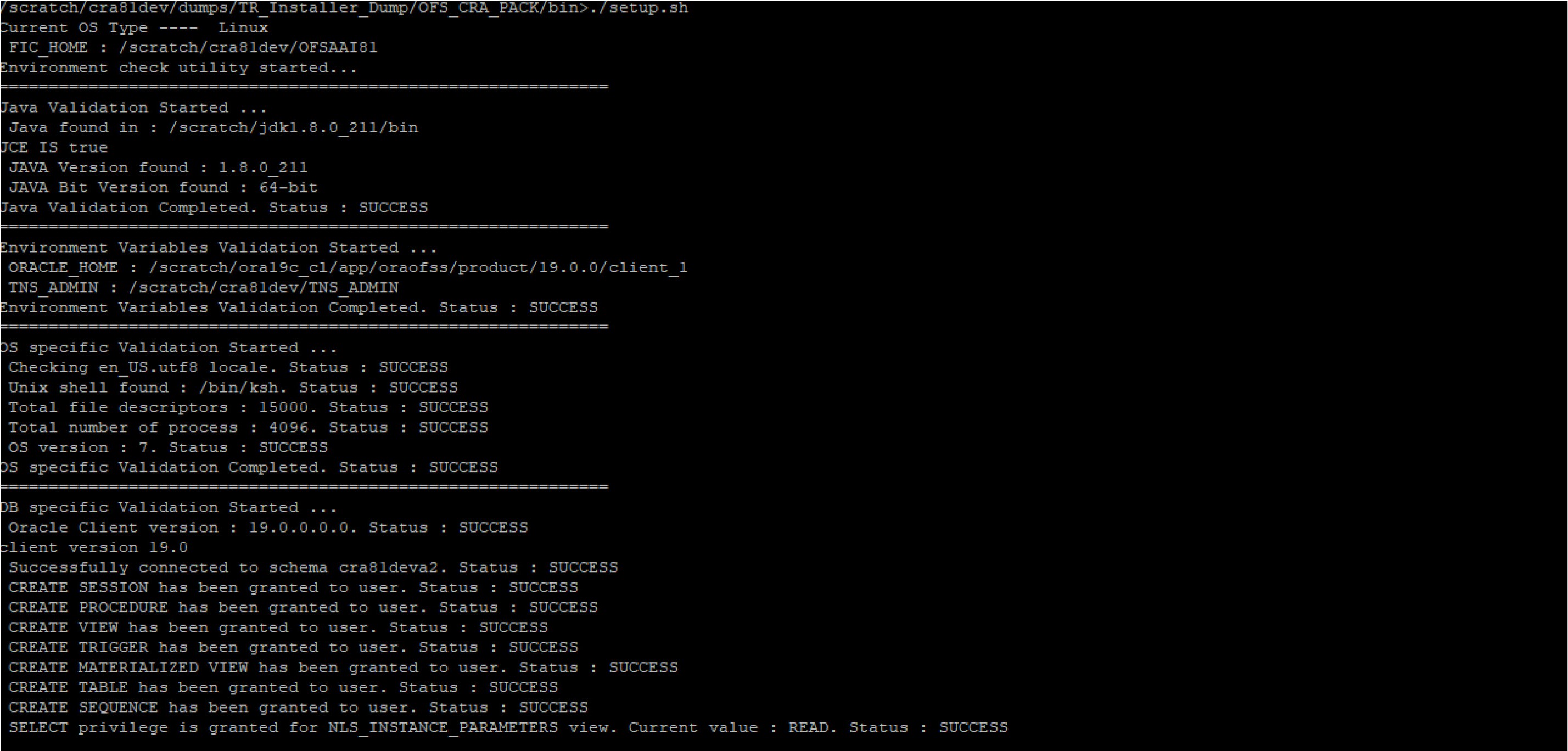

  9. Enter the following command in the console to execute the Application Pack Installer with the Silent Option.
    ./setup.sh
  10. The installer proceeds with Pre-Installation Checks.

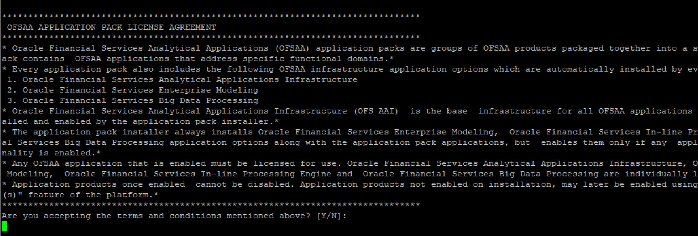

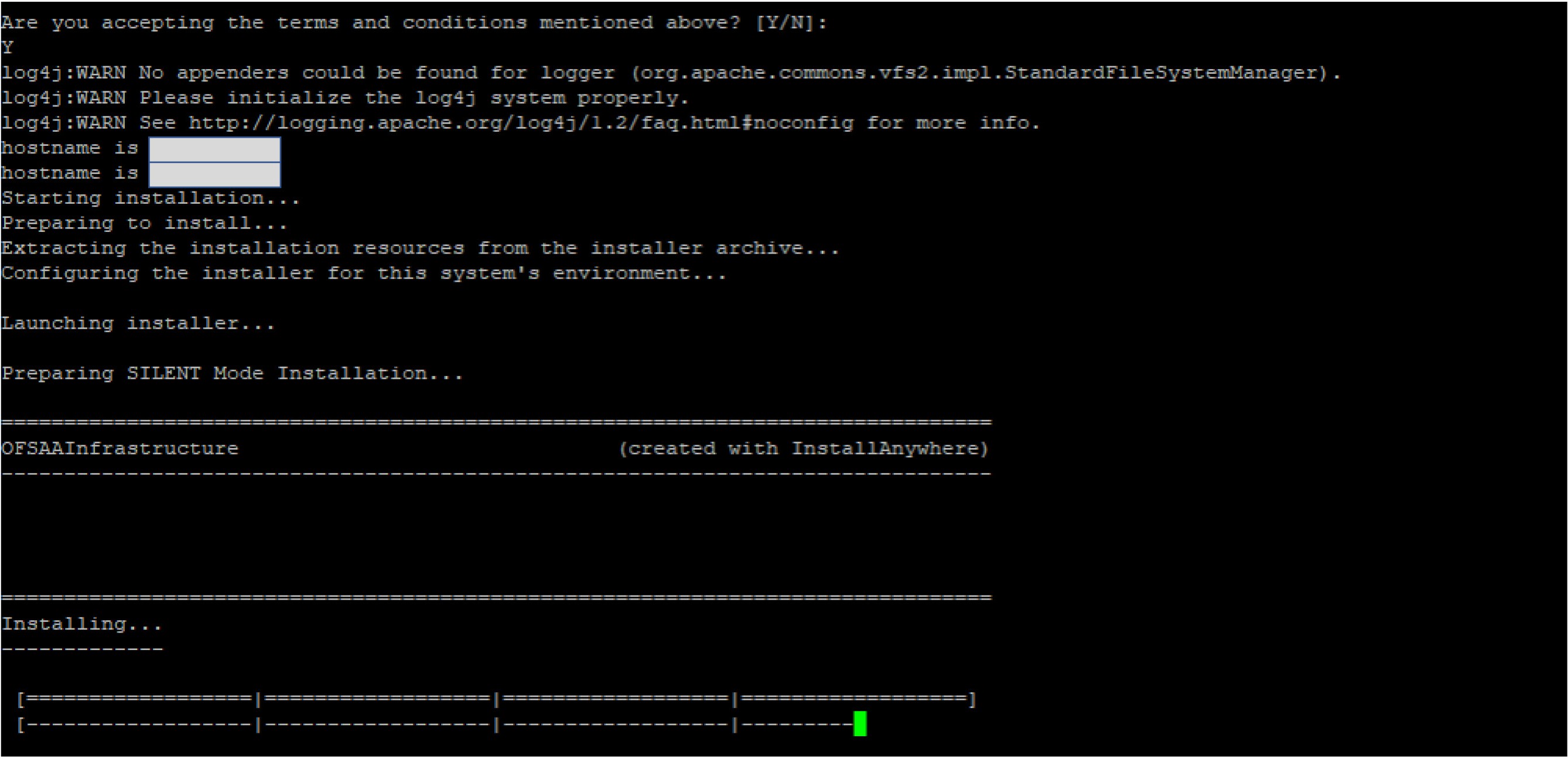

  12. The process displays the OFSAA License. Enter Y and proceed.
    Figure 6-17 Accept the OFSAA License Agreement
    Description of Accept the OFSAA License Agreement follows This illustration shows the OFSAA License Agreement prompt during the installation.

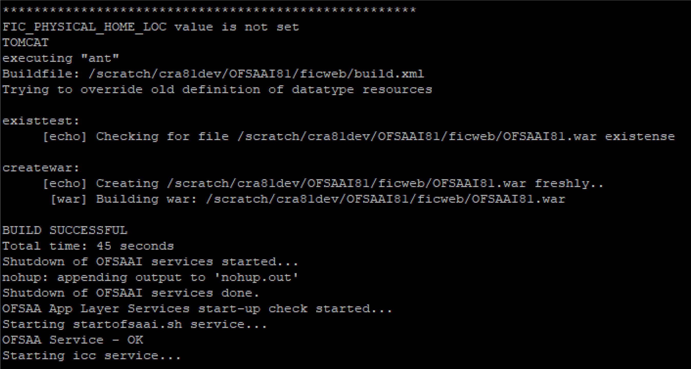

  13. The installer installs the AAI application.
    Figure 6-18 OFSAA Silent Mode Installation
    Description of OFSAA Silent Mode Installation follows This illustration shows the OFSAA silent mode installation.

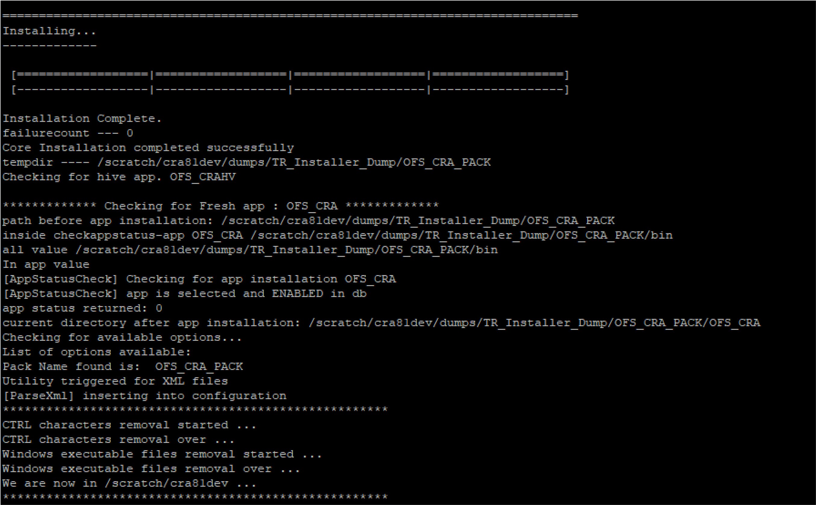

  14. After the platform is installed, the OFS CRA installation begins.
    Figure 6-19 CRA Silent Mode Installation
    Description of CRA Silent Mode Installation follows This illustration shows the OFS CRA installation.

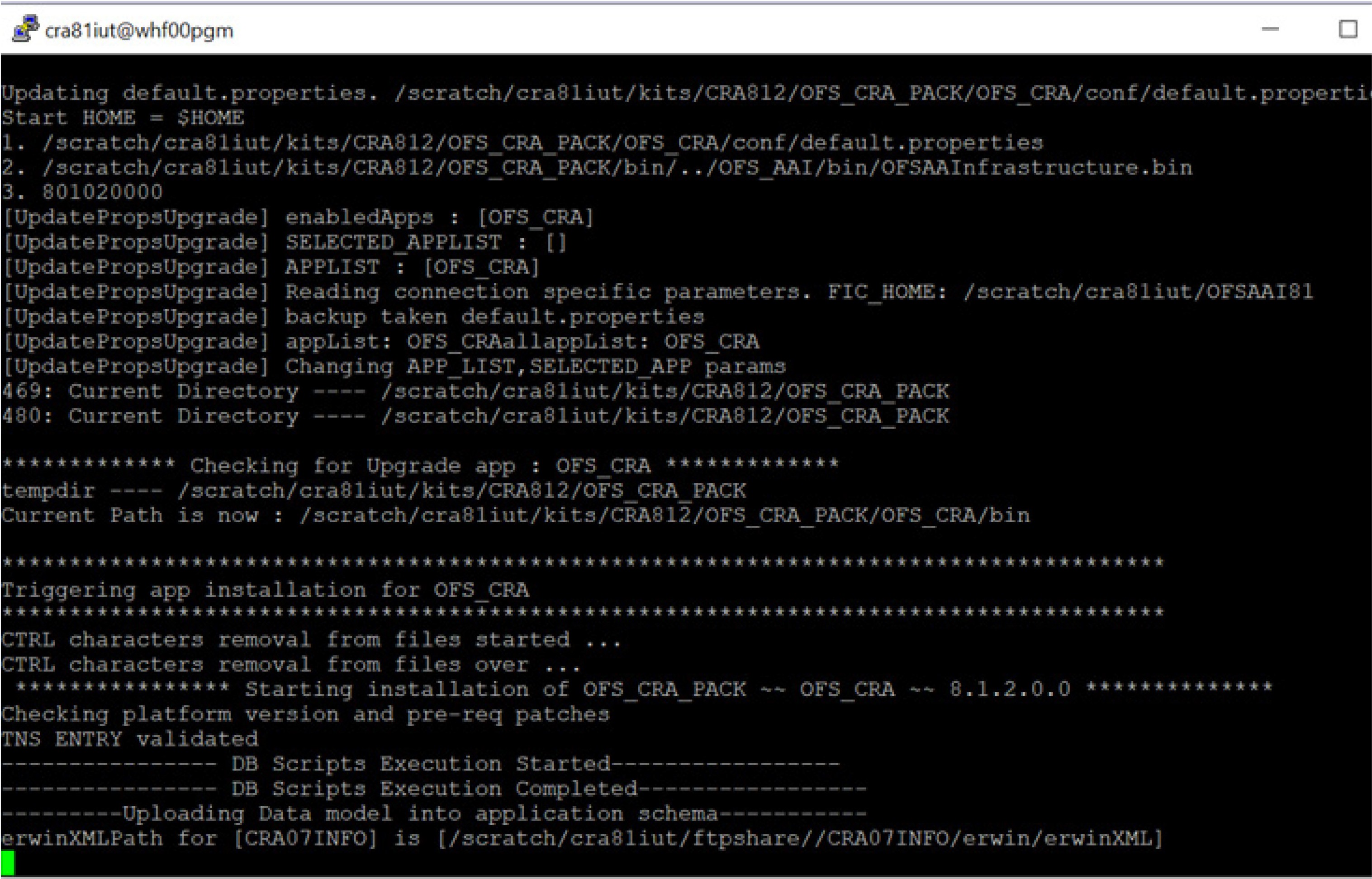

  15. After Data Model Upload is complete, verify the installation logs in the log directories mentioned in the Verify the Log File Information Section.
    Figure 6-20 Silent Mode Installation In Progress
    Description of Silent Mode Installation In Progress follows This illustration shows the OFS LRS installation.

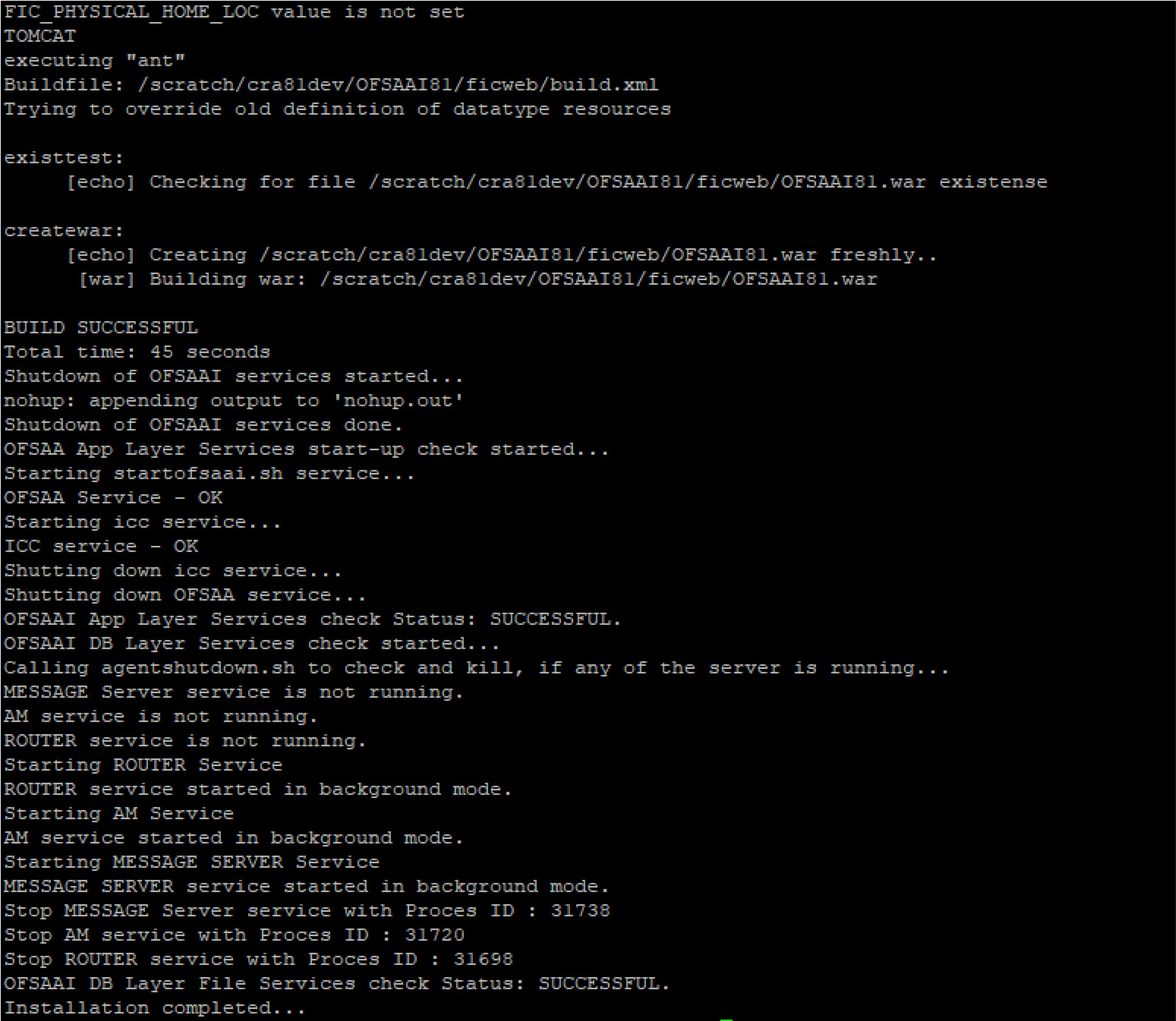

    Figure 6-21 Silent Mode Installation Build Successful
    Description of Silent Mode Installation Build Successful follows This illustration shows the OFS LRS installation - Build Successful message.
  16. After successful CRA Pack Installation, the WAR file is generated and all the servers are verified and the installation complete message is displayed.
    Figure 6-22 Silent Mode Installation Complete
    Description of Silent Mode Installation Complete follows This illustration shows successful completion of the OFS LRS installation.
