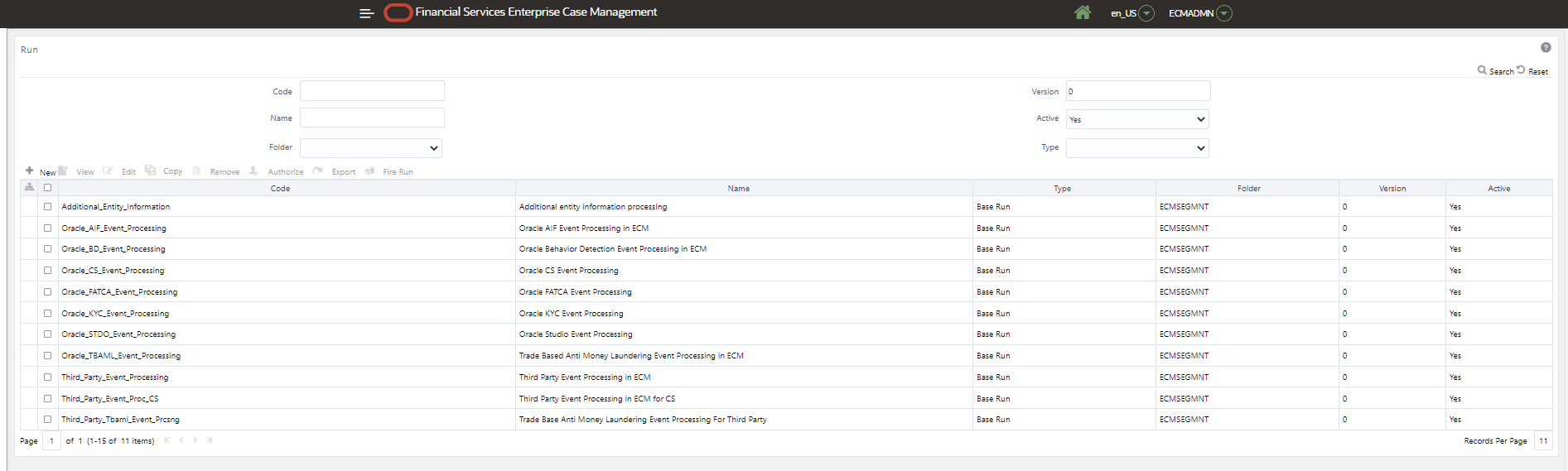

For executing a batch, you cannot start two batches simultaneously for the same processing group.- Navigate to Enterprise Case Management Application.
- Go to the Common Tasks section. Select the Rule Run Framework.
- Click Run. The Run window is displayed with the available
Processes.

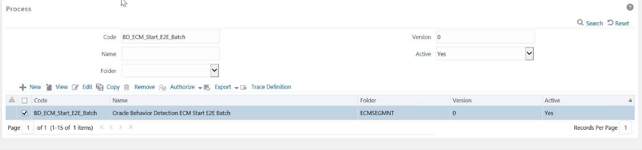

- Navigate to Process Summary Page and search for BD_ECM_Start_E2E_Batch.
- Select the batch BD_ECM_Start_E2E_Batch and click Edit.

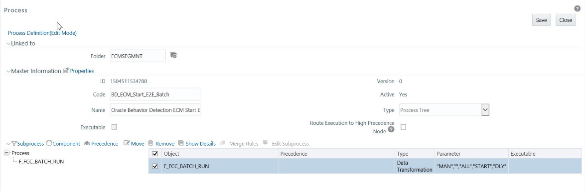

The Process Definition page is displayed.
Figure 6-4 Process Definition page
- Click Component. The Component Selector window is displayed.
- Under the Tasks In ROOT section, right-click on the required batch,
and then click Add Parameters. The Parameters window is
displayed.
Figure 6-5 Parameters
The following are default parameters: "MAN","","ALL","START","DLY".

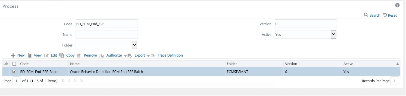

- Navigate to the Process Summary page and search for End Batch, for example:
BD_ECM_End_E2E.
Figure 6-6 Process
- Select the batch, and click Edit. The Process Definition page is displayed.

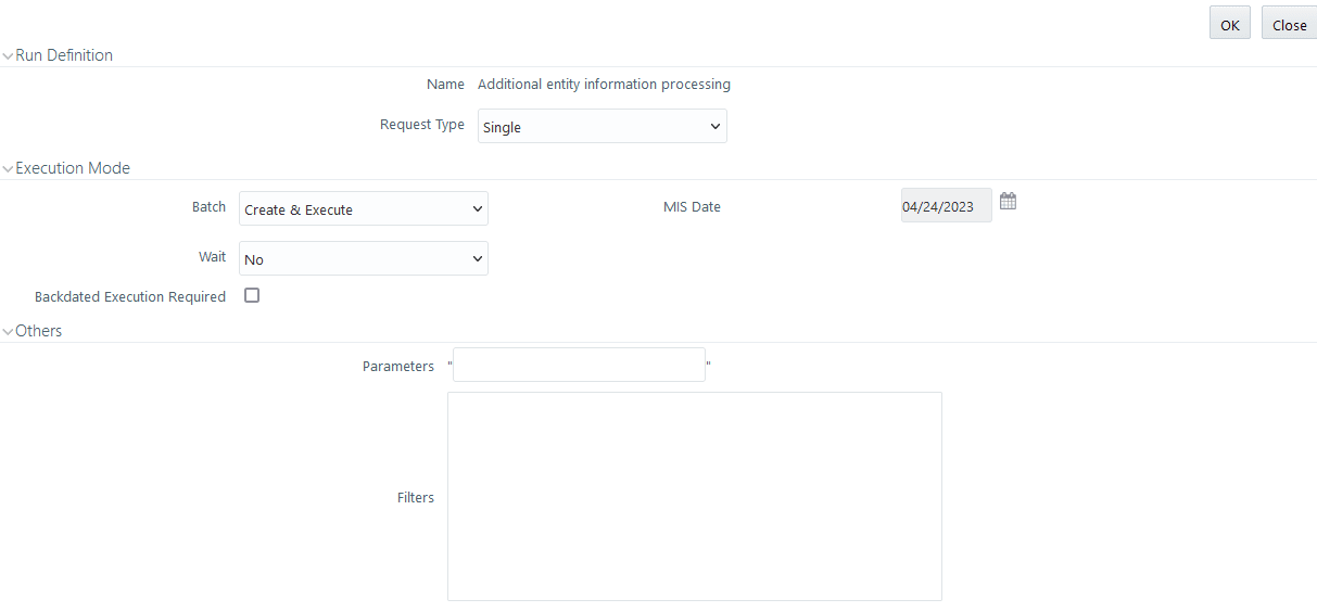

- Select the Application process from the Run definition page list that is to
be executed and click Fire Run. The Fire Run window is displayed.
Figure 6-7 Fire Run window
- Enter details as described in the following table:
Table 6-1 Adding Fire Run Details
Fields Description Request Type Select Request Type based on the following options:
- Single: If the batch must be executed once.
- Multiple:If the batch must be executed multiple times at different intervals.
Batch Select Batch. It has the following options:
- Create
- Create &Execute
From these options, select Create & Execute
Wait Select Wait. It has the following options:
- Yes: This executes the batch after a certain duration. Enter the duration as required.
- No: This executes the batch immediately.
Filters Enter the filter details.Note:
- $MISDATE option can be used to execute the run for that particular day. The format for it to enter the filter details is: to_date(<ACTIVITY_TABLE_NAME>.<ACTIVITY_DT_COL>)=$MISDATE
- For the $MISDATE option:
- For either Date or Timestamp datatypes, to_date is mandatory for the filter.
- Activity Table Name and Activity Column Name should be in the capital.
- Click OK to run the batch. The message: Batch Execution is in progress is displayed.
