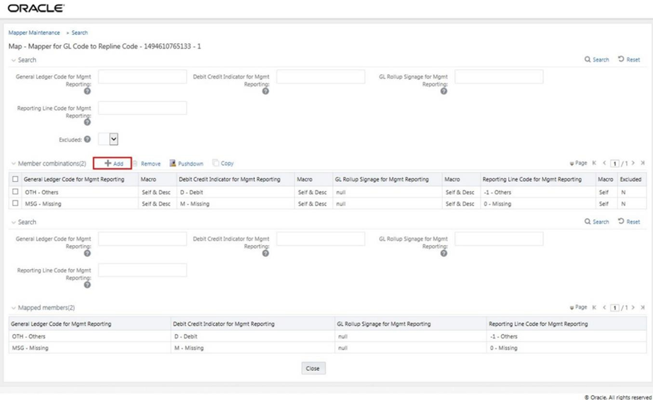

  1. In the Mapper Maintenance page, in the Member combinations section, click Add.
    Figure 29-4 Select Add in the Mapper Maintenance page for the One-to-One mapping at child hierarchy level
    This illustration shows selecting Add in the Mapper Maintenance page for the One-to-One mapping at child hierarchy level.

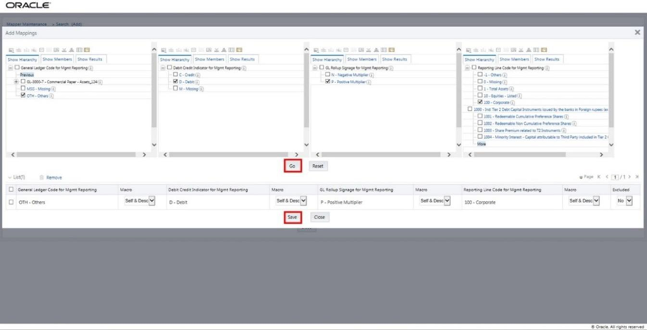

  2. The Add Mappings page is displayed. For illustration, select the member of the General Ledger Code for Mgmt Reporting hierarchy OTH - Others, and the member of the Debit Credit Indicator for Mgmt Reporting hierarchy D - Debit to map to the member of the Reporting Line Code for Mgmt Reporting hierarchy 100 - Corporate with the member of the GL Rollup Signage for Mgmt Reporting hierarchy P - Positive Multiplier.
    Figure 29-5 Add Mappings page for the One-to-One mapping at child hierarchy level
    This illustration shows the Add Mappings page for the One-to-One mapping at child hierarchy level. Select the required codes.
  3. To map the members, click Go. The list of mapped members appear at the bottom. To save the mappings, click Save.
    Figure 29-6 Map the members and save the mappings
    This illustration shows mapping the members and saving the mappings. Click Go to proceed with the mapping. Then click Save to save the mappings.

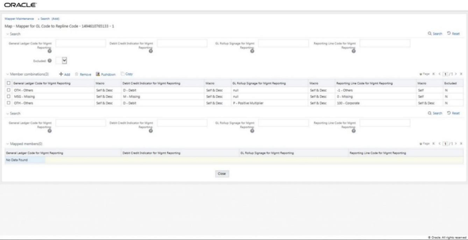

  5. The mapped member combinations are listed in the Mapper Maintenance page.
    Figure 29-7 Added mappings listed in the Mapper Maintenance page
    This illustration shows the added mappings listed in the Mapper Maintenance page.
