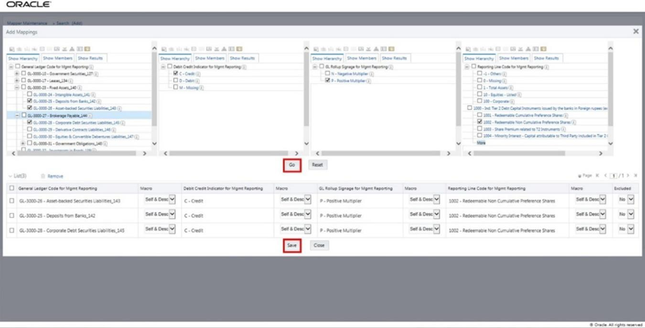

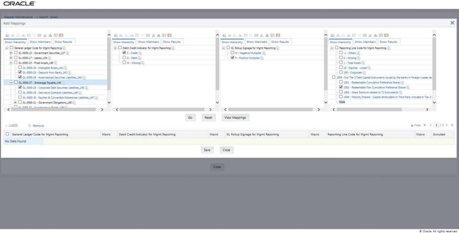

  2. The Add Mappings page is displayed. For illustration, select the child members of the General Ledger Code for Mgmt Reporting hierarchy, GL-3000-25 - Deposits from Banks_142, GL-3000-26 – Asset-backed Securities Liabilities_143 and GL-3000-28 - Corporate Debt Securities Liabilities_145, and the member of the Debit Credit Indicator for Mgmt Reporting hierarchy, C - Credit to map to the Reporting Line Code hierarchy member 1002 - Redeemable Non Cumulative Preference Shares with the GL Rollup Signage hierarchy member P - Positive Multiplier.
    Figure 29-8 Add Mappings page for the Many-to-One mapping at child hierarchy level
    This illustration shows the Add Mappings page for the Many-to-One mapping at child hierarchy level. Select the required codes.
  3. To map the members, click Go. The list of mapped members appear at the bottom. To save the mappings, click Save.
    Figure 29-9 Map the members and save the mappings
    This illustration shows mapping the members and saving the mappings. Click Go to proceed with the mapping. Then click Save to save the mappings.
