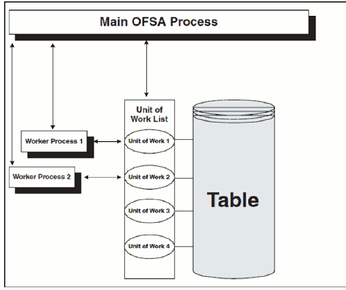

The specifics of each option are discussed. The following diagram illustrates the basic multiprocessing principles:
Figure G-11 Basic Multiprocessing principles
  1. The main process makes a list of all units of work that must beprocessed.
  2. The main process spawns worker subprocesses. Each worker subprocess is assigned a unitof work by the main process.
  3. When all units of work have been completed, the worker subprocess exits and the mainprocess finishes any clean-up aspects of processing.
  4. During processing the following istrue:
    • Each worker subprocess must form its databaseconnection.
    • A unit of work is processed only by a single workersubprocess.
    • Different units of work are processed at the same time by different workersubprocesses.
