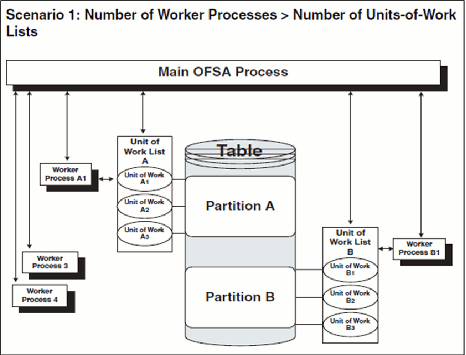

  • The main process makes two lists of all units of work that need to be processed, unit-of-work list A and unit-of-work list B, respectively. The assumption setup is that the Table has two partitions.
  • The main process spawns four worker processes. A dedicated worker process is assigned to ser- vice each units-of-work list, Worker Process A1, and Worker Process B1 respectively. (The setup is that the Number of Processes is4.)
    • If Partition Type is Cooperative, Worker Process 3 and Worker Process 4 assist Worker Process A1. When a unit-of-work list is complete, the available worker processes assistthe dedicated worker process on their unit-of-work list.
    • If Partition Type is Dedicated, Worker Process 3 and Worker Process 4 do not assistthe dedicated worker processes.
  • When all units of work are completed, the worker process exits and the main processfinishes any clean-up aspects of processing
  • During processing the following istrue:
    • Each worker process must form its database connection.
    • A unit of work is processed only by a single worker process.
    • Different units of work are processed at the same time by different worker processes

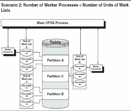

  • The main process takes three lists of all units of work that need to be processed: unit-of-work list A, unit-of-work list B, and unit-of-work list C, respectively. (The setup is that the Table has threepartitions.)
  • The main process spawns two worker processes. A dedicated worker process is assigned to ser- vice a units-of-work list, Worker Process A1, and Worker Process B1 respectively. (The setup is that the Number of Processes is 2.)
    • If Partition Type is Cooperative, Worker Process A1, and Worker Process B1 work untilall units of work are complete from all three unit-of-work lists.
    • If Partition Type is Dedicated, the first worker process to complete their unit-of-work list services unit-of-work list C. When the other worker process completes their list, theworker process exits.
  • When all units of work are completed, the worker process exits and the main processfinishes any clean-up aspects of processing.
    • Each worker process must form its databaseconnection.
    • A unit of work is processed only by a single workerprocess.
    • Different units of work are processed at the same time by different workerprocesses.
