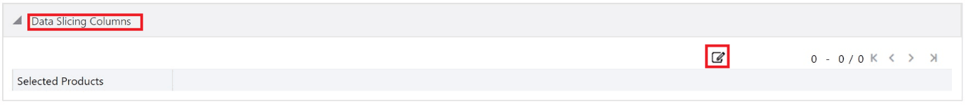

Data Slicing Columns
Choose the edit option to open the Data Slicing Columns window to select the slicing columns.
Figure G-8 Data Slicing Columns on Process Tuning Option Summary page

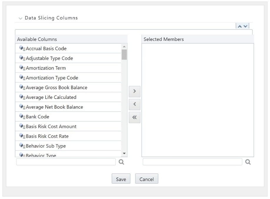

This window contains all numeric columns of portfolio table class. The columns with null values cannot be used for data slicing
Figure G-9 Data Slicing Column selection
