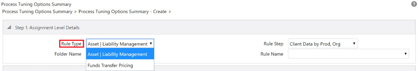

Rule Type
When specifying multiprocessing parameters at the Rule Type level, all Rule Names for that Rule Type are processed with the designated parameters.
Figure G-3 Rule Type drop-down on Process Tuning Option Summary page
The following table describes the valid Rule Type values present in the Rule Type drop-down list

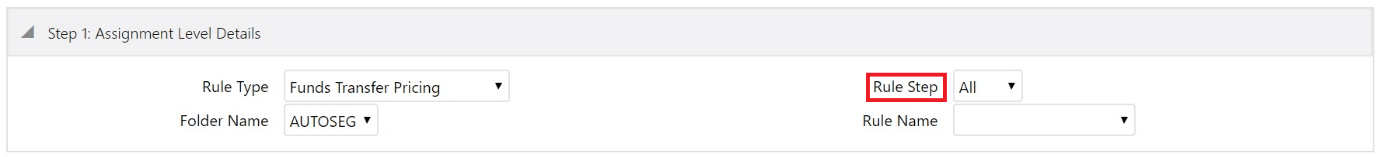

Rule Step
The Rule Step identifies a particular phase of an OFSAA process. They are reserved names specific to each Rule Type.
Figure G-4 Rule Step drop-down on Process Tuning Option Summary page
Rule Step is a drop-down list that is filtered based on its mapping to the selected Rule Type. The following table provides the valid combinations of Rule Type and Rule Step:
