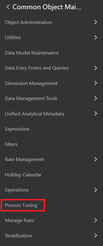

Access the multi-processing/tuning UI under the Common Object Maintenance on the LHS menu.
Figure G-1 Navigation to Process Tuning UI

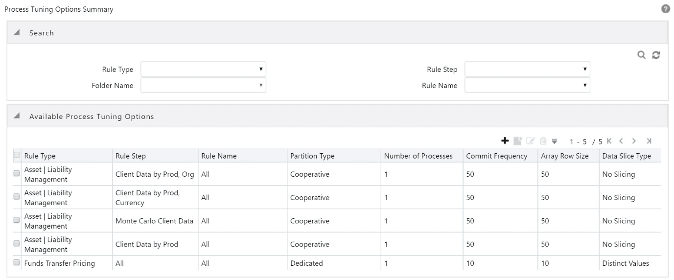

This opens the Process Tuning Options Summary window which is the gateway to perform all the required Process Tuning Options-related functionality.
Figure G-2 Process Tuning Options Summary page
