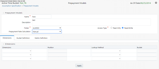

  1. Navigate to the Prepayment Model summary page.
  2. Complete standard steps for this procedure. For more information, see Creating Rules section.
    Figure 23-1 Prepayment Model
    Prepayment Model
  3. In case of ALM/FTP/BSP, select prepayment rate calculation which could either be manual, integrated or external model.
