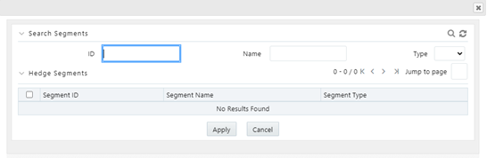

  1. Click the Add button from the Hedged Items grid to open the Hedge Segments window that appears with the list of existing Hedge Segments. Here you can search for segments using ID, Name, and/or Type.
    Figure 7-3 The Segments window
    The Segments window
  2. Select the checkbox adjacent to the Segment ID of the Hedge Segment you want to select and click the Apply button.
    The selected segments are displayed with the details such as Segment ID, Segment Name, and Segment Type.
