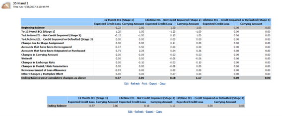

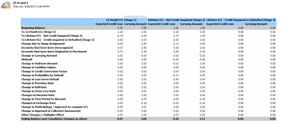

35 H and 35 I
In addition to the preceding report, the reconciliation feature also caters to the quantitative disclosure requirements of the 35 H and 35 I report as per IFRS 7, but with more details or granularity.
The report shows the roll forward of Expected Credit Loss and Carrying amount values, from the beginning period balance, through the various parameters or values affecting the ECL and carrying amounts to the ending balances of the current period. The report is designed in a manner that allows you to view it in either a simple format or a detailed one. The reporting lines are created with hierarchies that allow you to expand a reporting line to view the subsections, in a rolldown or rollup format. The rolldown format shows the roll forwards for every factor affecting the ECL or carrying amount, while the rollup view clubs many of these factors under major headers such as Model or Risk Parameters, Remeasurement, and so on.

Figure 13-4 The detailed view of the 35 H and I Reports
Figure 13-5 The simple view of the 35 H and I Reports
