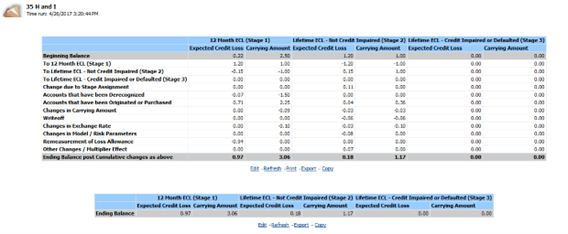

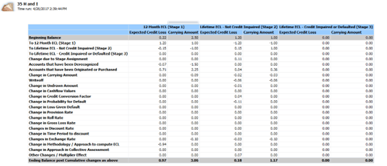

The following is a screenshot of the 35 H and 35 I report with sample data (for representational purposes only).
Figure 13-4 The detailed view of the 35 H and I Reports
The report shows the roll forward of Expected Credit Loss and Carrying amount values, from the beginning period balance, through the various parameters or values affecting the ECL and carrying amounts to the ending balances of the current period. The report is designed in a manner that allows you to view it in either a simple format or a detailed one.
Figure 13-5 The simple view of the 35 H and I Reports
