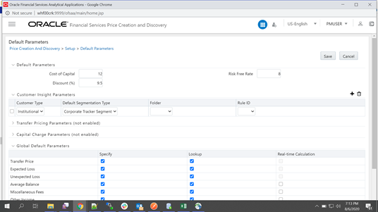

    Figure B-31 Defualt Parameters when FTP is not enabled
    Defualt Parameters when FTP is not enabled.

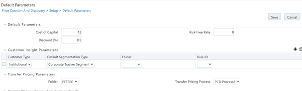

    Figure B-32 Defualt Parameters when FTP is enabled
    Defualt Parameters when FTP is enabled.

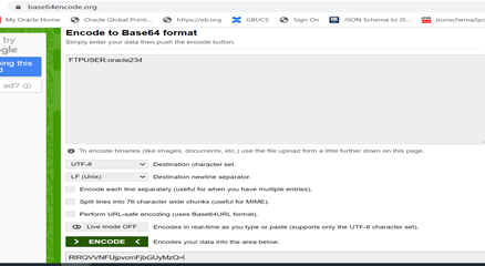

    • In the API_DYNAMIC_HEADERS table, set the headers_values with FTP login username and base64 encoded password.
      Base 64 encoded password should be generated for username:password. To get the base64 encoded password go to following link.
      https://www.base64encode.org/
      Example: If username is FTPUSER and password is oracle234:
      Username:password: FTPUSER:oracle234
      Encoded password: RlRQVVNFUjpvcmFjbGUyMzQ=
      Figure B-33 Encode to Base64 Format

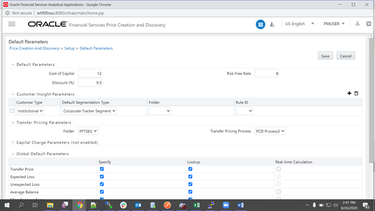

  4. Login to PCD Application: Navigate to Default Parameters and select the Standard Process under Transfer Pricing parameters section.
    Figure B-34 Default Parameters
    Default Parameters
