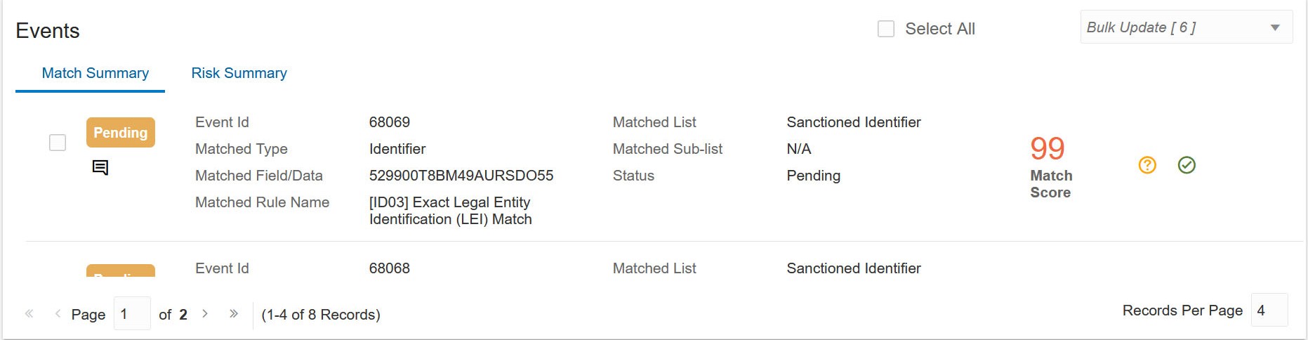

3.5.2.7 Events
This section displays the list of in the Event Summary and Risk Assessment tabs. By default, the number of event records displayed per page in the event table is 5.
You can click the Expand button to expand the event page and view the event records (Records Per Page) simultaneously. Click on the Collapse button to collapse the event record. You can save the preference by clicking the Save Preference (Save Preference) icon and click the Clear Preference (Clear Preference) icon for the default view.
Match Summary
This section lists all the matches, if any, for a message. You can review all matches in this section before blocking/releasing a message.
The Event Summary tab contains the following components:
  • Event ID
  • Matched Type
  • Matched Field /Data
  • Matched Rule Name
  • Matched List
  • Matched Sub-list
  • Status
  • Match Score
  • Edit Comments Icon
You can use the search filter in the top middle of the page to filter the in the alert with the Match Score criteria. Follow these steps to filter the:
  • Enter the Match Score value in the Search Filter.
  • From the Filter menu, select the Match Score.
Click on the Select All check box to select all the event records for the bulk update. Select All option is configurable. To enable and disable Select All option, see Configuring the Application Level Parameters and Configuring Select All Option for the Table section in OFS Transaction Filtering Administration Guide.
To Customize the number records displayed per page in the event table, enter the number in the Records Per Page entry box. The value must be between 4 and 100.
Click the Sort Sort icon to sort the search criteria in ascending and descending order.
  • The Senior Supervisor can change Assignee of the Alert.
  • You cannot change the status of an Alert.

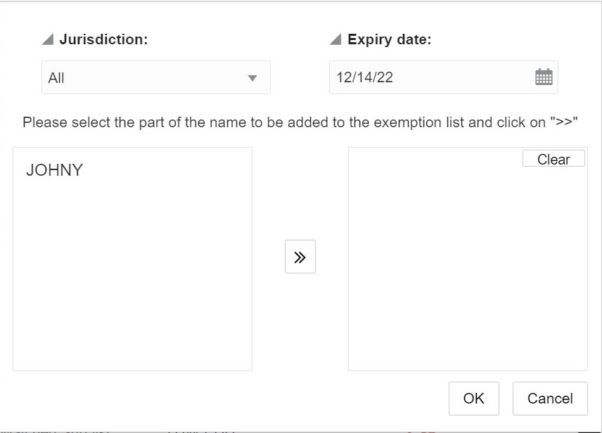

Good Guy Matching
The Event Summary section can add a record to the FCC_WHITELIST table using the Add to Good Guy button. This button is initially green, and the color changes to gray after the record is added to the watch list table.
After you receive the record, click Add to Good Guy Add to Good Guy to open a pop-up window.
Figure 3-22 Good Guy Pop-up Window
For Narrative matched type, only for individual and entity matches, the good guy button will be enabled. From the good guy window we can select jurisdiction and expiry date. Select the full/partial text from the left panel and click on the ">>" button to request the selection to be added to the exemption list.
Select the Jurisdiction and Expiry date for the record. Select the part of name to be added to exemption list and click on button and click OK. The record status or alert changes from Assigned (A) to Pending approval (P).
You can click on clear button to clear the selected name.
For Narrative web service Good Guy Matching type is contains.
For Name and address web service Good Guy matching type is exact.
For example: If the data of the current Event is equal to the Good Guy data, it comes under the exact scenario. If the data of the current Event contains the Good Guy data, it comes under the contains scenario.
The user can change the parameter by changing the value in the column of V_MATCHING_TYPE in dim_swift_webservice table.
The user has to select the data (exact or partial of the word) which is shown as the value under Matched data in the Event details section.
After you click OK, the message is sent to the Supervisor for review. An orange tick appears next to the Clean status, and the Add to Good Guy button remains green, as shown in the above image.

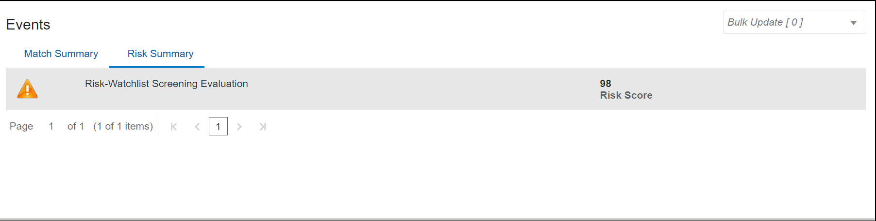

Risk Summary
To view the Risk Assessment section, select the Risk Summary tab. This section lists all the risk rules and associated risk scores for a message. Click on a risk rule to view the corresponding risk details. See the Configuring Rules in the IPE chapter in the OFS Transaction Filtering Administration Guide for information on the risk rules.
The following image displays an example.
You can use the search filter in the top middle of the page to filter the Event Summary and Risk Assessment lists. Enter the search term in the search box to filter the list. Select the criterion as Match Score/Risk Score. Click the Sort By Sort By to filter the data in ascending and descending order.
