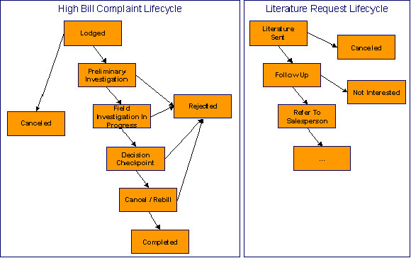

The lifecycle of cases is not governed by the base package. Rather, you define the lifecycle of your cases when you set up their case types. Examine the following diagrams; the one on the left shows the potential lifecycle of a case that manages a high-bill complaint, the one on the right shows the potential lifecycle of a case that manages a customer's literature request.
Figure 1. Potential Lifecycles Of Two Types Of Cases
The figure illustrates how you can define statuses in the lifecycle of two different types of cases like High Bill Compliant and Literature Request.
Just examples. The above lifecycles are just examples. When you set up your case types, you must define the valid states for your case type.
