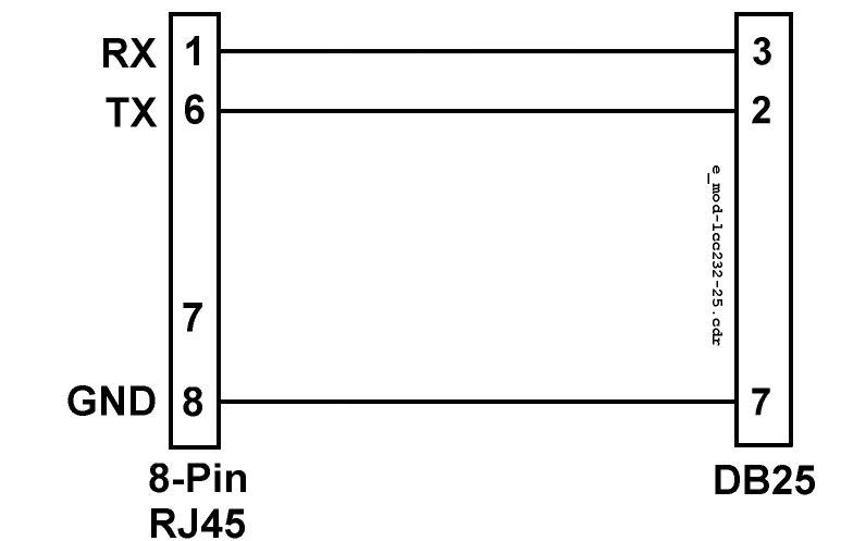

The figure below shows a diagram of a similar cable that terminates with a DB25 Male connector in place of the DB9.
Figure 34-3 Modular LCC/RS232 to DB25 Connector

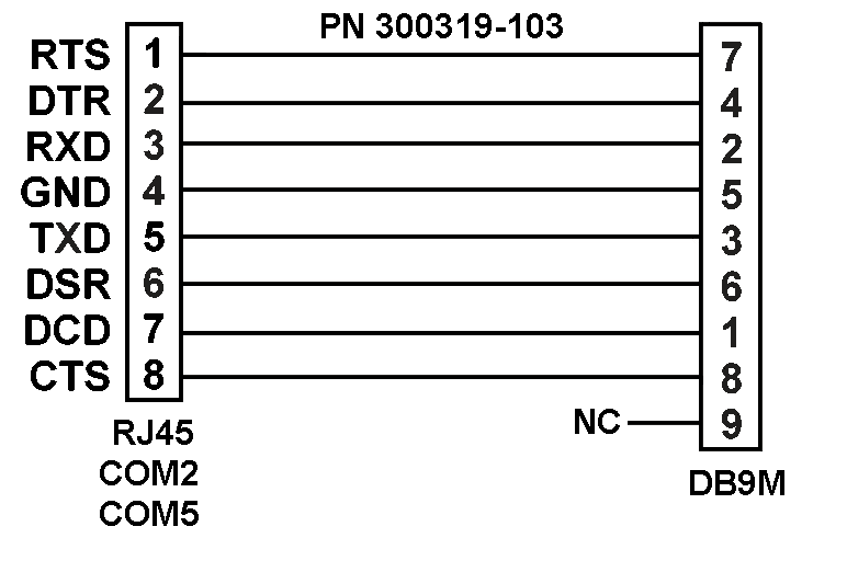

The figure below shows a diagram of cable PN 300319-103-PT. This cable converts a modular COM 2 or COM 5 port to a DB9 Male connector.
Figure 34-4 Modular RS232 Port to DB9 Male Connector

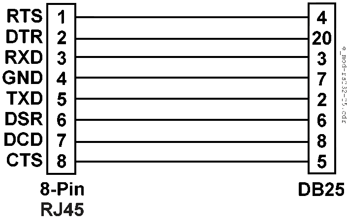

The figure below shows a diagram of a similar cable that terminates in a DB25 Male connector.
Figure 34-5 Modular RS232 Port to DB25 Male Connector
