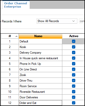

      Figure 14-1 Examples of Order Channel Names
      This figure shows the Order Channel module with a sample list of Order Channel names.
