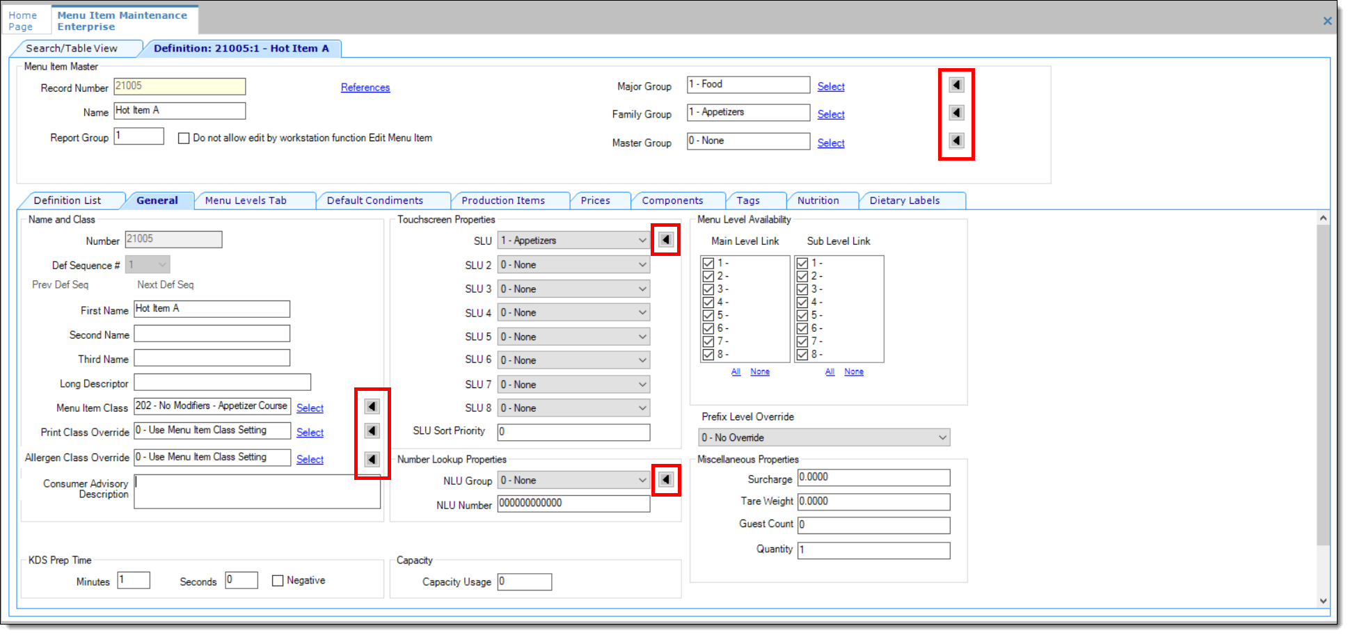

Navigate to related records
While configuring Simphony (in either table or form view), certain files have a Go To Previous navigational icon. This icon This figure shows the Go To Previous navigational icon. links to the location in the current file (or a different file) where the selected information is stored. You may want to use this icon to change an entry, add an entry, or view its configured characteristics.
For example, you are adding a group of menu items and you do not see the Screen Lookup (SLU) group you want to assign them to.
  1. Click the This figure shows the Go To Previous navigational icon. icon next to the SLU field. The Menu Item file opens, which is located in the SLU Names section of the Descriptors tab.
  2. From here you can view the existing groups or add new a SLU group name. Click Save if you make changes.
  3. Navigate back to the Menu Item Definition file, and then select the new (or different) SLU group for the menu item from the SLU drop-down list.
Figure 3-2 EMC Go To Previous Navigational Icons
This figure shows examples of Go To Previous icons.
